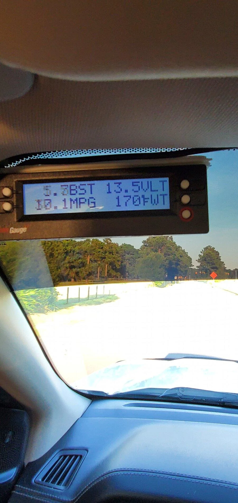

I use the Scan gauge II. It measures the water temperature, Boost, MPG and battery voltage, and a host of other real-time gauges.
