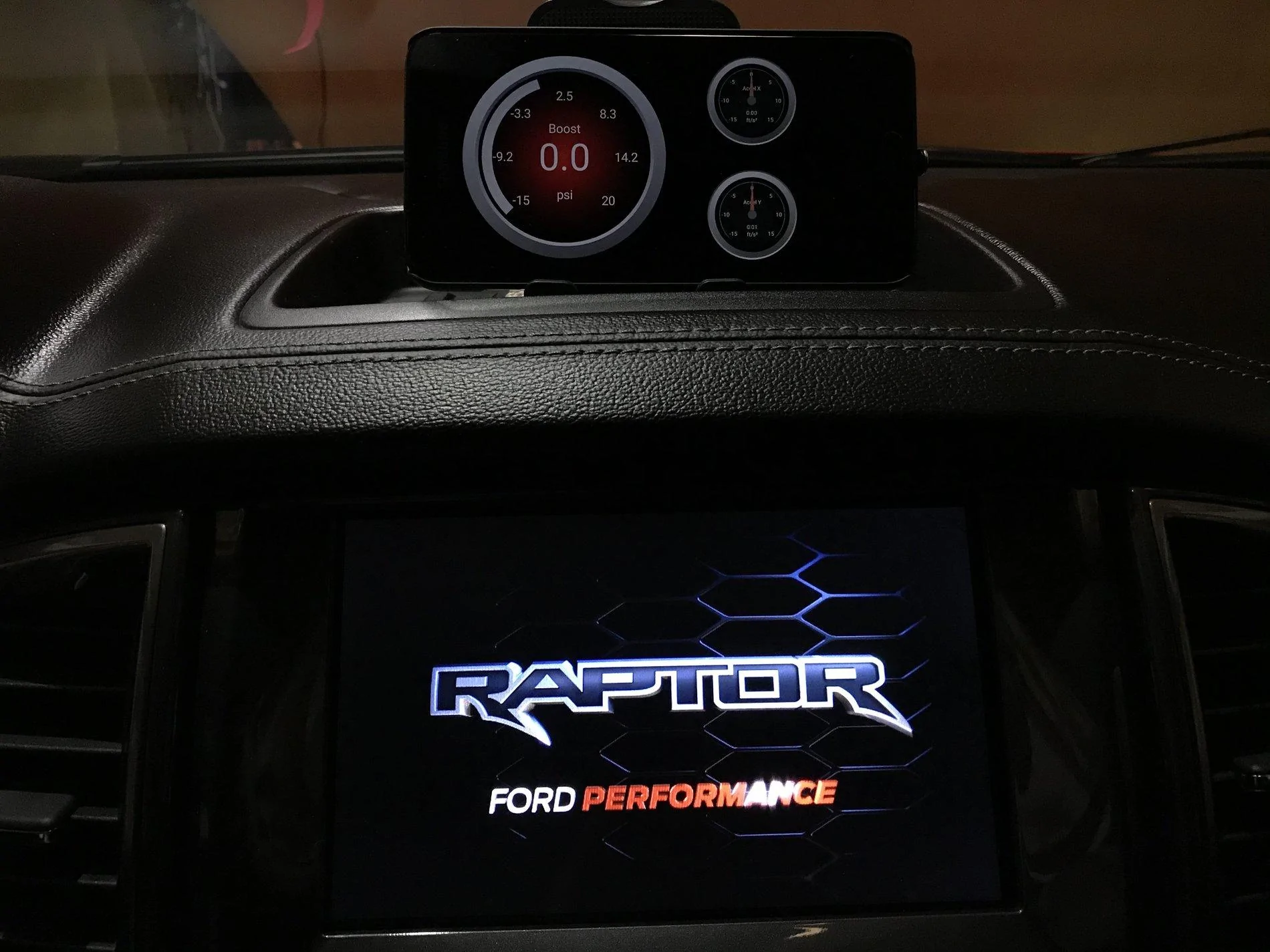

okay so I have been nosing about trying to figure out what we can do for gauges...I was wanting to mod my 4.2" center productivity screen in the insturment cluster but no joy.
BUT I think I was looking at the wrong spot! It appears, at least for android users, you can Looks like a bluetooth adapter, Torque Pro app, OBD2AA to activate and port it to your headunit and you can have a dash cluster each time you load up android auto.
Now I need to do this...I might strike out and look around for a bluetooth OBD adapter. Amazon is showing 3-7 days shipping avg.
More to follow...
MEH...figured I'd just order an OBD - MX from amazon. I should have it next week.

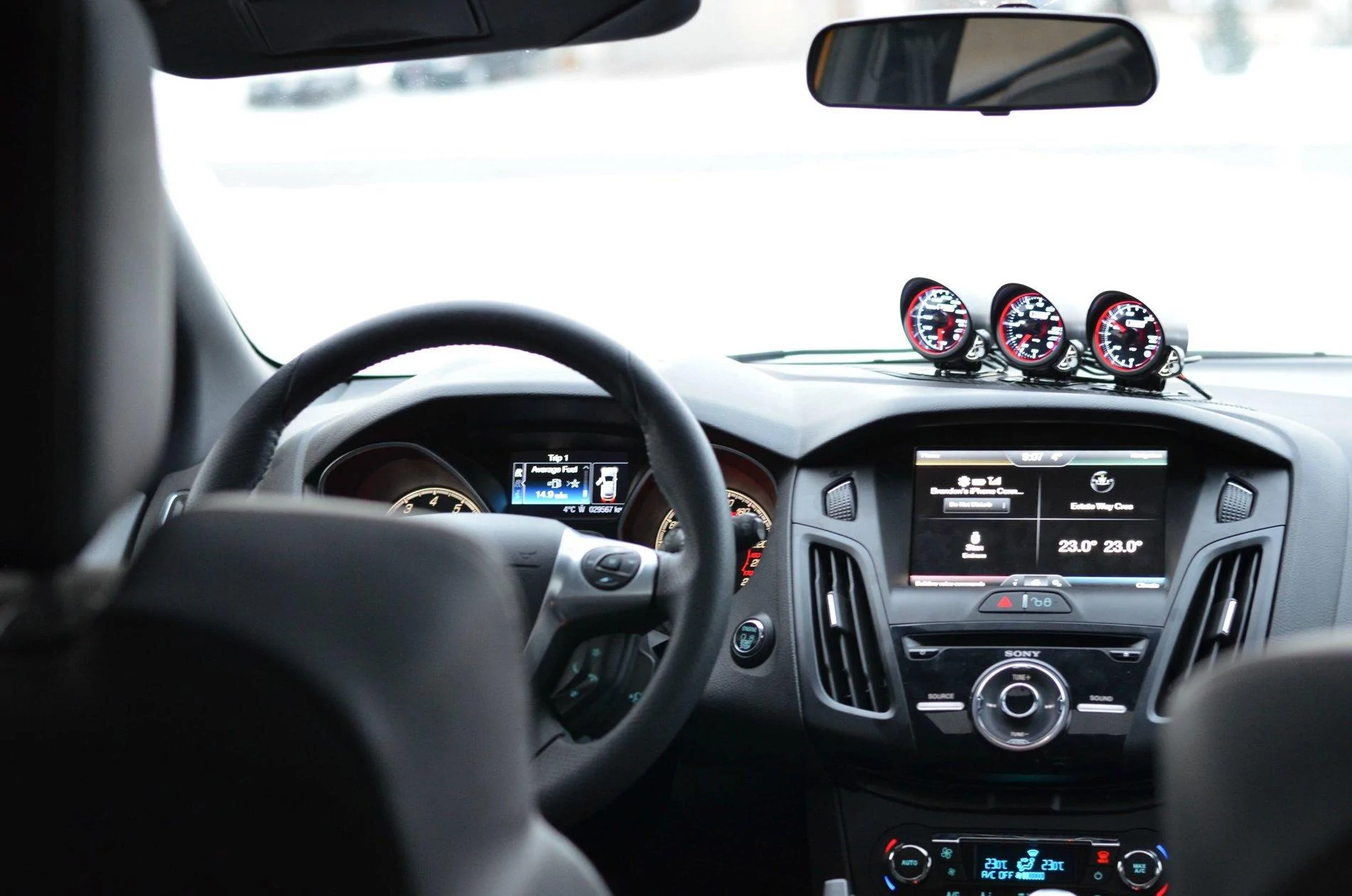

Interesting idea! My hopes of using Focus ST/RS gauges are most likely not going to happen as I cannot find anyone that supply me with the information on how to find the wiring diagrams that would allow me to pinpoint on how to extract the info. I have tried this forum, my Focus ST/RS forum and tuners for information and exhausted Google searches. The info is out there if I could find access to the the schematics

I have not. I will check that out. My thinking is that if the 2014/2018 St and RS use an analog gauge with converted digital info, the Ranger should have the same capabilities. I would have to think that the systems are very similar. I have the pigtail as well. I'm going to be heart broken if I cannot make this happen

I do something very similar in my Evora. I use a combination of a GoPoint Bluetooth adapter, Dash Command on Android and a Pioneer 8200NEX head unit. The OBD2/phone passes the info to the head unit wirelessly. I am then able to use the touch screen on the Pioneer to work the app via touch as if was on the phone itself. I know you are looking at doing this with the stock Sync system. Not sure if the stock system would offer that kind of capability. Would be very cool if it did so watching this thread closely if you figure it out! :)

It does not snap in the dash, but the cargo tray on the dash is where I plan on installing mine. I'm building a cover that will highly resemble the one used in the Focus ST and RS. Fortunately, I happen to have an ST to use as the model. For me, that's the easy part. Finding the information for the correct wiring to tap into to hook up to the guages is what's holding up the project

I run a boost gauge on my phone. Works perfect.
How does this work ? Is it an app ? Bluetooth ? Please elaborate :):thumbsup:
