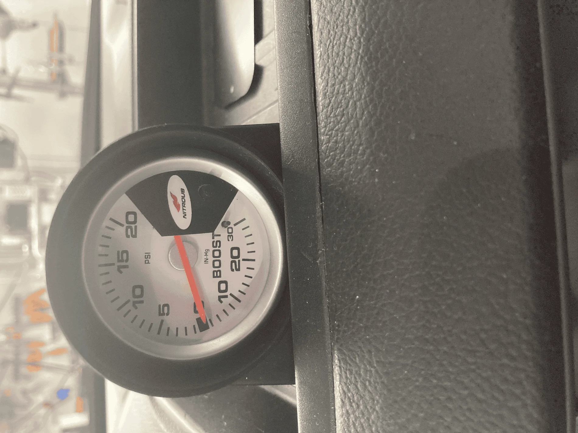

For those who want to know, the after-market, Ford Mustang boost gauge kit works perfectly. I described that on a different post. The photo shows where I mounted the gauge. By the way, I had it lighted when I first installed it, but discovered it is a distraction when driving at night.
Why the photo got twisted, I have no idea.

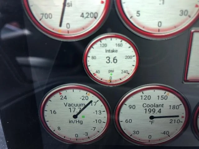

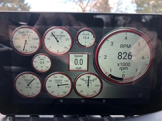

This is a quick picture of my setup. I installed the tablet with a very strong, adjustable magnetic mount in the dash tray. I have yet to drill a hole and run the power behind the dash. I'm just using one of the 12v outlets w/usb. So this picture is obviously at idle. Notice the max boost red tag on the boost/vacuum gauge is a 24 psi.....that was an 80% +/- throttle drop at lunch today. This guy in a Chevy HHR was harassing me....lol ;) Didn't really take much to move on by him, but I wanted to get the boost up to see where I'm at. I really haven't paid much attention to that. More the Trans and Coolant Temp when I'm out playing with the local college kids....:rockon:
BTW...I have a "Tuned by Livernois Motorsports" sticker on my back window. That tends to get me a little attention. Usually folks that think I'm funny/ridiculous....lol. Till the hammer drops! I realize our tuned and modded Rangers are not the fastest thing on the street....but.....I can open some eyes very quickly and easily get the drop on a bunch of different vehicles with the low end torque of that Livernois tune...Out through the first 3 gears....and that 3rd gear rear end bump that is just so much fun!!!
I'm curious to do a full throttle hit to see how much boost she can push through that little turbo we have.....she's a beast!

Interesting to see the vacuum reading. The average altitude here in Roswell, NM is 3,500. Once the engine is warmed up and at idle, the vacuum is right at 20 in/hg. Ig gets a bit lower once it warms up and the air is on. In my experience, this is higher than any turbo vehicle I've owned. Could be because the truck only has 4,500 miles on the OD.
