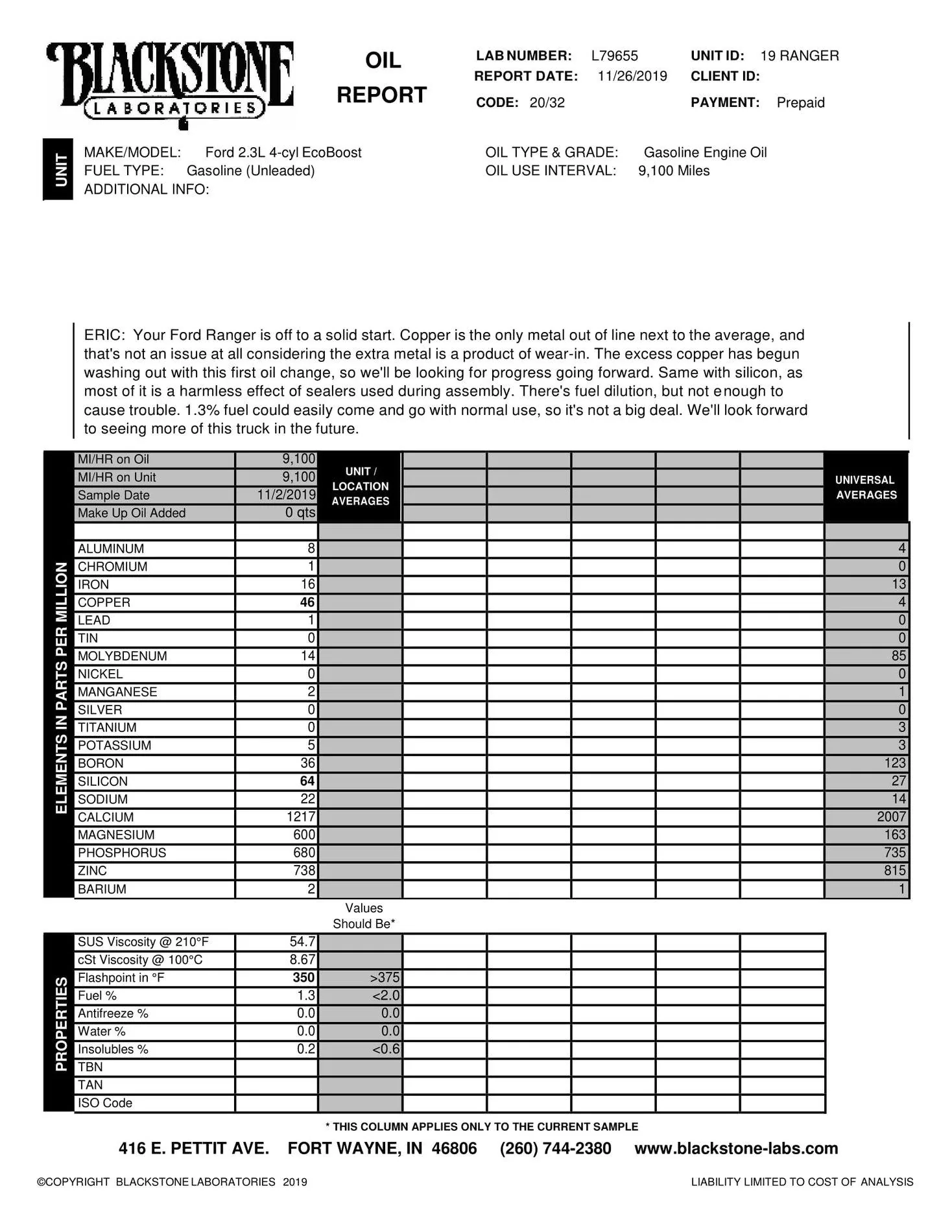

Changed my oil a little sooner than the factory recommended interval under normal driving conditions. Went to M1 full synthetic for it's second oil fill. Will go 10k miles on this oil. Looking forward to what the next 7 months will bring.

The scary fuel dilution isn't bad. :thumbsup:
I'm going with full synthetic also on my first change.

That's a factory fill first change right?
I got Blackstone reports on my Jeep every change because I love the data and the science. I don't put enough miles on to have a report all that often. I am holding out to what the manual says and will run factory fill for a full interval.
