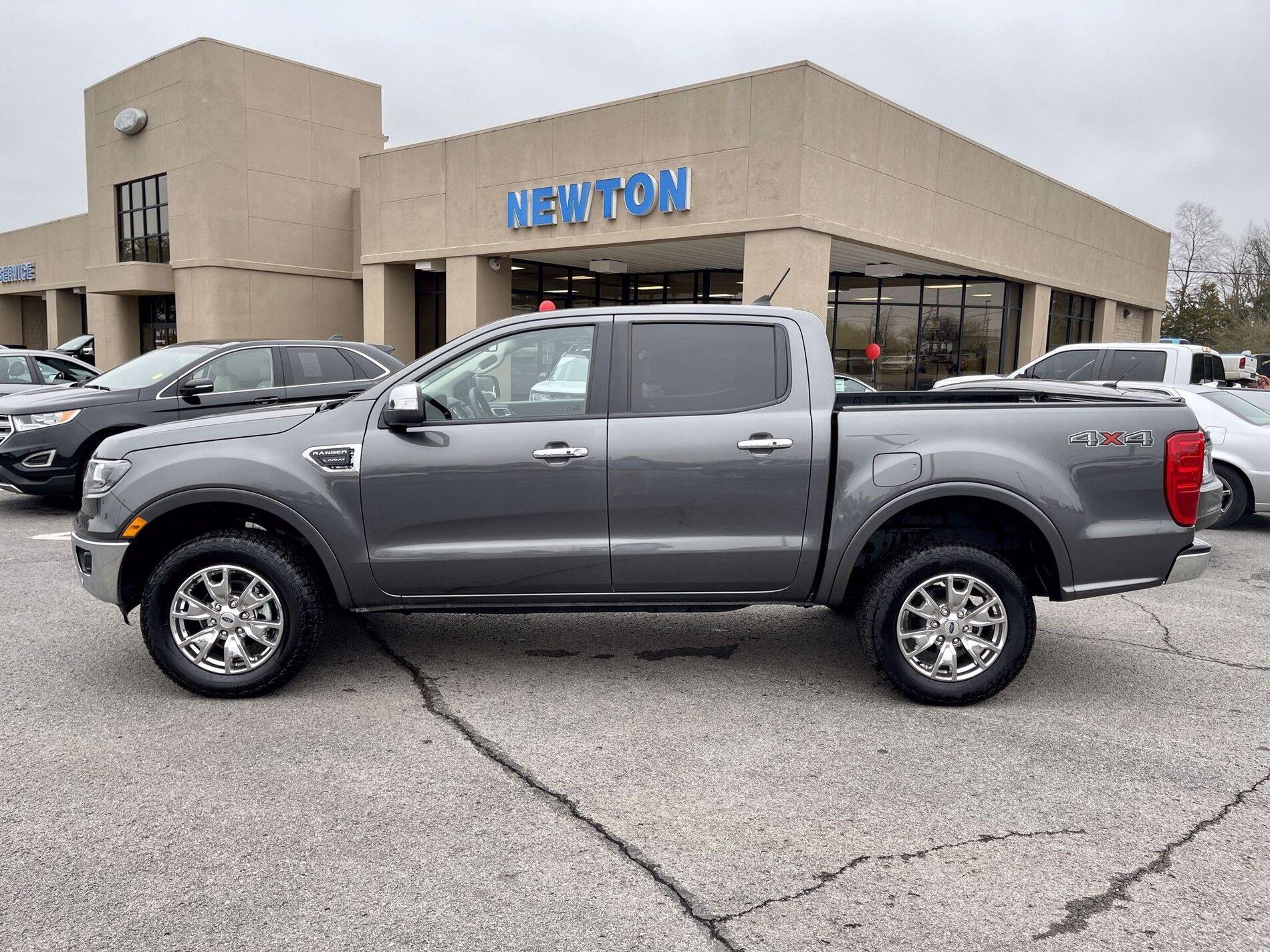

Has anyone put bigger tires on the factory chrome Lariat 18” wheels? Post pictures.
For reference:
