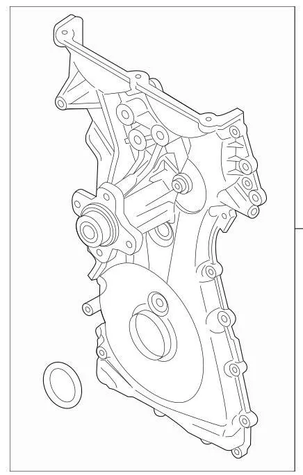

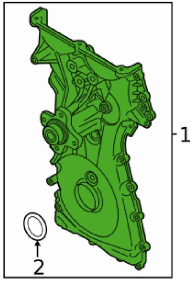

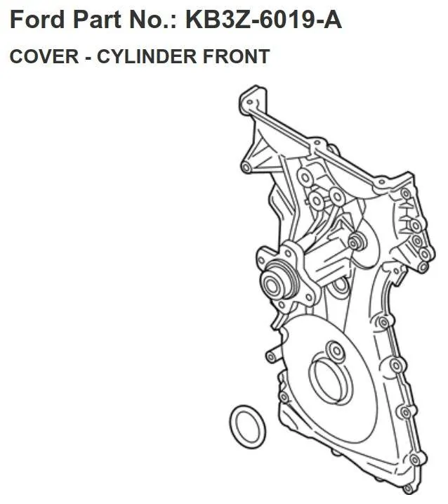

OK, I've searched and found 3 images. -A, -B, -C. I'll post them below, but a cursory look shows no obvious differences. Maybe the catalogs have not been updated.
Version B
Version C

Hi Steve,
There have been 2 revisions of the front cover. All engines can use the latest number KB3Z-6019-C though.
2019 - KB3Z-6019-A
2020+ - KB3Z-6019-B
Both now supersede to KB3Z-6019-C
Please let me know if you have any other questions.
Thanks,
-Benny
Thanks Benny. Is the cover exclusive to the Ranger or is it also used on the Broncos and Explorers with the 2.3L? If there’s any way to tell

The obvious next question is what has changed? Can you provide pictures of the 3 versions?
Sorry we do not have engineering data to see what may have changed nor are there any product photos listed from Ford for any of these versions.
- Benny
