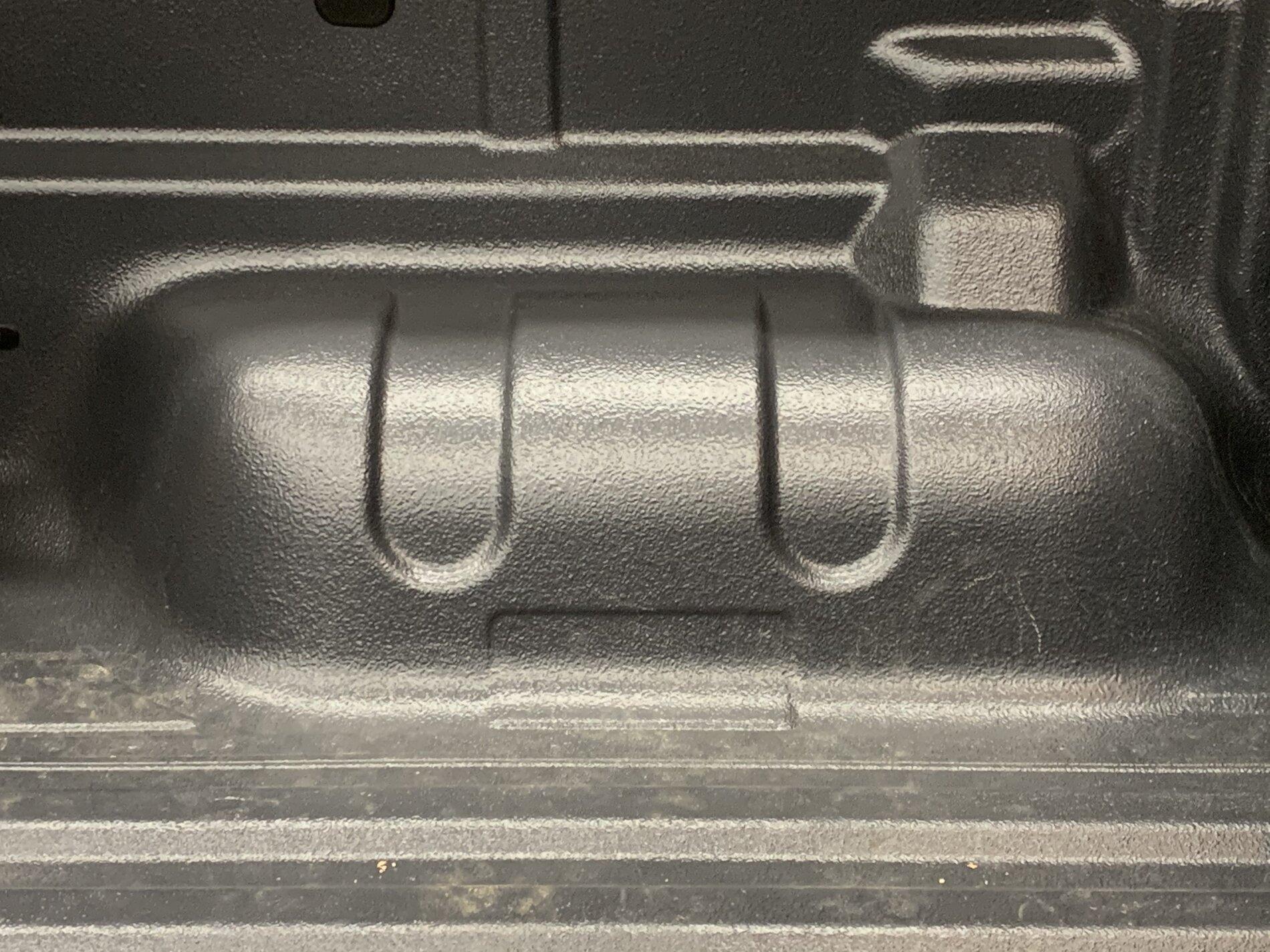

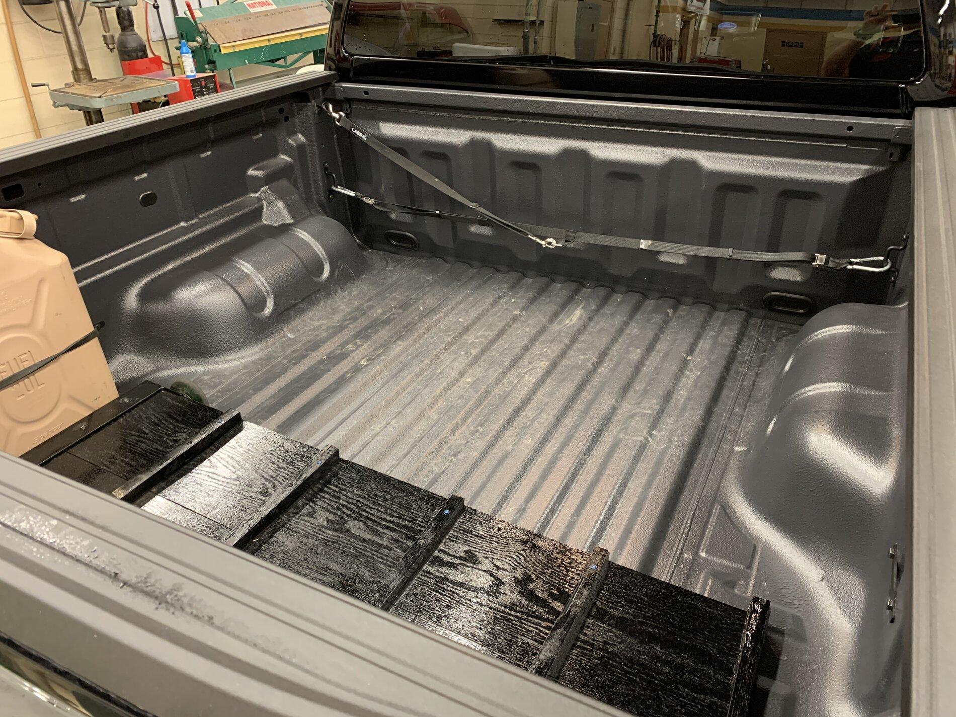

This is tint-able Raptor Liner. Mixed up some Magnetic color so it matches the trim on my truck. Very happy w it. 90 pound dog stammers around back here. The scratches are superficial and you can wipe them off.

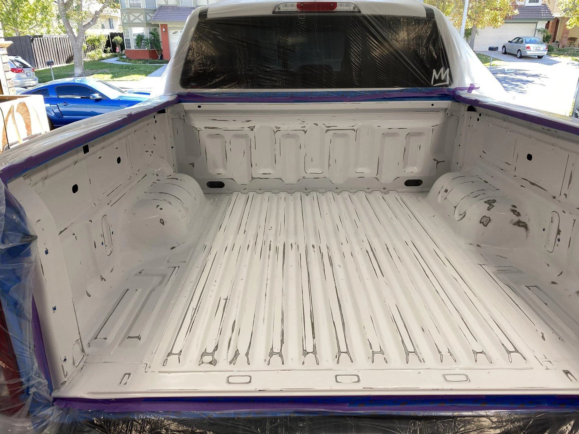

For anyone doing Raptor DIY. DO NOT be afraid to sand the shit out of that bed with 80 grit. I mean get in those nooks and cranny's real good. This stuff likes something to bite to. It can "lift" if you leave a shinny area.

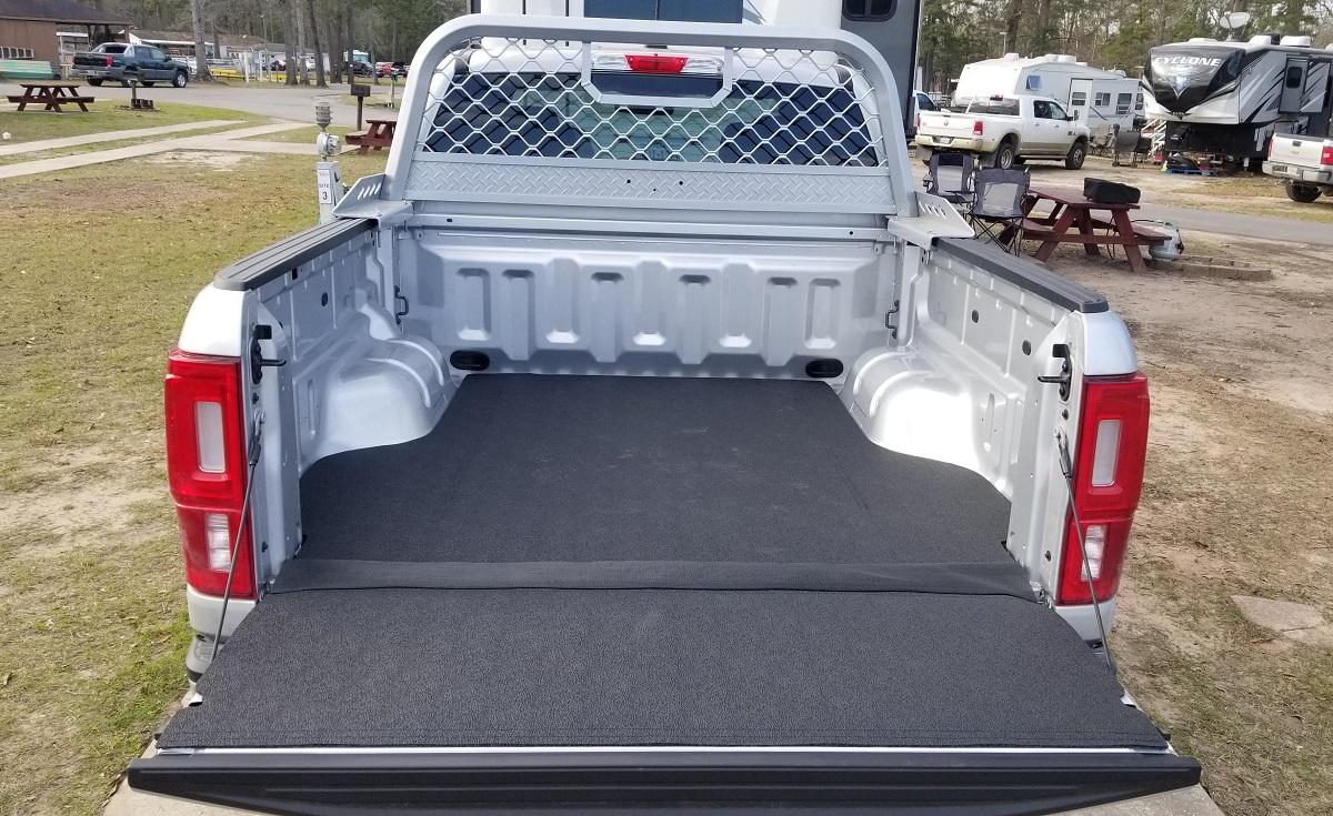

Can I get some info on this headache rack?
It's the DeeZee and I'll link it below. It's nice being able to load the motorcycle and kayaks without worry about bashing in the back window. (And, it's very close in color to my Ingot Silver!)
