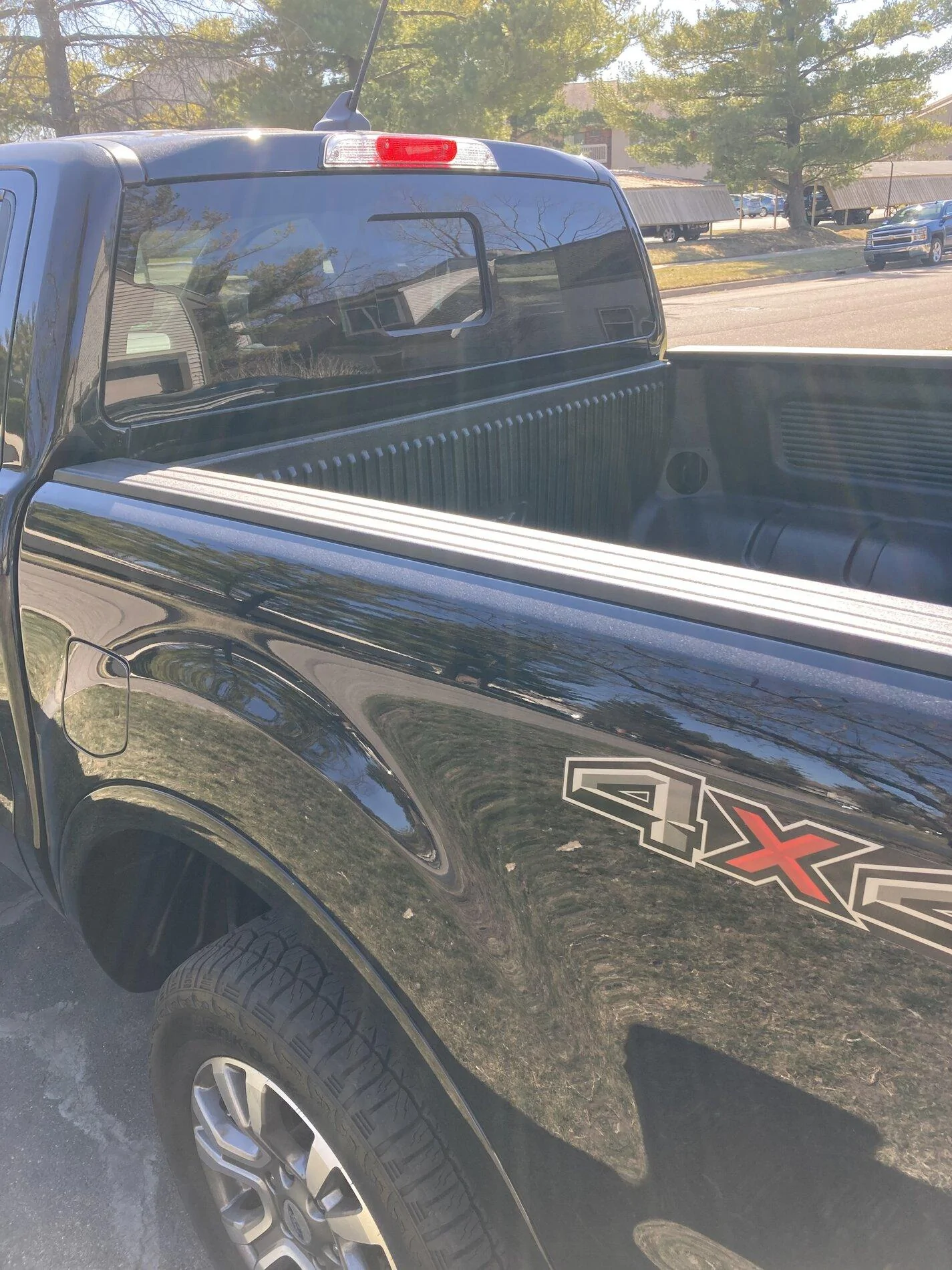

Do these pry off ? I don’t see any screws or anything else that is holding them in place ...
I want to eventually add a tonneau cover and not sure how the cover would “seat” properly on the rails with these on
Or am I wrong ?

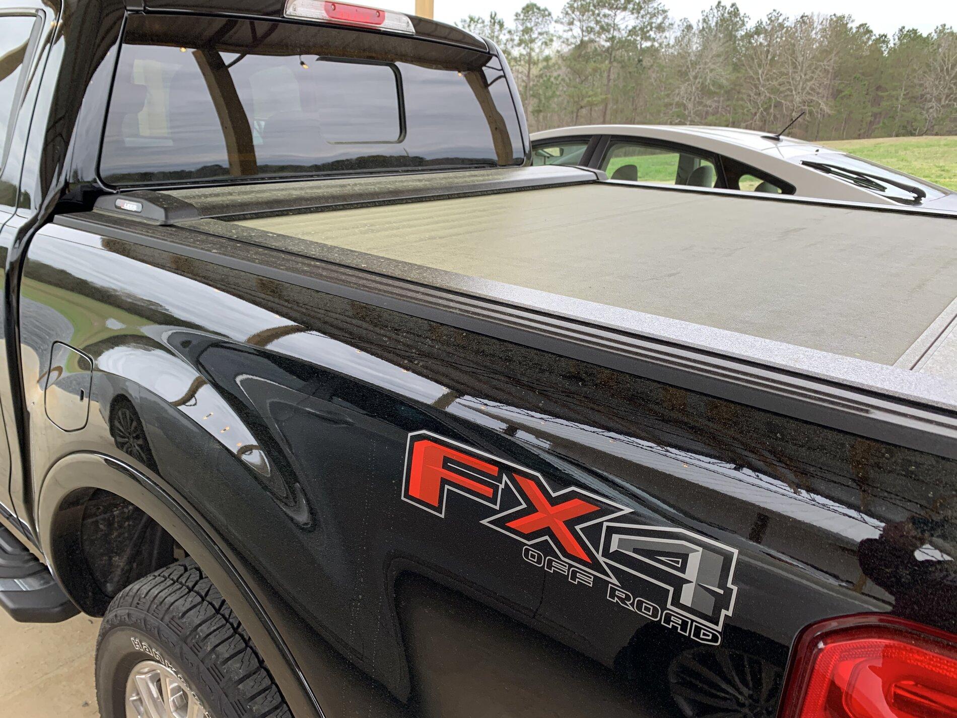

+1 to what Phil said. Not my truck, but here’s an example...credit goes to @24dRanger

My Gator tonneau cover fit with no issues on top of the rail caps. In fact I used the molded in lines on the caps to center my cover.
