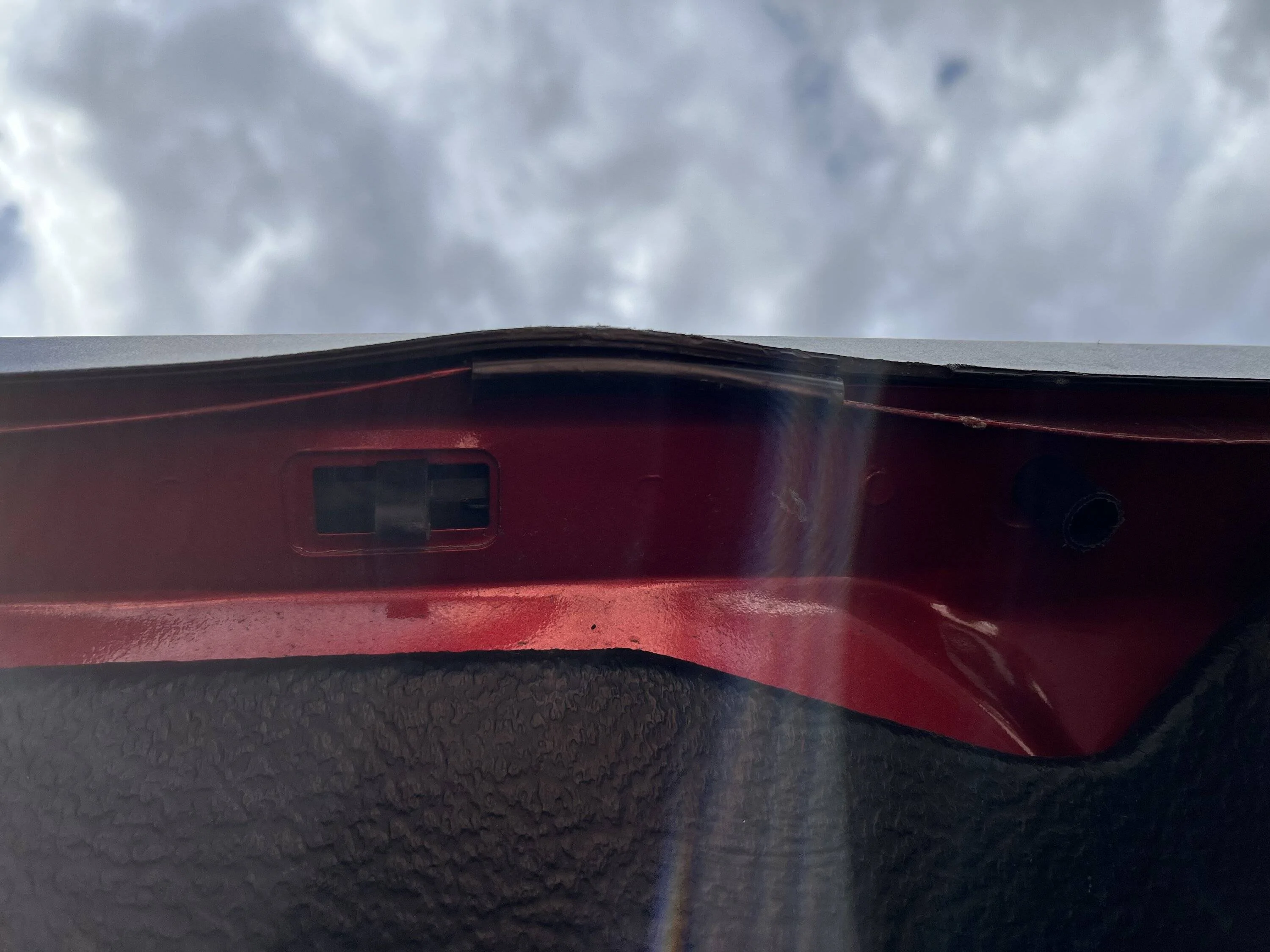

You say that, but I had the wind get under my tonneau cover and can-opener the bed rails. The aluminum is very thin.
7,084
37,222
Not on a Ranger as the bed is steel, not aluminum.

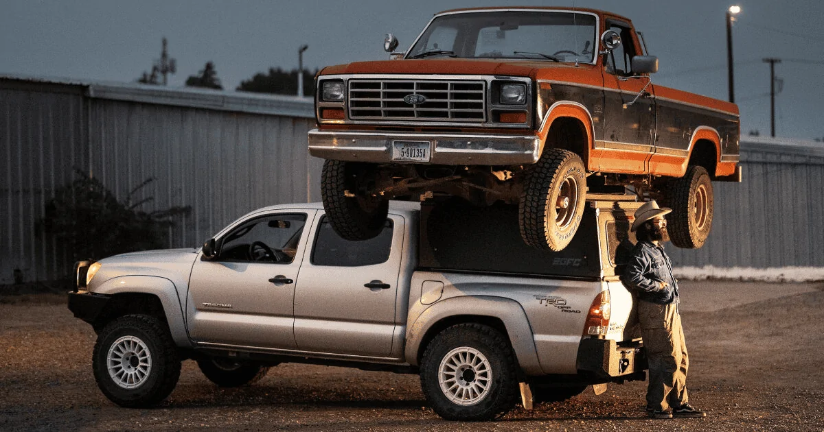

Also depends on how the load is braced, distributed and supported. I've put 5,000 lbs on top of a bed cap on a Taco and driven around, thanks to an appropriate structure. I've also seen bed rails beer canned by a fraction of that.
4,566
23,251
Our design flaw of the insane bed rake factors in too - cantilevers the weight toward the cab. *BS alert*
Too bad the Ranger's not as good as the Taco (massive eye roll).
Maybe the Ford's humpin' the Taco?

The amount of bracing we had to weld into the Taco's bed to hold that load weighed almost as much as that F250. But yeah, that Topper is bone stock, and is still used by one of the guys.
