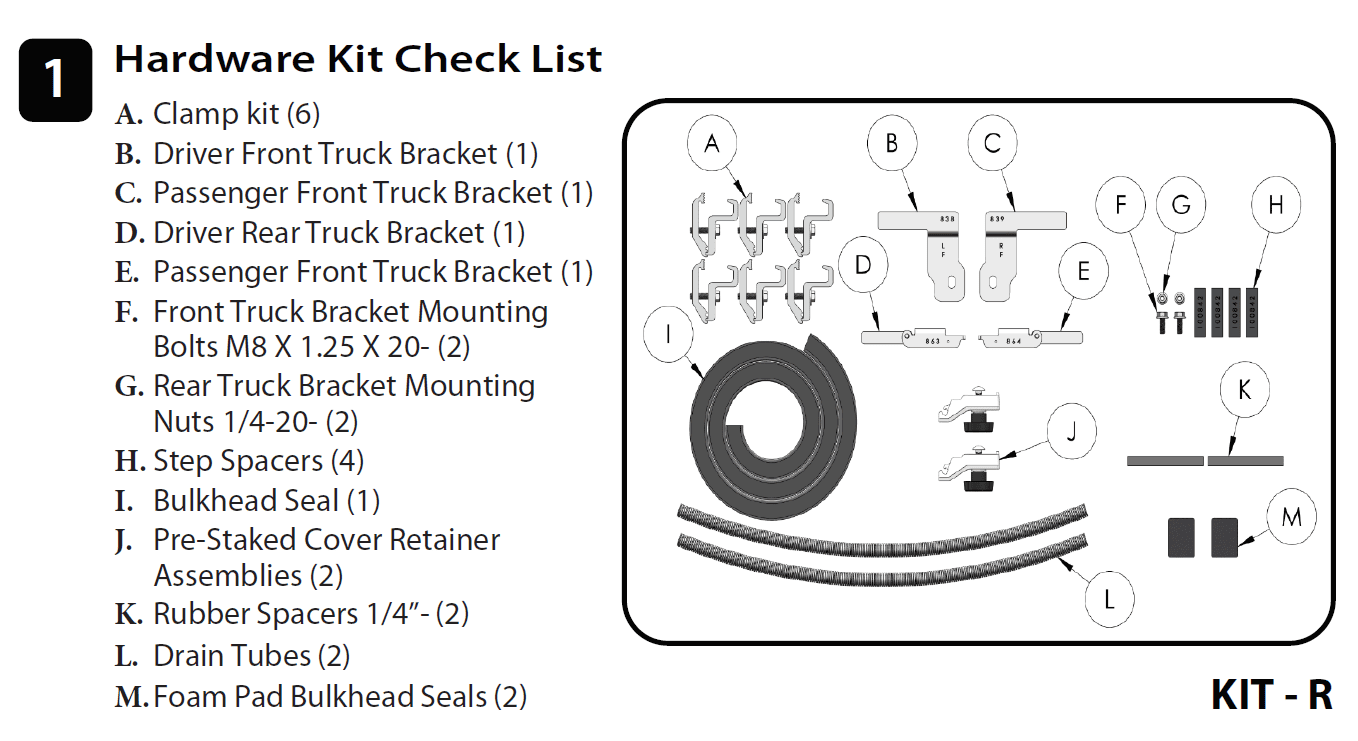

That was my understanding - everything below except A, J and L is what I am guessing.
And yes the taller rubber seal repalces the bulkhead bar. Makes sense as the bar was not sealed.

What are the Step Spacers for ?

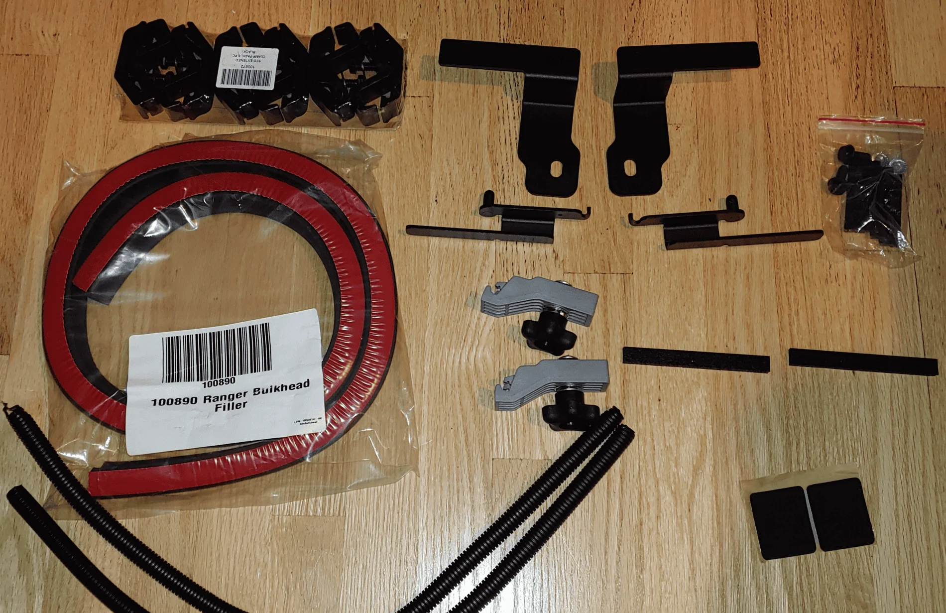

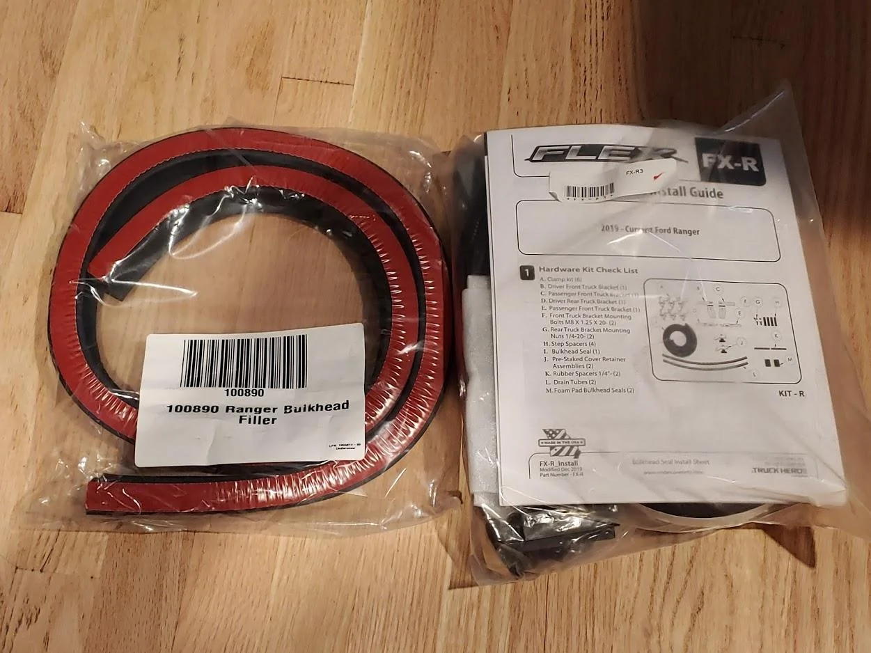

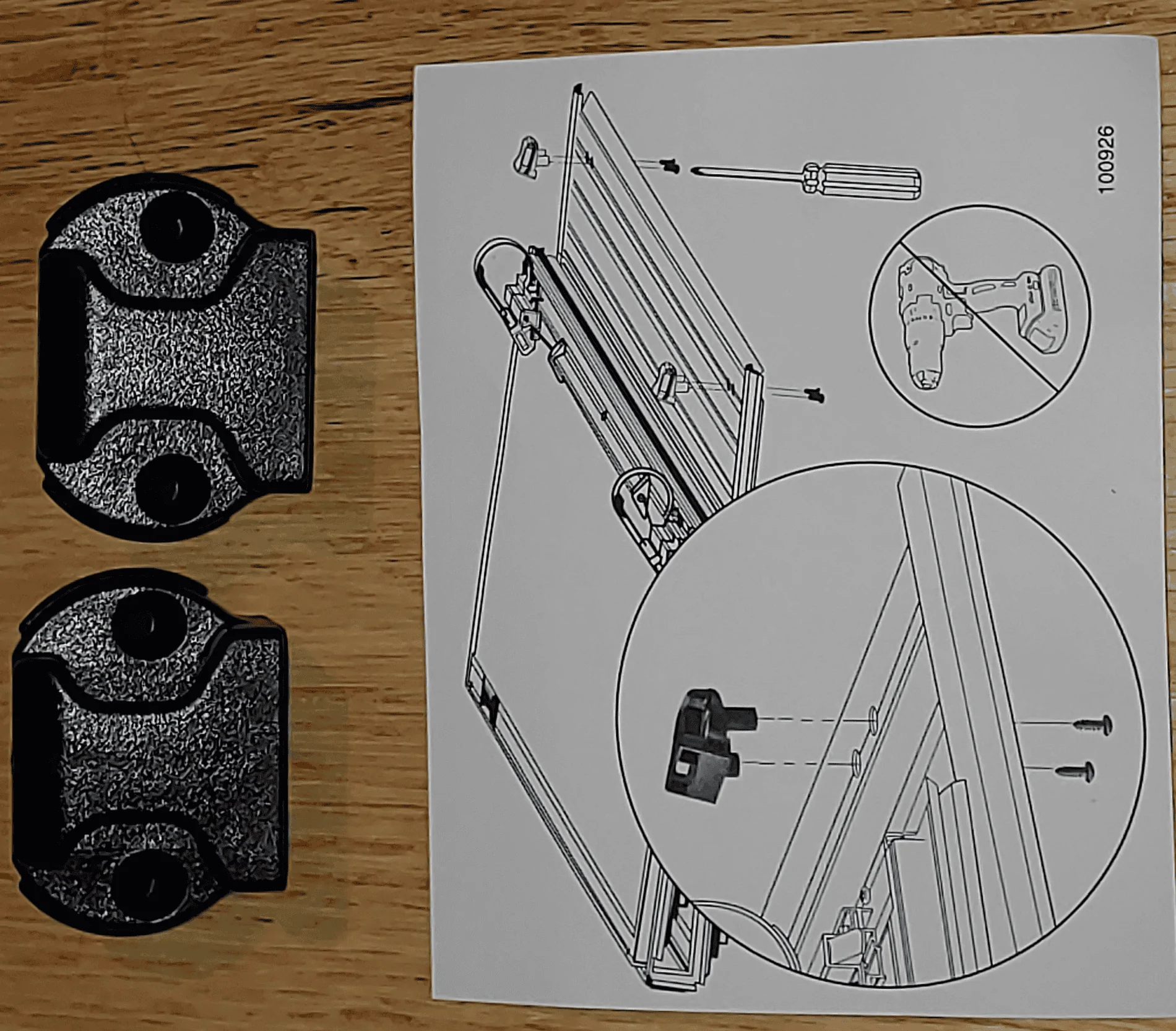

Got the kit this morning. Undercover is an awesome company to deal with. The kit included everything shown in the description I posted earlier PLUS new external clips used to hold the cover flat, more on that later.
The new front seal is MUCH taller and is an extruded seal, so much harder and more duarable.
All the parts - like the new black clamps :thumbsup:

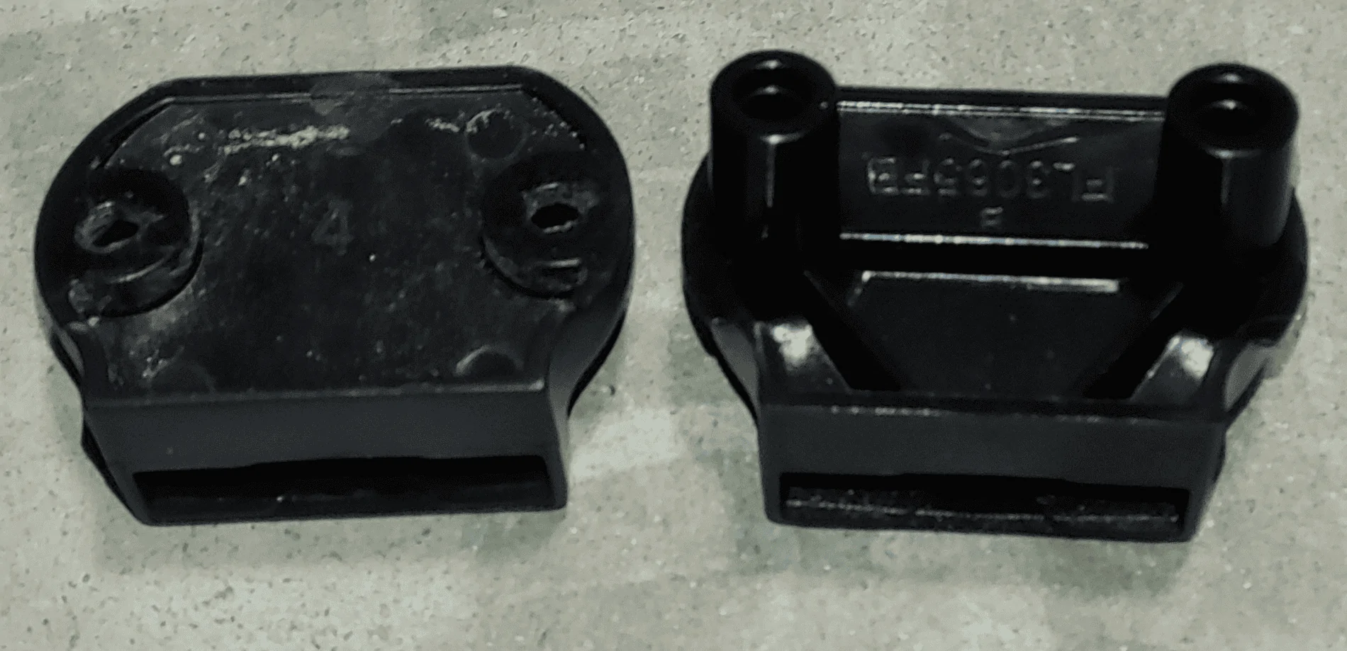

Now the bonus parts. New clips that install much more robustly.

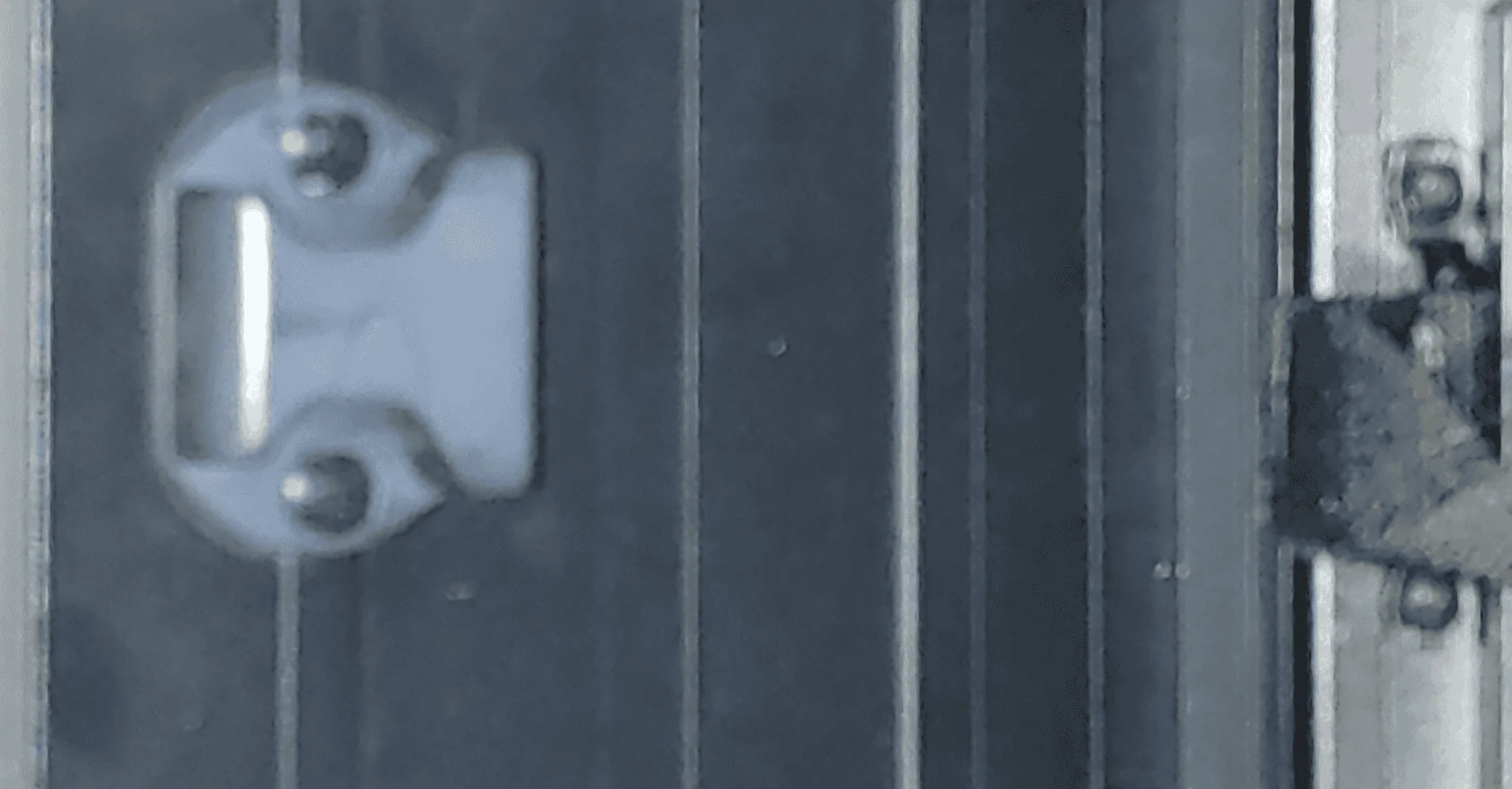

The old ones just have a screw that goes in from the top (sorry about the focus, but if you are reading this you likely already have one and know what it looks like!)
The new one (RH below) adds a boss that stick into the cover and will take a MUCH higher shear load. The screw now going in from that back side will also dramatically increase the pull out force. All in all a very good design improvement. You will need to drill some holes to install this and the directions are not that clear about that, but pretty straight forwad. Drill a screw sized thru hole thru both sides of the cover using exting threaded hole as a guide. Then from the top side drill a boss sized hole just thru the top surface, if you blow thru both you will need a washer for the screws supplied. They dont supply washers, so I assume the correct way is just thru the top side.

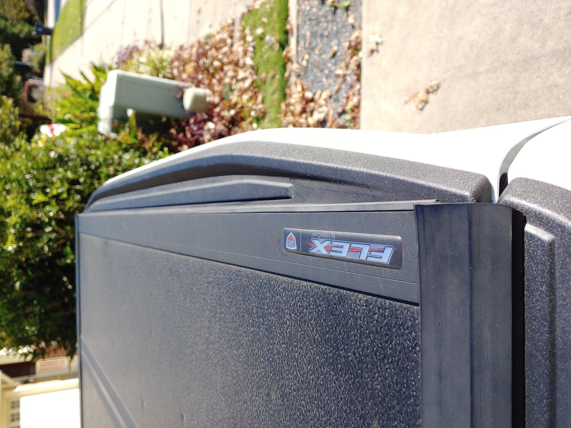

Install is done - very easy. Had to clean out the holes and threads of bed liner with a file and tap, but to be expected. New clip is definitely more robust.
Anyone with an undercover - can you comment on how far back it sits? How much of the tailgate is covered?
Here is what mine looks like
You can see the hail damage which got me a $100 cover. ?
Trying to come up with ways to cover that, thin diamond plate, heavy gauge textured auto wrap.

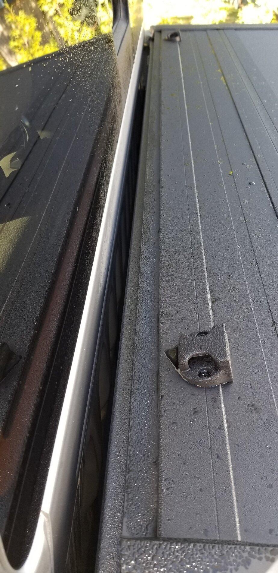

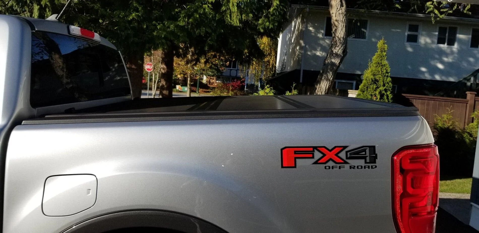

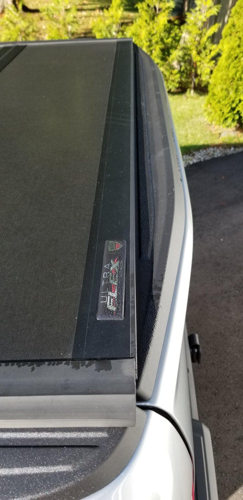

Hi Mike,
Here are a few pics of my install. I have the metal bracket bulkhead version.

Thanks James
Mine is positioned a tad forward as the flap at the bulkhead is pretty much covering all of it and your is about 1/2 coverig. Probably have room to pull back a little more as I am more worried about leaking at the tailgate than the bulkhead. Although with the gaps around the tailgate probably doesn't matter!
Thanks for posting - I like the finish on the Ultra more than what comes on the std Flex.

Cheers Mike, I wanted the carpet on the underside and also got sucked in by the "light included". Although, I'm not sure how the Ultra finish would look after your hail storm tho!:surprised: :LOL:
