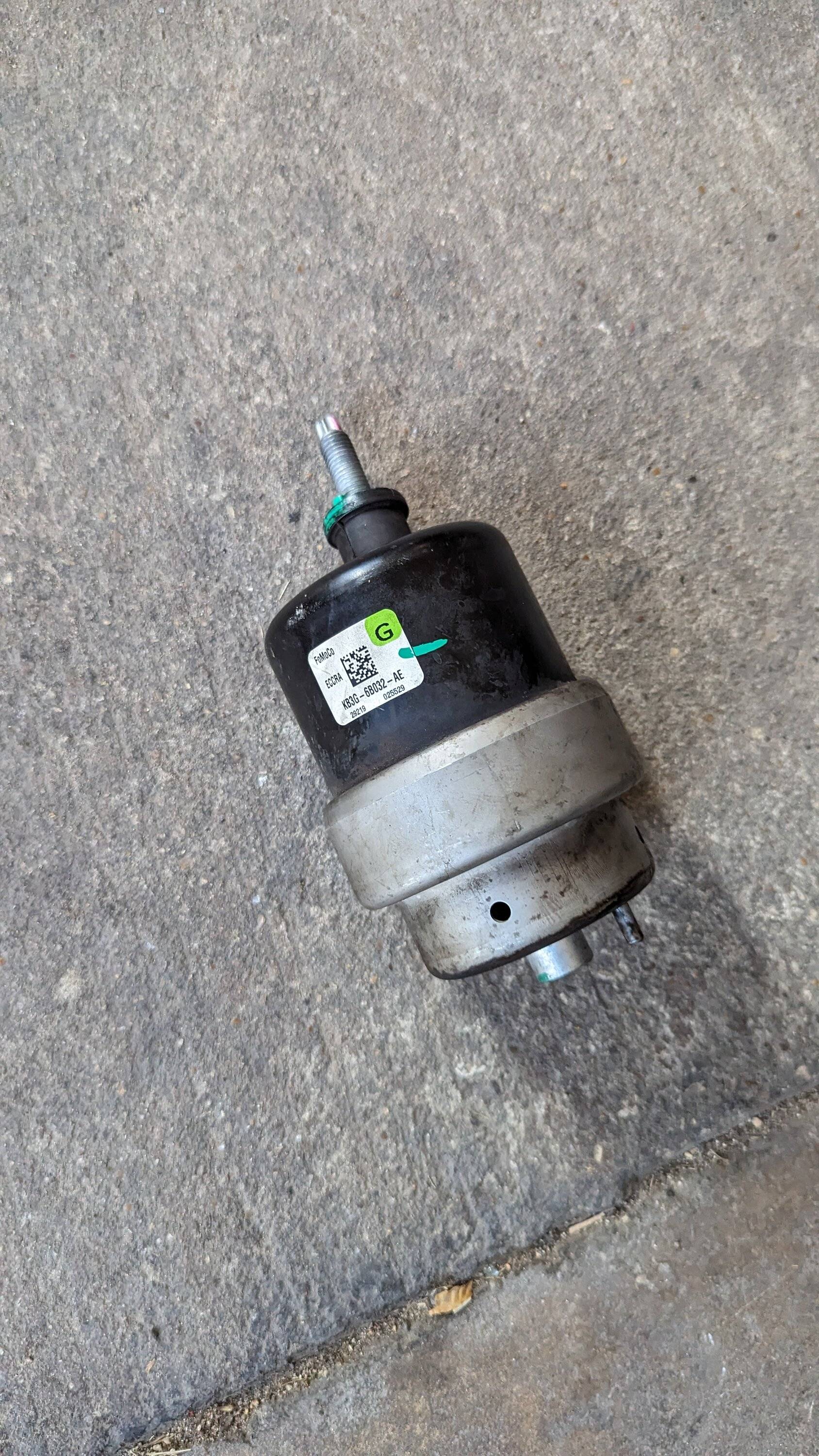

Motor Mount finally arrived. I'm scheduled for Tuesday to replace the mount.
I'd put polyurethane mounts if they were available but I haven't found any.
I just bought a new Kia Rio to drive to work and I went over one speed bump without slowing down and it was a loud bang lol. I slow down for everything in that car now. It was a big wake up to how much stress my motor mounts experience in the Ranger. All suspension rubber bushings have been replaced with delrin or polyurethane, except for the shackles, so the motor mounts are distributed more of that loa. I didn't slow down for anything in the road such as potholes, speed bumps, curbs, and now I see why it failed under the loads I gave it, which were outside of what they were designed to do.

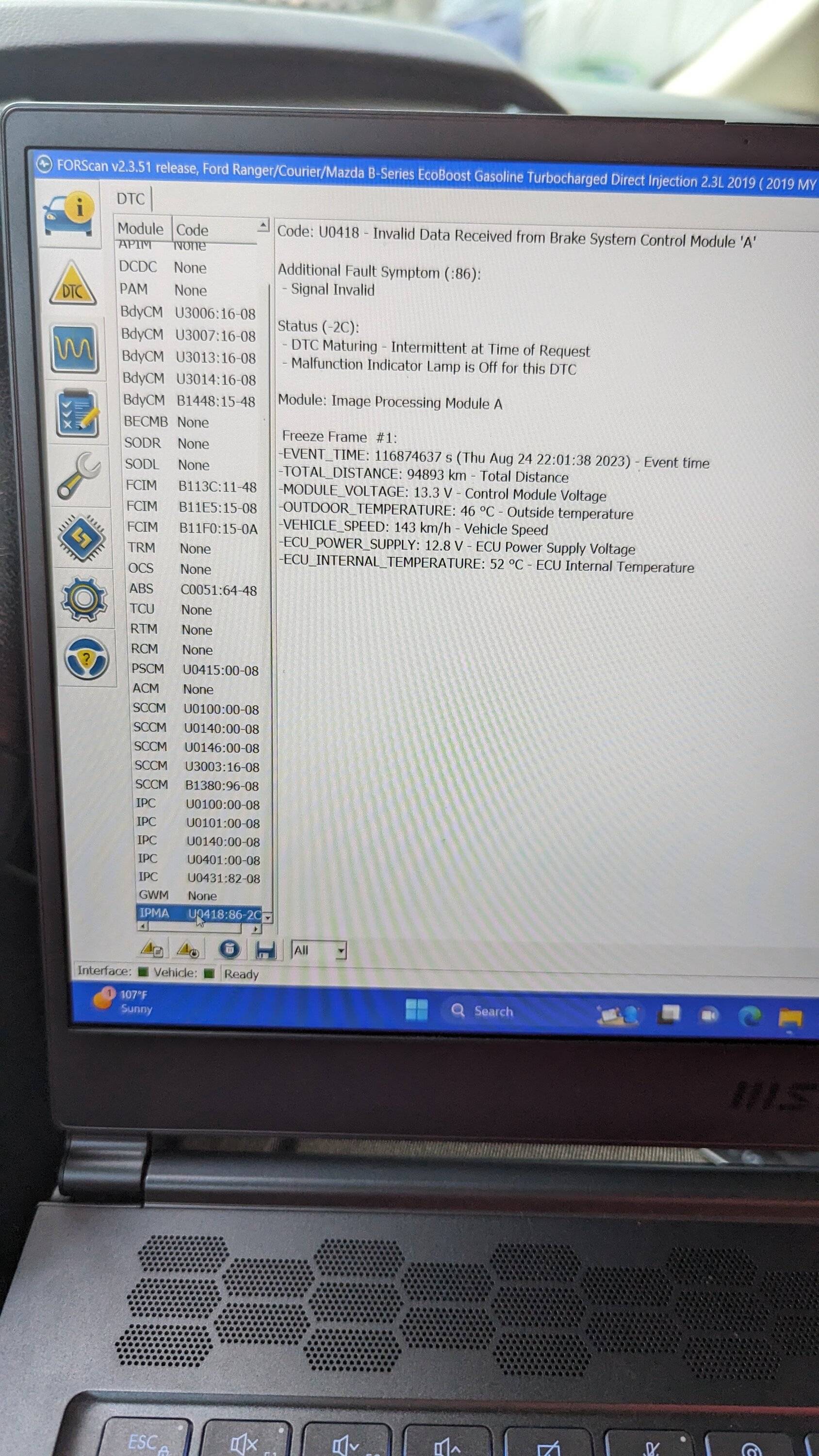

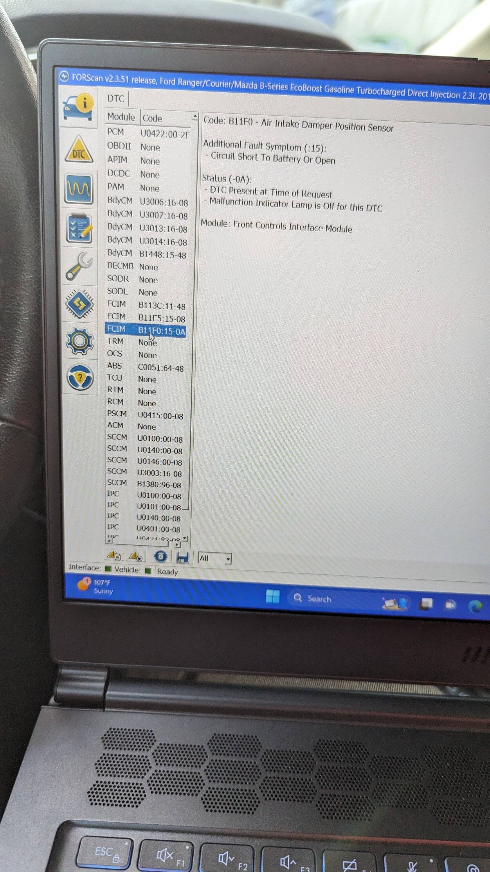

Plugged in my laptop after work. Saw some weird stuff like Invalid Data Received from Brake System Control Module A and Air Intake Damper Position Sensor,

So I found my rear axle was crooked and after investigation I found that my u bolts on the right side broke loose and caused my rear axle to shift backward so that was probably the sway I felt in conjunction with my bad motor mount. Man what a series of events. Good thing I'm a manufacturing engineer for Peterbilt or else I wouldn't have a clue or confidence of how to fix all of it.
