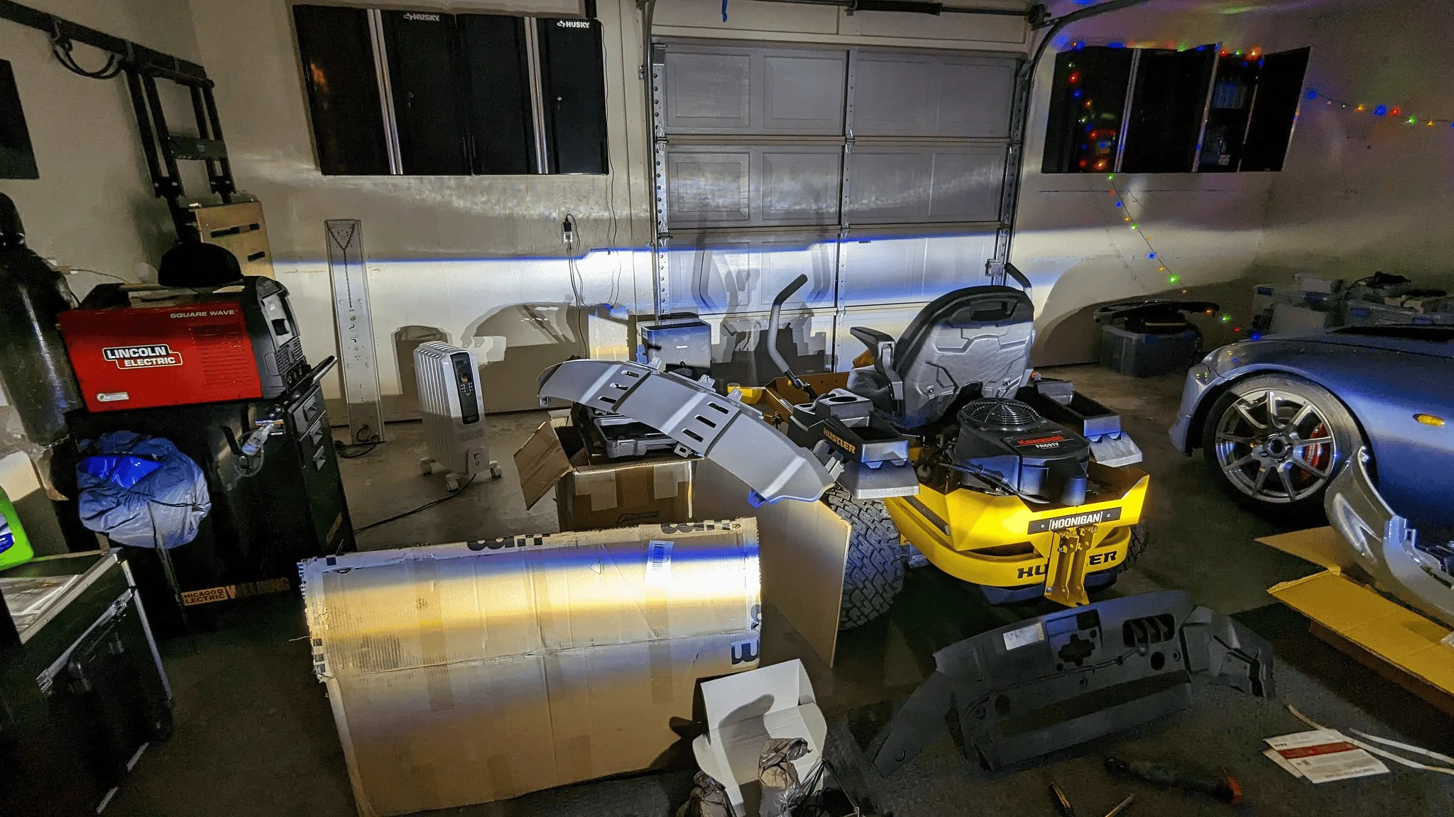

Can you take a picture of your Low beam Bulb mounted in the headlight from behind with dust cover off please :) Driver side is very easy access

Here is a photo of the light pattern on the Auxito H11 low beams taken today. These are the non-adjustable ones like shown above. You can see the amount of light above the cutoff line. The are verified to be seated fully in the housing.
Edit:. 10 ft from garage door in this picture

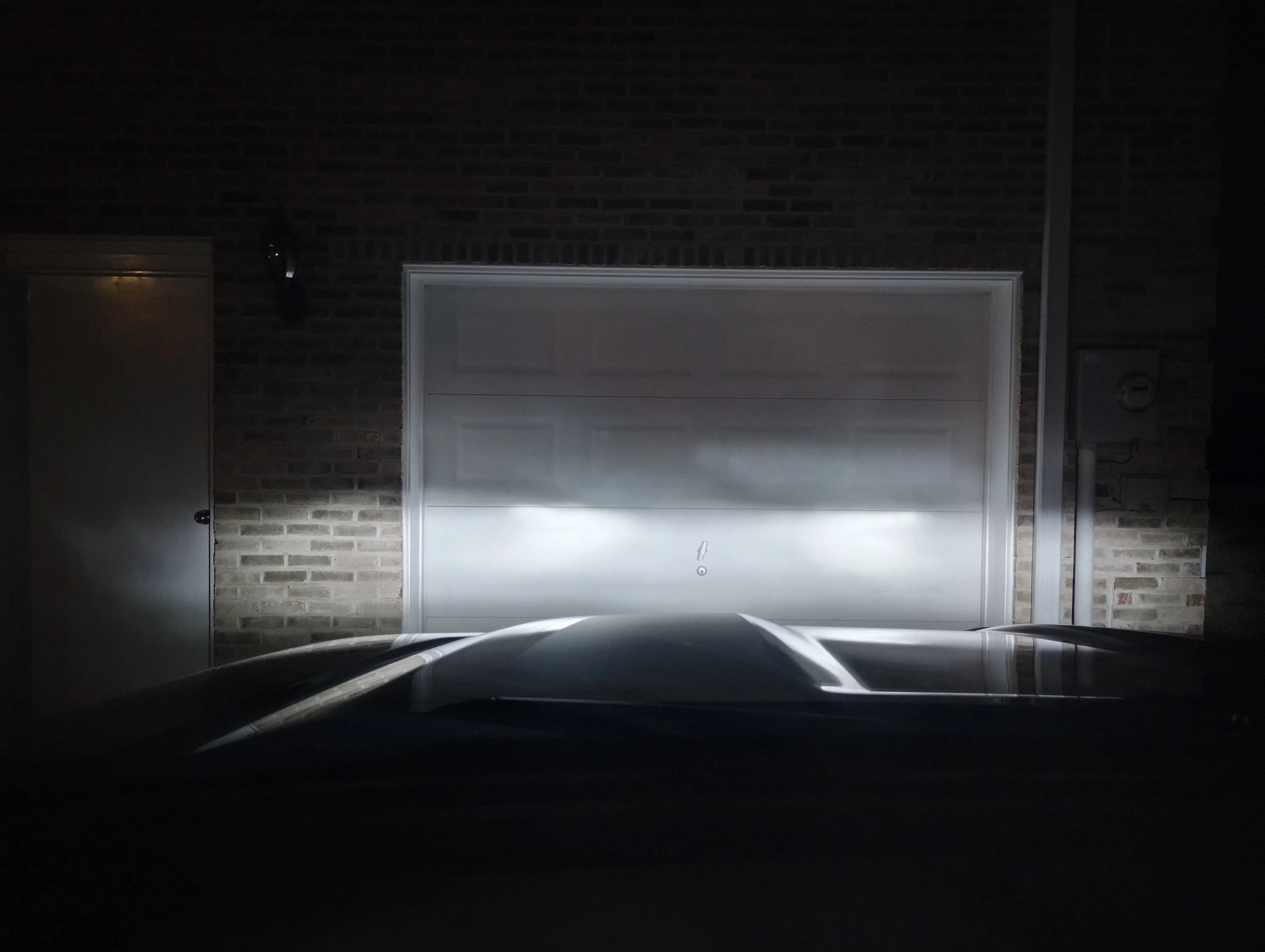

Just took these two images in the last 5 minutes (9pm)coming home from grocery shopping. This is Low Beam on my garage door. My driveway slopes/drains to the left, hence the slant of the beam lower on the left side.
There is NO light above the cutoff with my Amazon Auxito H11 LED. I set the camera to take 2 successive pictures. The first without flash, the second with flash.
The Picture on the Left is without flash. The Picture on the Right has flash enabled and you can see the flash reflect off the garage door.

I don't think that it gets better than this! My Maxima has Low Beam HID with a cutoff this crisp. I am not going back to filament bulbs on my 2020 Ranger.

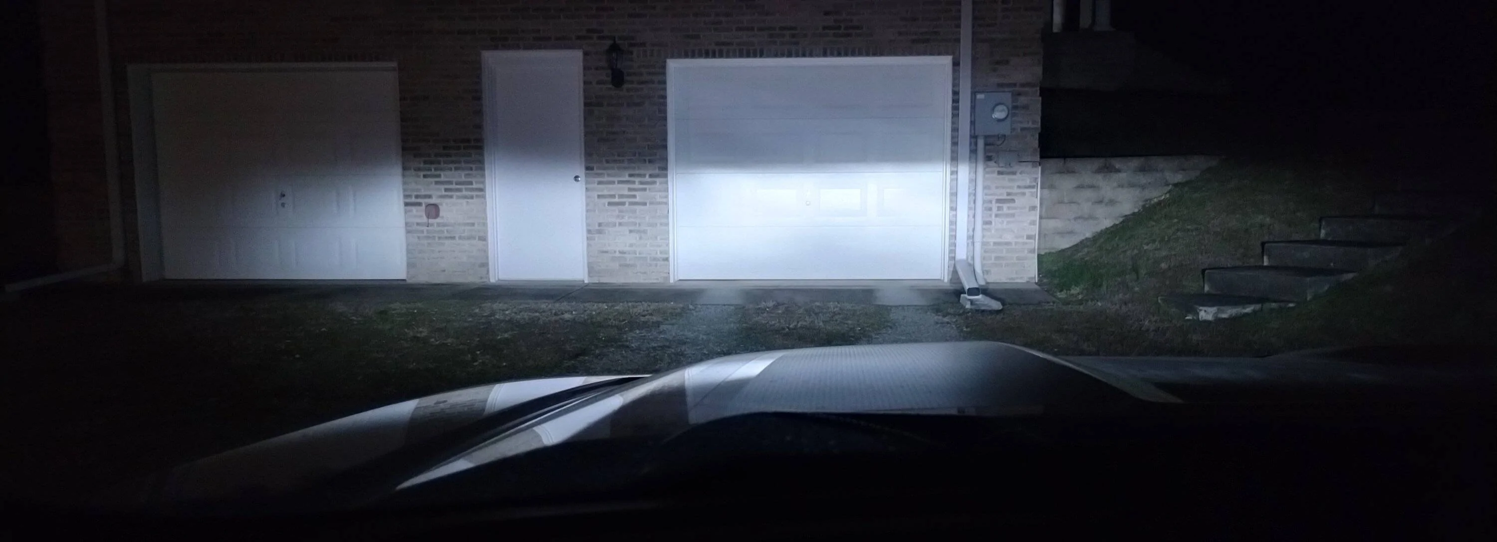

How far were you from the garage door? I was within 20 ft. I'd like to redo my pic at an equivalent distance.
Edit:. My pic was at 10ft from door.

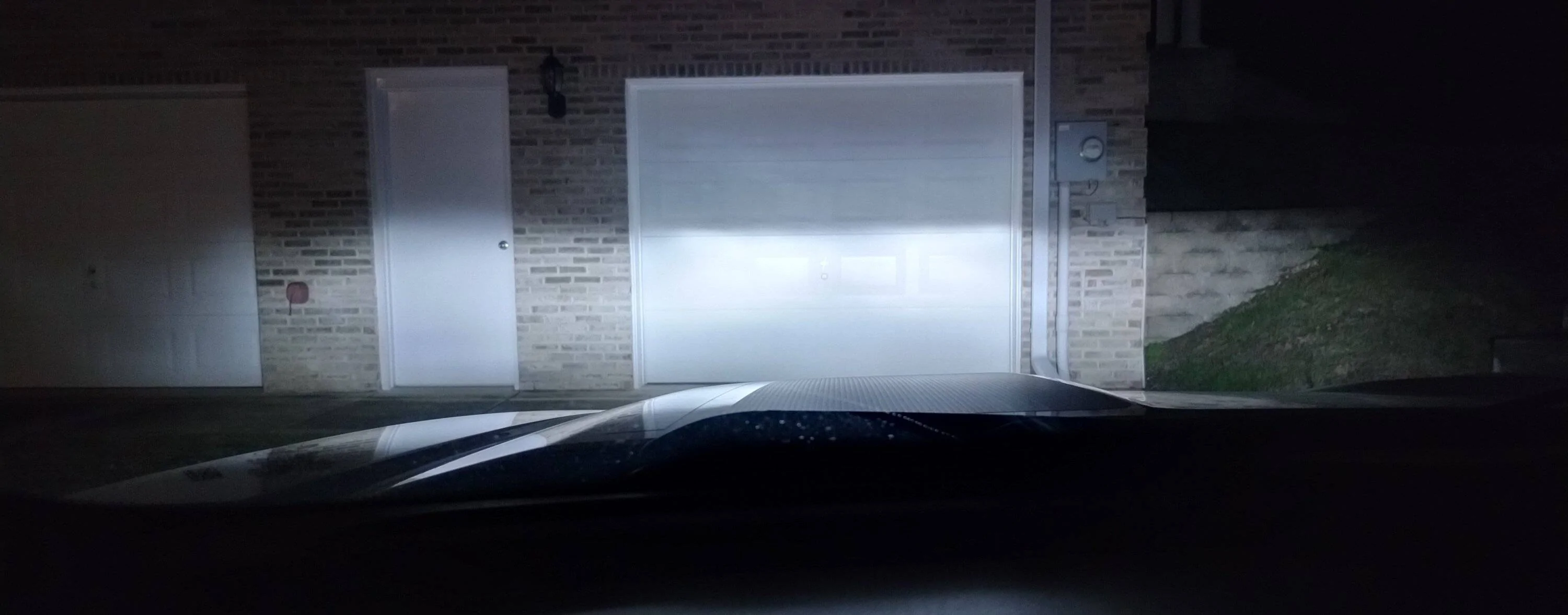

For comparison
25ft from door:
35ft from door:
30'. My land slopes down to this garage, then comes back up 10' from the garage door for water runoff during heavy rains.

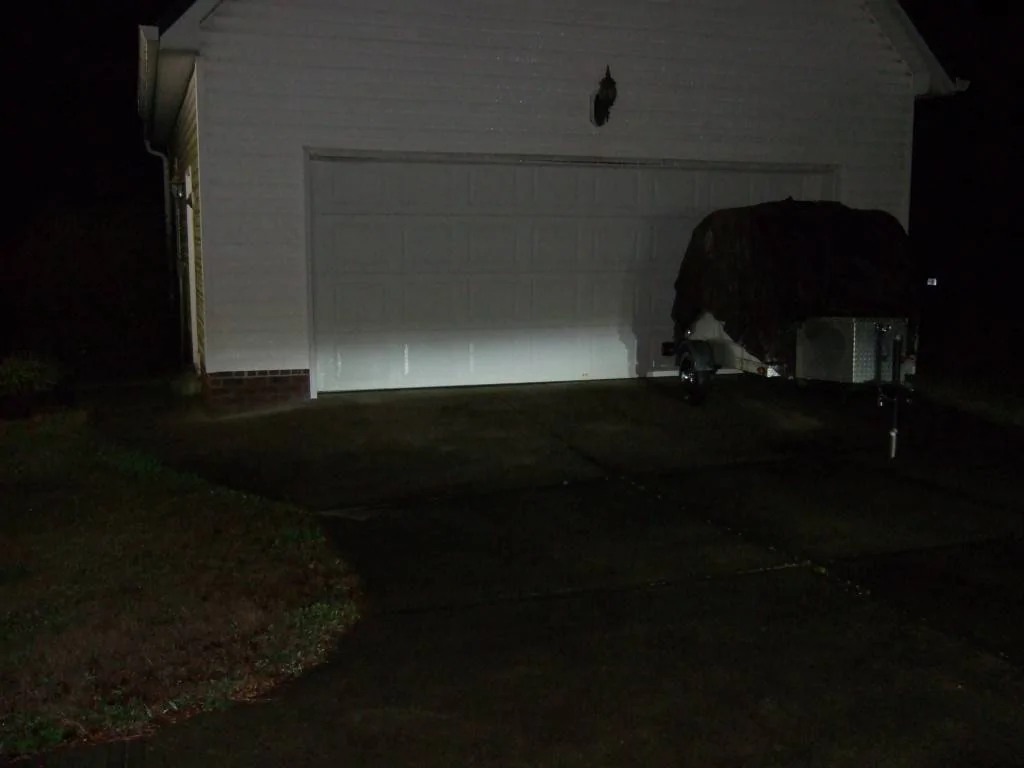

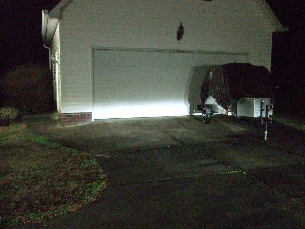

Are those low beams?
The cutoff line in mine were marked with the original bulbs. I then installed the Auxitos and had to lower them down to the same level.
These are low beams and currently aimed 1 inch below factory halogens at 20 ft. I marked the oem halogens like you did. My drive slopes away from my house for about 45 ft and then levels out. That is why mine appear high based on the incline.
