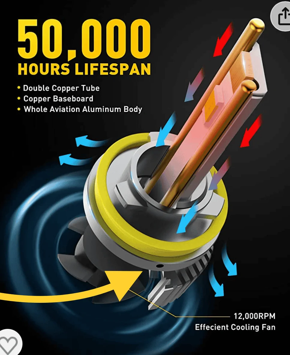

These are the ones I have. AUXITO H11 LED Bulbs, 120W... https://www.amazon.com/dp/B0B71GWVCC
The arrow is pointing to the hole for the set screw. The “blade” should point straight up and down 12 & 6 so your LED bulbs point to 9 & 3. I had to adjust my housings down quite a bit after the install too.

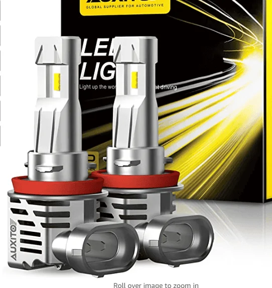

These were the H11 model I had. No ability to rotate them unfortunately.

The same ones I put it. Mine didn't need rotating, but aligning them to the correct tabs took a couple of tries.
