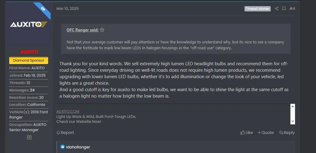

I thought something stinks.
Even their website states for off-road use for low beam LEDs (all of them). They made a thread recently and I actually commended them about doing this. What a shitshow, I don't care if you are a sponsor here. You need to be called on this bullshit.
I should have known your response as the time was some scripted malarkey.
If this website's owner had any integrity they would dropkick your account.

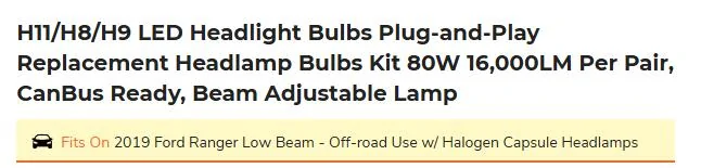

Its one thing to sell a product and then having no control over how a customer uses it. It is a completely different thing to lie about a product or ethically skirt the gray line in advertising.
These companies (and in this case specifically AUXITO) also drop any off-road disclaimers from their Amazon (and similar) listings knowing damn well what they are doing.
You know how they do it? They label the same product they do on their website for low beam usage as "Fog lights" on these third party websites.
Their direct website for Y13 bulbs (note disclaimer):
Same product on Amazon for Y13 bulbs (avoids disclaimer, by marketing for "fog lights")
https://www.amazon.com/AUXITO-H11-H8-H9-Adjustable/dp/B0CMCLYN8S?crid=2UNCDO3X1RK7B&dib=eyJ2IjoiMSJ9.PiPAijjtvoG-ewt9IuUg7cvmiuoajX4C2Hh0ScpPL69dT-qZatyHEVlLA2x6dsfhc59EhoUsiXLM4hyza6By3XBHnIxB7h7_UL-BGSFMM0lfRQhBM5TJgNTdU0S87N150p0pP1_gMuBR0kHUv2ZclA.QLGPkrtpb5k5ft0pibjTj4NGrot80TnDDAISNhKKrtg&dib_tag=se&keywords=y13+auxito&qid=1743164979&sprefix=y13+auxito,aps,143&sr=8-1&th=1
Also, "beam adjustable" is just marketing buzzword for "Yes you can physically rotate the base of the LED" it doesn't actually translate into "This works properly in a halogen reflector housing". Its all smoke and mirrors. Lies. A carefully constructed scheme to minimize litigation.
