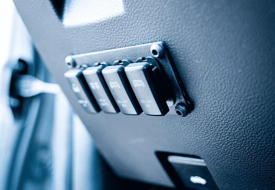

Hello, I find this switch panel on the internet. Where can I buy this component?
The Tremor package includes a factory-installed upfitter auxiliary switch bank, which requires additional wiring to connect to the engine bay, cabin, and specific accessory circuits. This means the Tremor harness is pre-wired for these switches, making it easier to add off-road lights, air compressors, or other accessories.
In contrast, a standard FX4 Ranger does not come with these switches, so its wiring harness lacks the pre-wired auxiliary circuits. If you were to add the Tremor-style upfitter switches to an FX4, you’d need to add the missing wiring and possibly modify the fuse box and relays to accommodate the additional circuits. However i link the switches below just in case you wanna give it a try.

Actually you can buy just the switch panel, it's just pricey ?. As far as the wiring and fuse/relay block, that may need to be custom.
I just replied to someone and yes The Tremor package includes a factory-installed upfitter auxiliary switch bank, which requires additional wiring to connect to the engine bay, cabin, and specific accessory circuits. This means the Tremor harness is pre-wired for these switches, making it easier to add off-road lights, air compressors, or other accessories. In contrast, a standard FX4 Ranger does not come with these switches, so its wiring harness lacks the pre-wired auxiliary circuits. If you were to add the Tremor-style upfitter switches to an FX4, you’d need to add the missing wiring and possibly modify the fuse box and relays to accommodate the additional circuits.

You can buy all of it now, I believe, but it's several thousand bucks total if I remember when I did the rough math. Like more than the Tremor package costs when you're buying the truck...
You're better off adding an aftermarket switch/button panel and running some wire and some relays and fuses yourself.
There are several members here with pretty sophisticated setups.
Yeah, I'm going with a AuxBeam or Niilight switch panel for some accessories I want to install, No way I'm spending upward of $2k on some switches. lol

exactly I'm getting a nilight switch panel and in going to get some safter rocker switches so i can have the old school style. Its super easy to wire it up and i don't think i will have to drill a hell of a lor holes in the truck to won't it so i think we should be good on that. Still haven't figured out a no drilling solution quite yet.

So the company I work for does some of the upfitting for Ford in both the USA and EU markets but mostly in the USA for GFX but still directly from Ford. I am wondering if anyone in the UK has access to THEIR price of the part number. 3Kis a LOT for some switches.
If I can get it directly from fords parts internal to our company, then I might be in business.
Does anyone know if that plug is actually there in all rangers?

If referring to Do all Rangers have the required connectors (to simply) be plug n play and all you need is the (Aux Switch Box) no I do not think so as far as cab / dash wiring - especially since this would be a - HIGHY (Wanted) Mod - We would need the wire harness to have wiring available at C237 (breakout) to C9805 then feed the switch bank C9120.
I never really dug into what is actually present (Non Tremor)
Plus you would need the Relay center in the engine bay and its associated wiring and an upgraded alternator to handle it.
