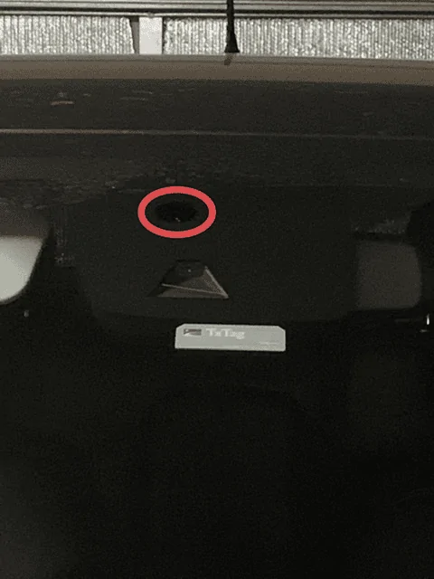

So, you need to have the IPC setting check marked for (Rain Sensing) & (Auto)
Right stalk one click up from off. (This is for Intermittent & Auto Rain Sense)
The right stalk (Rotary) adjusts sensitivity. All the Way Down = Low Sensitivity / All the Way Up = High Sensitivity
The rain sensor (module) is just below the Rear View mirror.
Now if switches are in the normal operating position, you may a code generated for the Rain Sensor, use Forscan and view and reset the code (any scan tool that can read (B) Body codes will work) if you do not have Forscan.
Rain sensor faults, the wipers default to Intermittent
One other note, if you have a build-up of Rain-X or Wax it may be distorting the Rain Sensor and it thinks it is rain (in front of the sensor)
Some owners have reported issues with the sensor and its gel type lens and had it replaced.

Thanks for the extra info! I will check forscan, because it definitely seems like it is always on intermittent.
