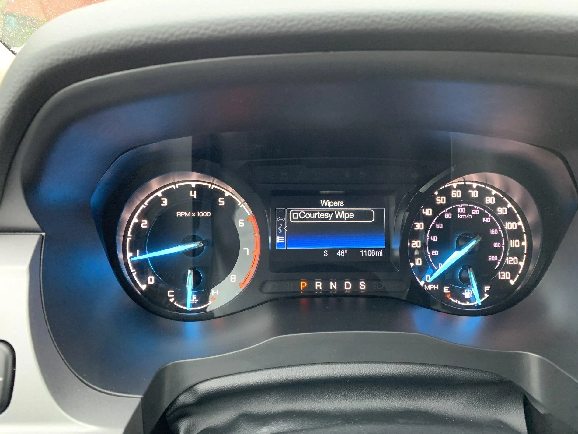

I was hoping someone could post the menu path or a picture that shows where to turn them on or off as I can't seem to find it and the owners manual just says turn the feature on or off but doesn't say "exactly" where. I kind of suspect my feature is missing because I don't want to believe I'm not smart enough to find it... Picture below of where I think it should be but isn't.

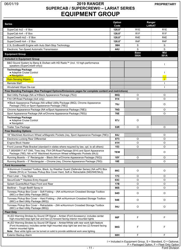

Ah the old courtesy wipe, it can be quite refreshing. Sorry, but if you're gonna lob softballs... From what I can see in the order guide, only 501A comes with rain-sensing wipers.

Like said above it's only on the Lariats. You're in the right menu to toggle on and off if it did have it, I just turned my courtesy wipe on last night on my way home from work and it was listed there one right above the other.

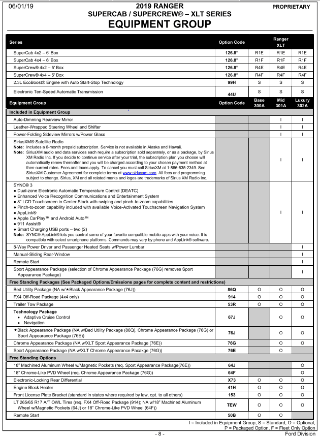

Well that blows, I didn't realize the technology package had different tiers. I saw it listed on others and didn't notice it missing on the XLT.
Yeah, the order guides aren't the easiest read but I like them for reference.
