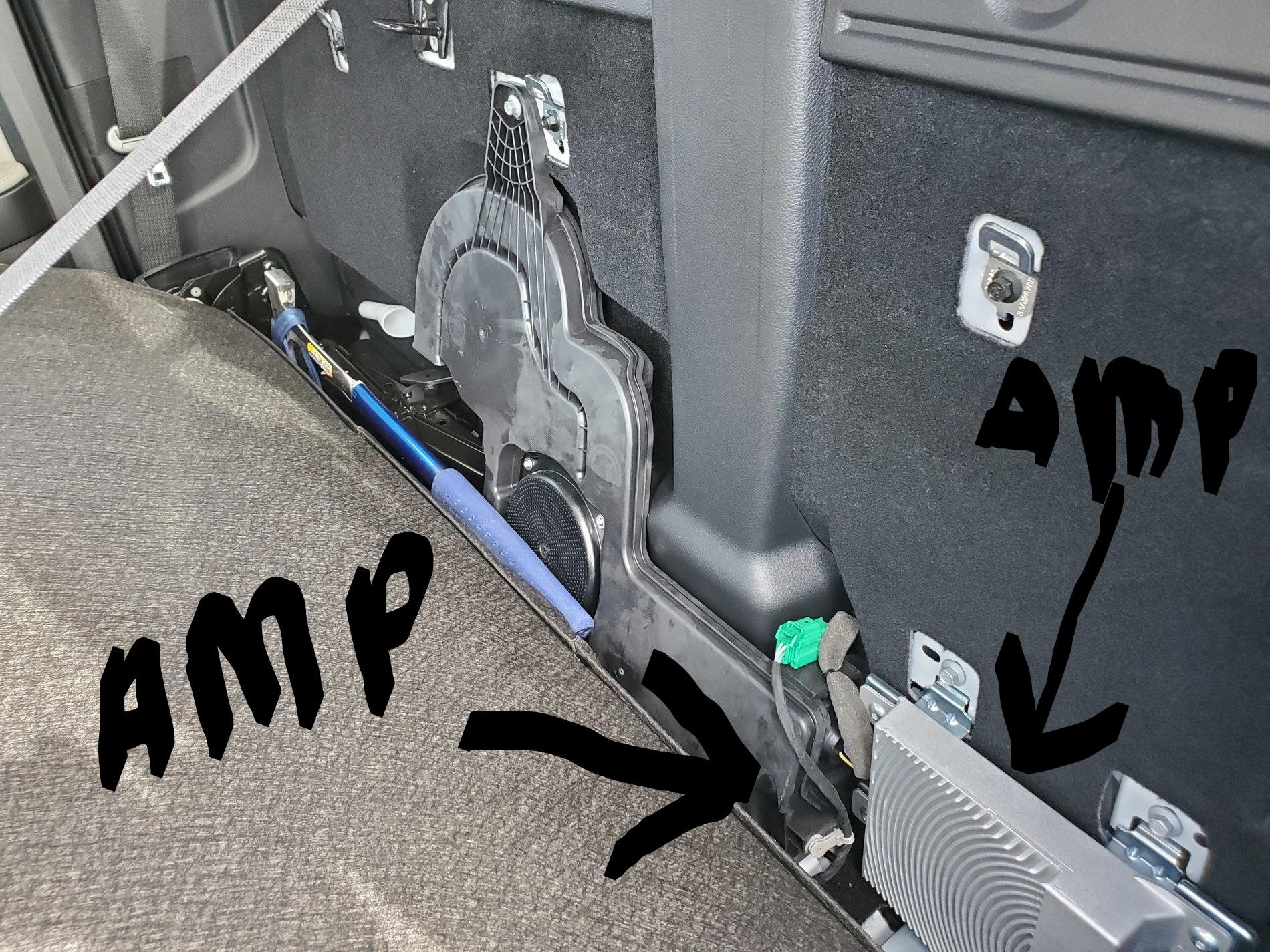

I have same issue. Unplugging data line to amp and plugging back in cures it as well but in my case a day to a month fix. Occurs on non remote start as well. Lookin for a permanent cure

Where is the "data line to amp"? I just had this issue happen to me today and couldnt find anything on the internet except this two post thread.

The amp is located behind the back seat on the driver side. With the truck off unclip the small plug at the top that has the six wires attached to it Plug it back in again. start truck.

Thank you!!
has this been a permanent fix for you? The issue happened for the first time yesterday in the year I’ve Had the ranger.

No unfortunately it is not permanent it’s just quick and easy. This has been going on for a year.
Dealer has replaced the amp
Replaced the wire harness to amp
Reinstalled software 2-3 times
Replaced the ACM audio control module
Done multiple diagnostic tests
Replaced the amp again last month
The problem has shown up for me twice in one day. Weekly bi weekly monthly or may take a couple months to show up. Dealer is at a loss. And Ford does not have an answer. Seems to show up In hotter weather I’m in Canada.
Frustrating for myself and dealer
