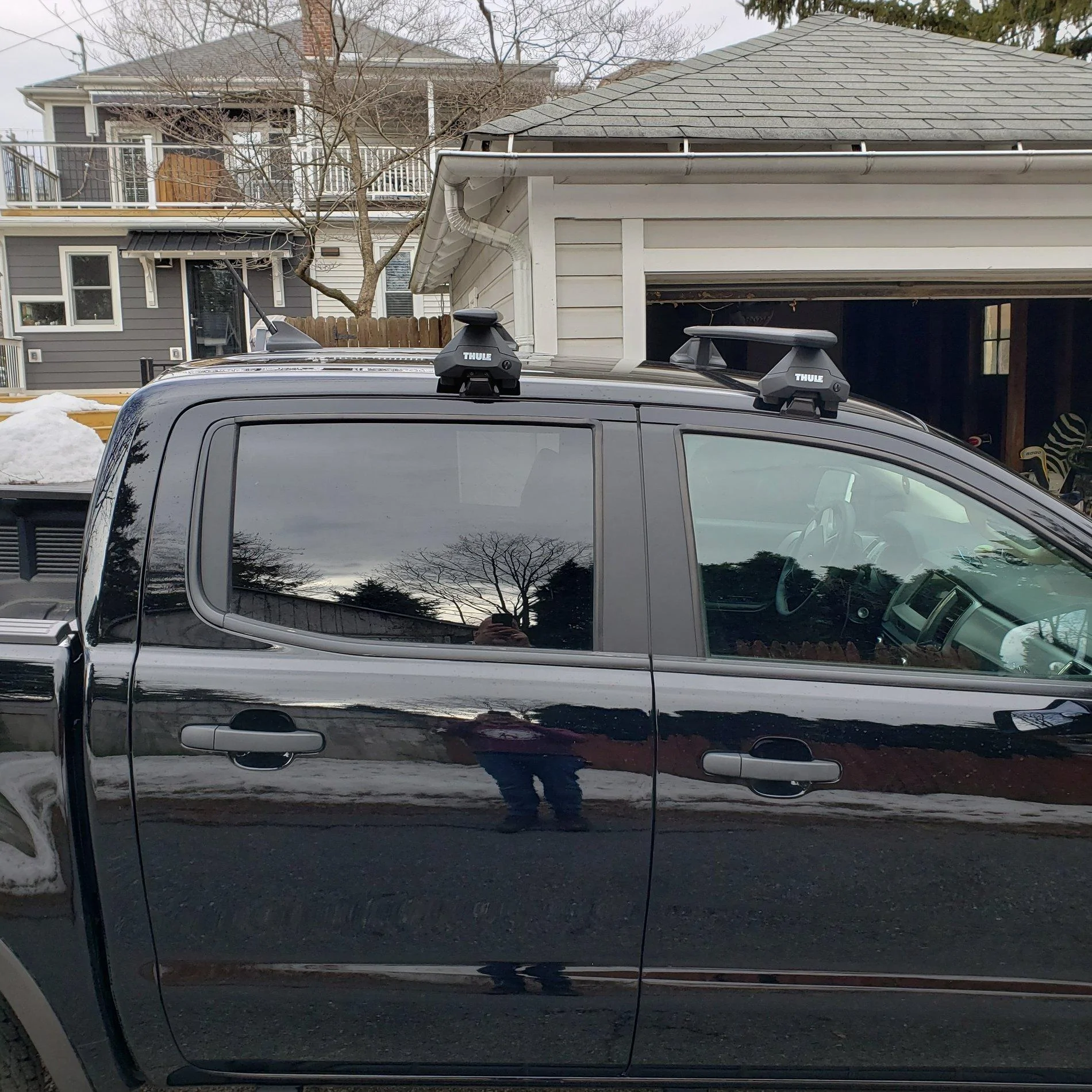

Installed Thule rack today

Is that the recommended spacing? I have everything but the Ranger specific fit kit and would have liked to see the rear bar farther back for my canoe.
It is. I too thought it should be bdck further and it does lookike the angle of the mounting plates will allow that if you choose

Ya, Thule seems to look for the cross braces in the cab for the rear mount, sure seems far ahead to me. I disregarded their instructions on my frontier and ended up with 2 little dents in the roof on either side. May have to look at this further as that's pretty tight for a 17' canoe, may need a goal post in the rear.

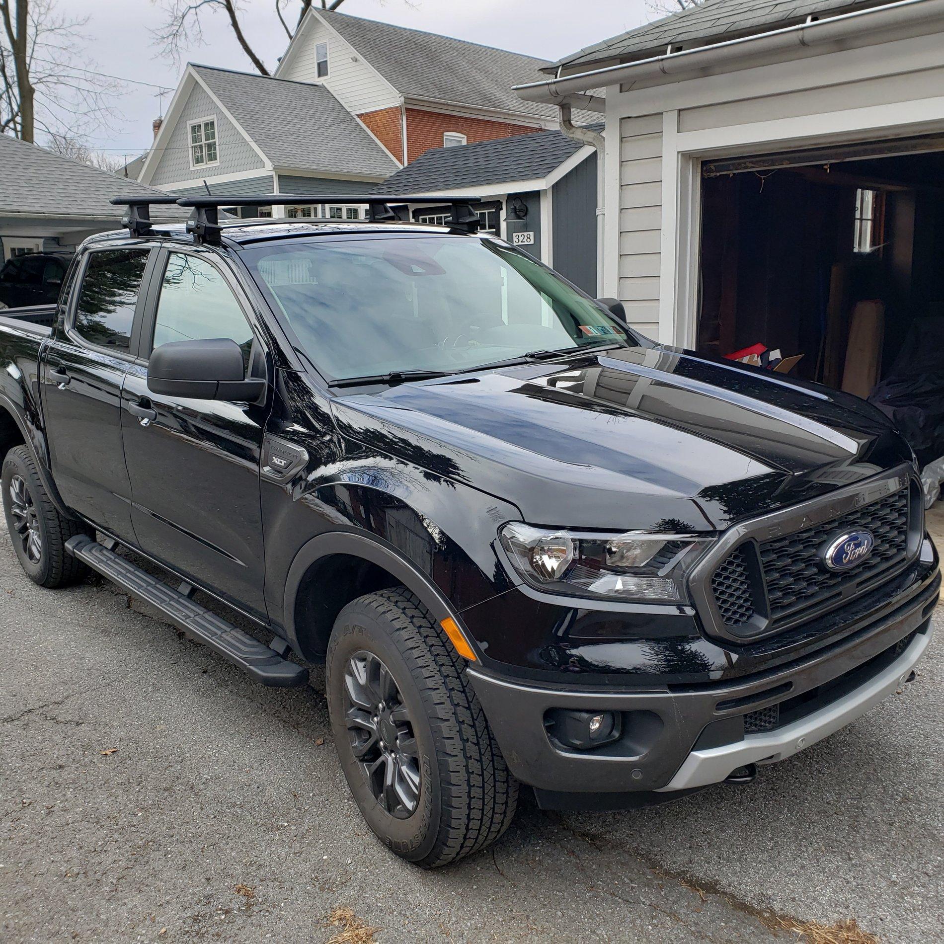

I went with the 60". They are a bit too long, but I like the added rack space. I am more a Thule fan, figured I would give Yakima a chance, but I don't think the parts are as top notch as Thule products. The end caps seem loose, the plastic riser cover seems cheap. I haven't seen a Thule rack in person, but based on past experience wish I went with it. That said, I get a ton of compliments on the rack.
Pics are here... https://www.ranger5g.com/forum/threads/yakima-rack-truxedo-sentry-ct.2089/
