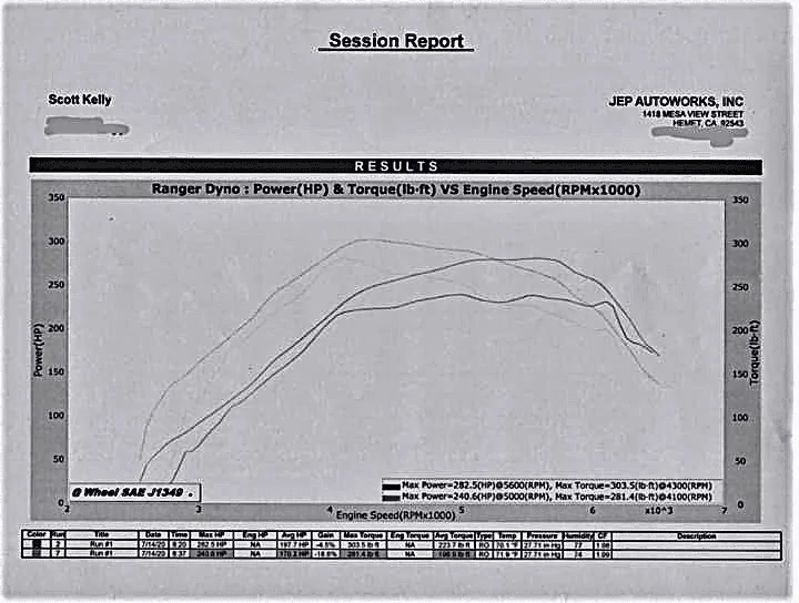

If you search there are a couple of FPP tune dynos on this site, and they all confirm roughly the same numbers. Stock tune Rangers make around 240 WHP and FPP tune reliably bumps 40 WHP.
A stock Ranger has 255 dyno proven rwhp on 93 factory calibration.
282 dyno proven rwhp on 93 with the FRPP calibration according to the above chart.
240 or so rwhp on 87 factory calibration is about right from everything I've seen. Sad if true. Not even getting a 25 rwhp increase on 93 factory calibration vs. 93 FRPP calibration.
FRPP should be ashamed of themselves....
Hoping that someone will do a 'head to head' comparison between all of the available Ranger calibrations. Would be tough to use the same truck as it takes many driving cycles (up to 40) to optimize the new calibration.
Enough of this 'piecemeal' stuff.... :)

It's really hard to have a fruitful conversation with anyone that has their mind positioned the way you do, but I will attempt so we can gather some facts.
First, that is not 93 octane. See the location? Hemet, CA. This is a 91 octane pull at best.
Nobody needs to be ashamed because things aren't made to your liking. The FPP tune is meant to be super safe. I don't understand exactly what your problem with it is.
