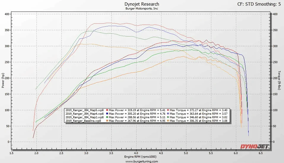

First off the JB4 at 93 Octane is good. see map 2 Results. (BMS data below) Not Mine
The JB4 alone will smack the boost gauge in the face. Gear for Gear it is more fun but you have to be good with the response curve. Sport mode is recommend to get the best results. If you want that pass his ass on the highway ability. You can go JB4 solo. I wanted the transmission tuned and that's how I ended up in this.
The key here is adding Ethanol to the mix and proper JB4 setup. The 2.3l Ecoboost Ti-VCT system senses fuel quality automatically. It will advance timing in the presence of Ethanol or high octane fuel with out a custom tune. For that reason I can't support running Rot gut 87 octane for these motors. They need to run premium. For the power, the milage, Efficiency, and longevity. E30 blend fuel profile take advantage of the near Race fuel quality cheaply. Couple gallons of Flex fuel and some good 93 gas, you got a race motor. Just flush a tank of 93 ever so often to burn out residuals and keep it clean.
On E30 I can get JB4 running map 5 without major concerns. However, It was best in Map 3 or Map 4. Truth is the JB4 will push the turbo out to the Max all by itself. Map 5 targets 7 PSI over stock. The safety's feature help prevent issues and all the Factory Safety limits are in place> There are a lot of them BTW. BMS - Map4, Map 5 dyno number are above. ( E30). As you can tell the raw numbers are significant. It is noticed in the seat for sure. The torque is disgusting for a 4 banger pick up.

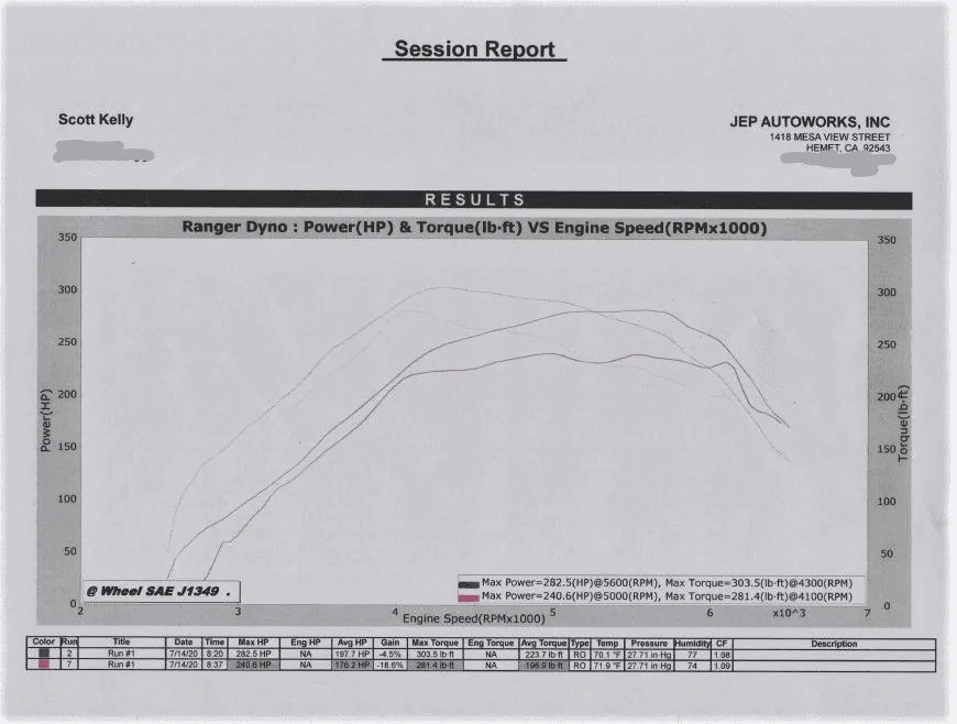

Ford Tune Dyno below. not my truck.
A Ford tune is a complete Calibration package. While The Procal 4 is all of 2010 tech style, It is has every tool to monitor what you want. It has useful options you just can't get elsewhere. This Package gives you that nice response and crisp shifts from the Transmission. You can recalibrate Fuel trims and Relearn the Transmission module. Cool stuff people don't mention often. It is almost worth the money with out the tune voucher.
Note: to keep the Warranty on a FPT, be prepared to pay up to $500 To the dealer for installation.

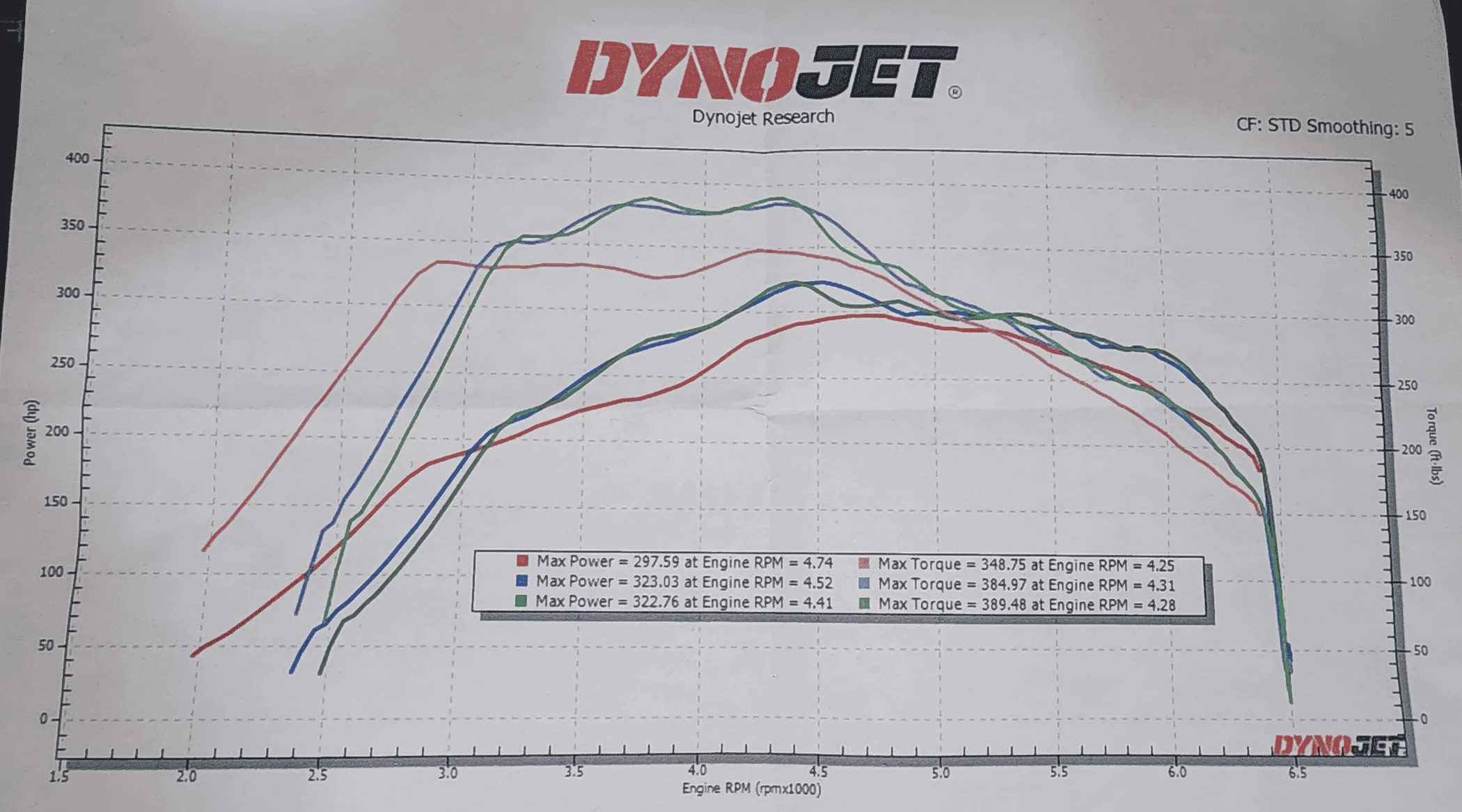

Now this is fun part. The combination of the Jb4 and Ford Performance tune makes for a Rowdy, ROWDY!! Ranger!! at about 23-24 PSI max in Map 2, The Dyno Came back impressive for a setup that can pass emissions and SHOULD be warranty valid in 30 minutes or less.
-Stacked Dyno Jb4 & Ford Performance tune. FPT (RED) Map 2 (Blue) Map 3 (green). on E30 Fuel, 5th Gear pulls.
At first glance it appears the stack is not much more powerful than the JB4 alone on Map 5. There are a lot questions marks about the comparability of these numbers. I had to do 5th gear pulls which is not 1 to 1 gearing. That would need 170-180mph in 7th. However, the meat is in the Low end and middle RPM Range. The consistent power delivery is seductive. I am confident something else can be down without major mods to improve the top end. Keep in mind there is power loss doe to gearing, my dyno numbers are likely average low.
The Butt Dyno speaks. with a simple Ford tune, a reset of the KAM learning on the Procal, a Jb4, and some shifty driving, this truck Eats!!. I will try and get the 0-60 numbers but I have Drag strip numbers for you all.

The truck is topped out at the end of the race do the fuel dump, boost drop, heat, gearing or all of it. I still have a stock intercooler. Inside a 1000 foot, and down in the 330 foot area, nobody was touching the truck. Chargers, Naw, Coyote f-150, naw. Bimmer, Hell naw!!. I still have a lot of work to see if I am missing something but the reality is this truck moves point to point like bat out of hell.
it keeps sustained Torque curve between 350-384 from 3200RPM out to 4400RPM.
HP peaks at 4400RM. unlike the FPT tune sheet at 5600rpm max 284HP. It so strange in that way. The power just drops off at 4500rpm on paper. On the street you don't feel that much. But it is a whole ton of fun getting up the road. Still has all the Ford safety protocols and 10 gears use. I can pull the Jb4 tomorrow and nobody is going to tell short of a autopsy. (Maybe)
With out the JB4 I can't take advantage of E30 unless a custom tunes made. At 93 I can just run base FPT all day No problems or map 1 with JB4. I don't need to Flash a ECU every time I change Fuel or my mind. If I want the go fast feeling I hit the KILL button.
