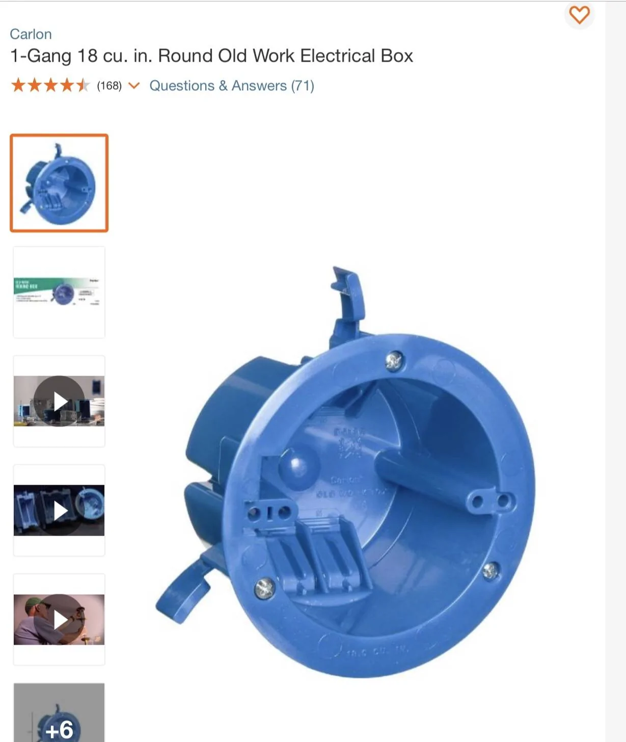

Thank you for your reply.. this is the electrical box I picked up. It has no green screw or anywhere metal I would attach the green ground wire to. Thats why I’m wondering if i just cap it off In my case.

That is what I'm saying, cap it and don't worry about it, again not an Electrician but if my house I would just leave it capped "green wire". It's just a safety measure that is required by law since the 60's.
