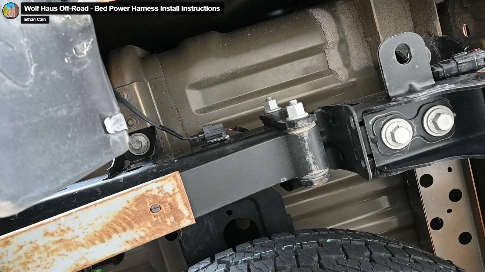

Affirmative - the extra plug is for Cargo Bed (Power Point) but this will be a tap source for Lighting or Power only
Do you think it’s just a run of the mill SAE 2 pin harness that I can order on the internet to plug in?
I really only need constant power. I’ll install a wireless remote switch to get the lights on/off.
Wolf Haus also has -the connector only (with a 4-foot wire lead) that will connect to this connector on the truck for $35.00, so this gives you a nice clean tap point and just (splice) your wires in.
However, this will be an always hot circuit with the truck running, so you would have to install a switch to turn them (On/Off) and they will stay powered (with truck off) as power is from the Power Point Relay (adjustable) times via Forscan - Factory Set @ 75 Minutes this time setting is for ALL Power Points in the truck (Front Cubby) & (Rear USB Charge Points)
The connection (above) for the bed power - shares power output from the Power Point Relay #2, which is for the (Rear USB Charge Ports)
Power Point Relay #1 - Feeds the front (Power Points) - Lighter Sockets

For Ref:
Specs on that connector:
C423
Female Half (Part of Main Harness) #14405 - This is what is installed and Terminated
Male Connector- WPT-1613, this is what Wolf Haus is offering and is actually cheaper through Wolf Haus.
So, for a clean install, you at minimum need this connector
