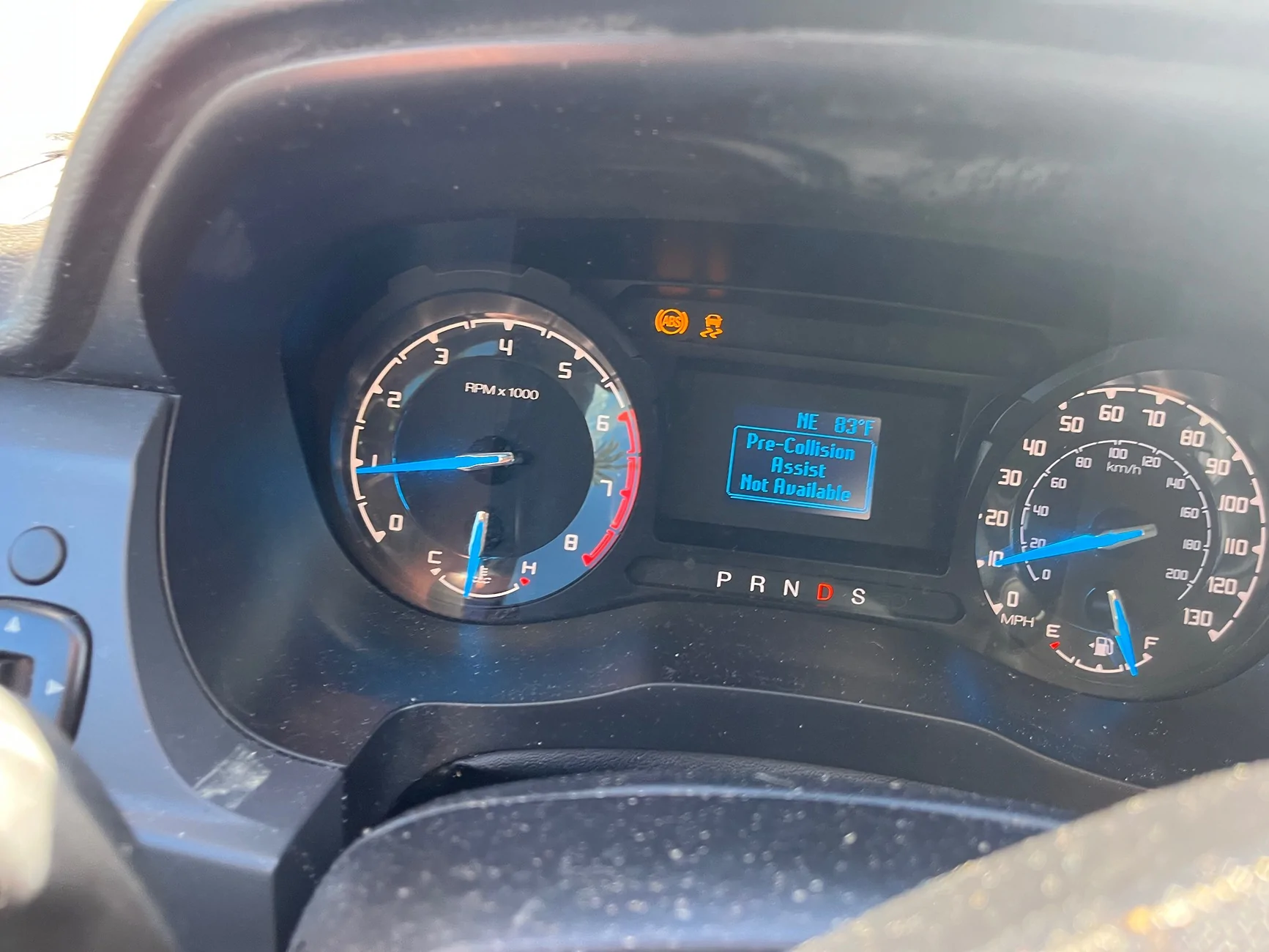

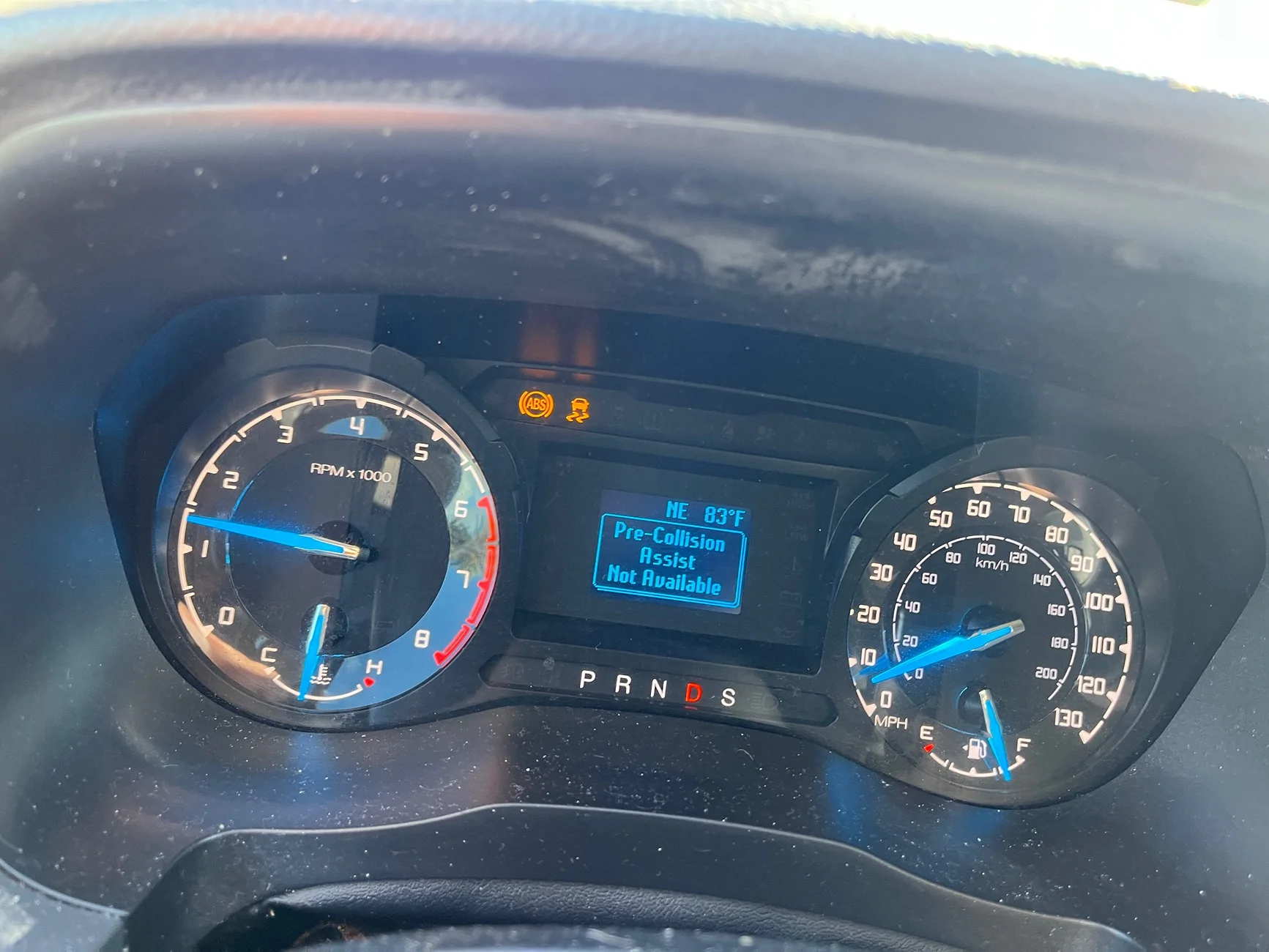

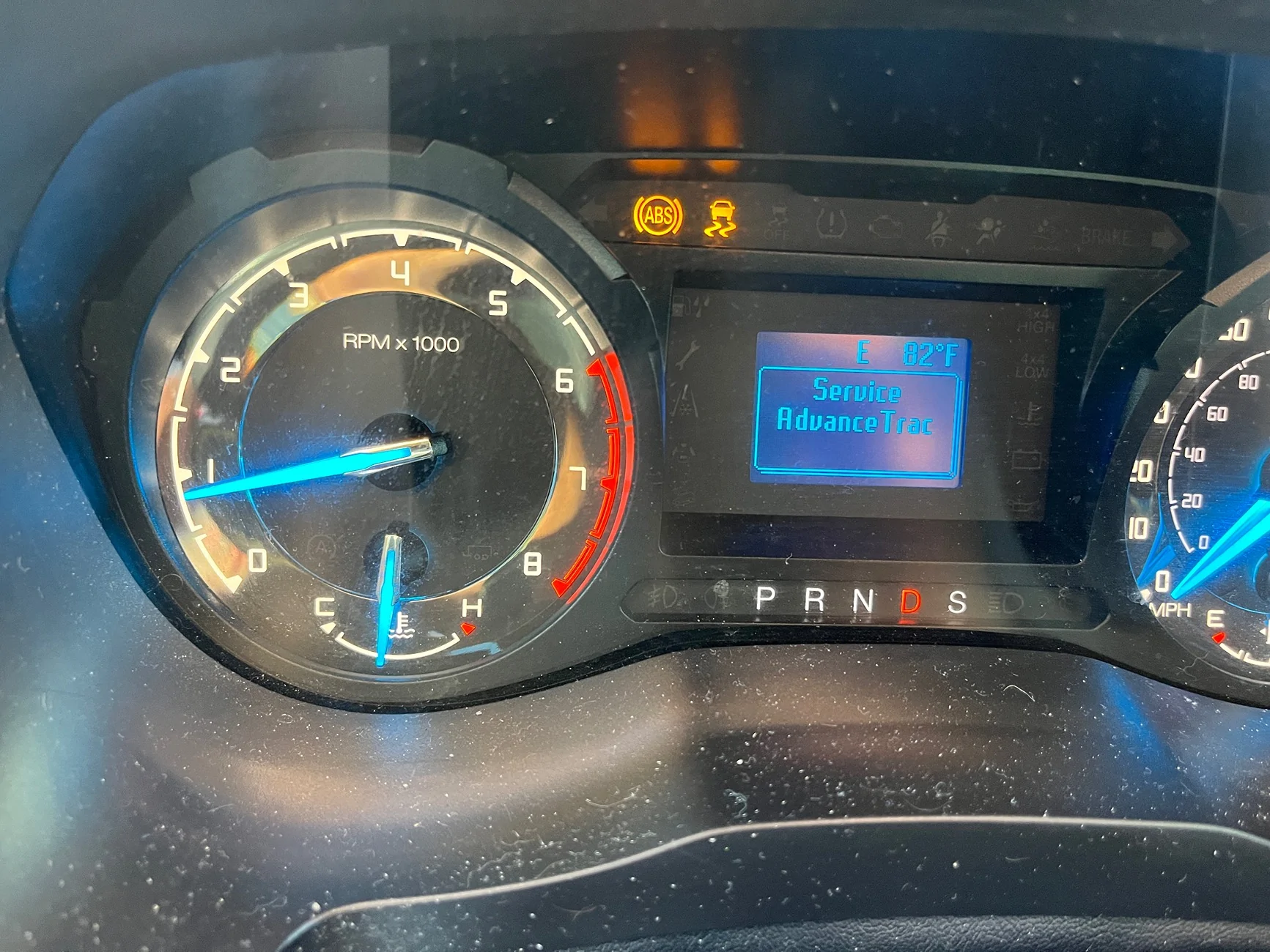

Getting these warnings on the instrument panel intermittently. Any ideas what would cause it or how to diagnosis? When I get this it is a little harder to steer; not sure what that connection is.

The most common is a bad wheel speed sensor - but scan for codes, sometimes its best to catch the code - when its an active fault - if it is intermittent, it may just be a bad connection on one of the connectors.
The (TIE IN)
We have (EPAS) Steering - so it reads wheel speed and adjusts steering tightness at faster speeds (prevents oversteer) - the system has 2 levels of redundancy in failure modes. (Reduced & Manual) you are experiencing (Reduced) steering assist
