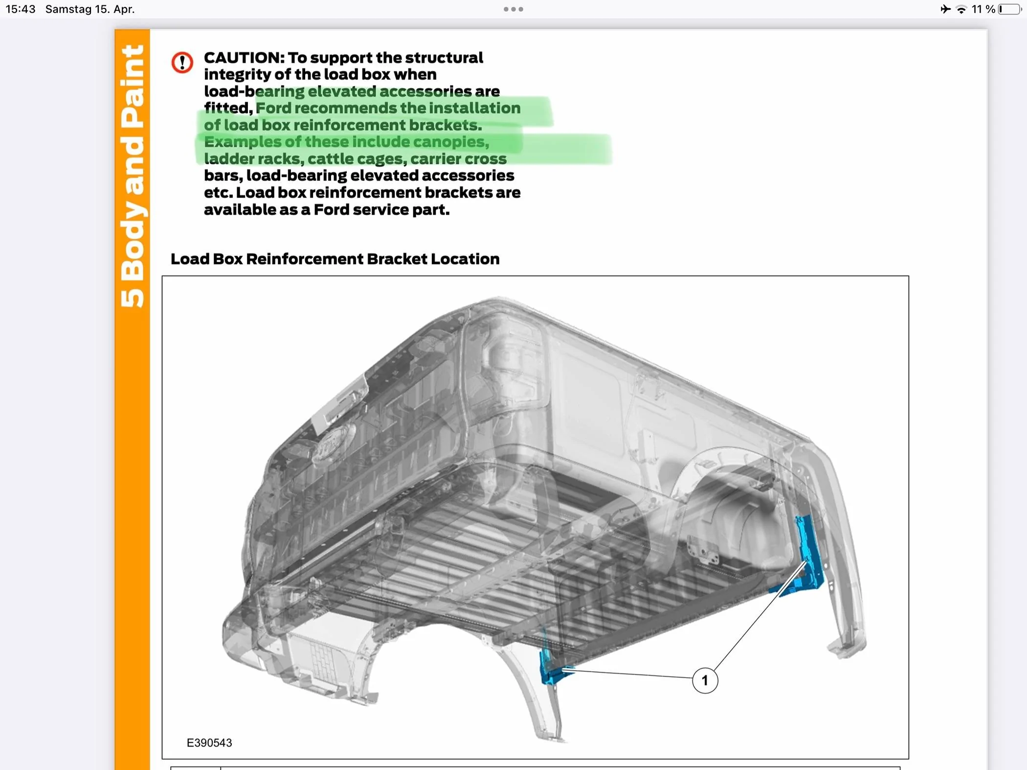

6G Rangers are supposed to have J-braces installed if you plan to run a cap or a rack. The question is how many people (like presumably OP) are going to have no idea that they are required? It's stated nowhere in the owners manuals. The truck even comes with "Load Carrying" supplement that includes absolutely no information.
There will be many owners who run into this problem I bet. Especially with racks. Some folk on the 6G forum have mentioned that the cap manufacturers are including the brackets with their caps.

These would prevent the issue ?? Wow. A nearly impossible aftermarket install and never once did I think I would need J-brace supports on a $65k Ford Performance
