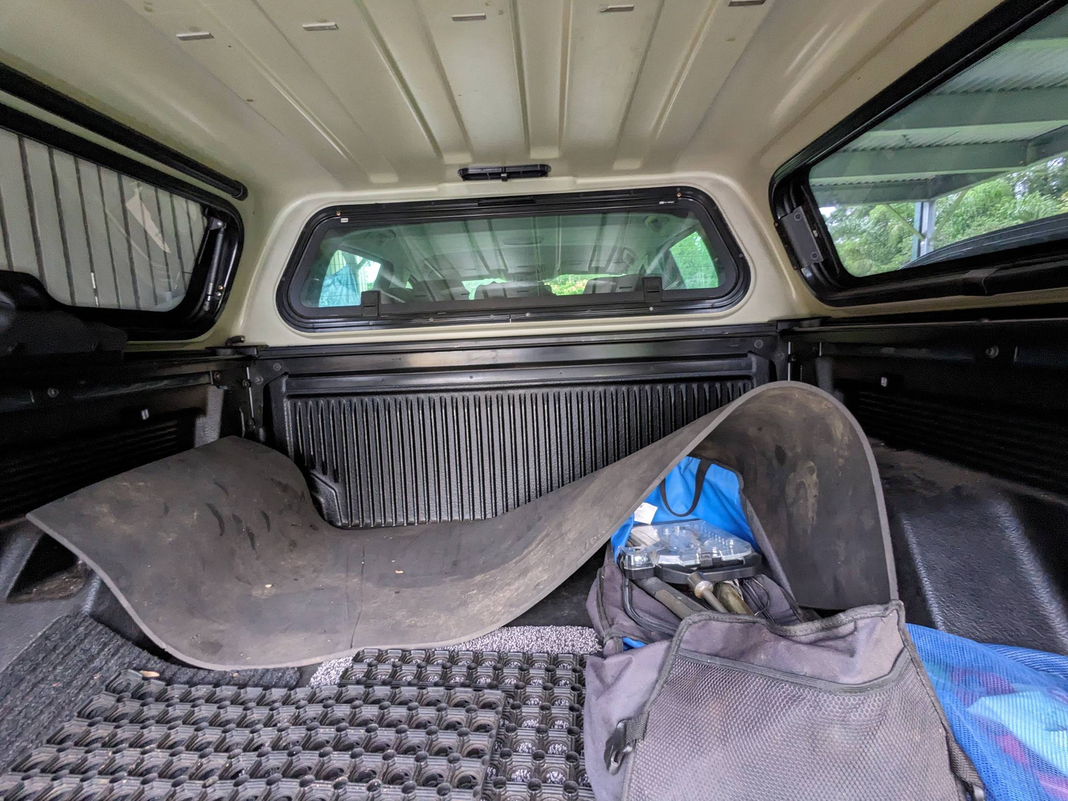

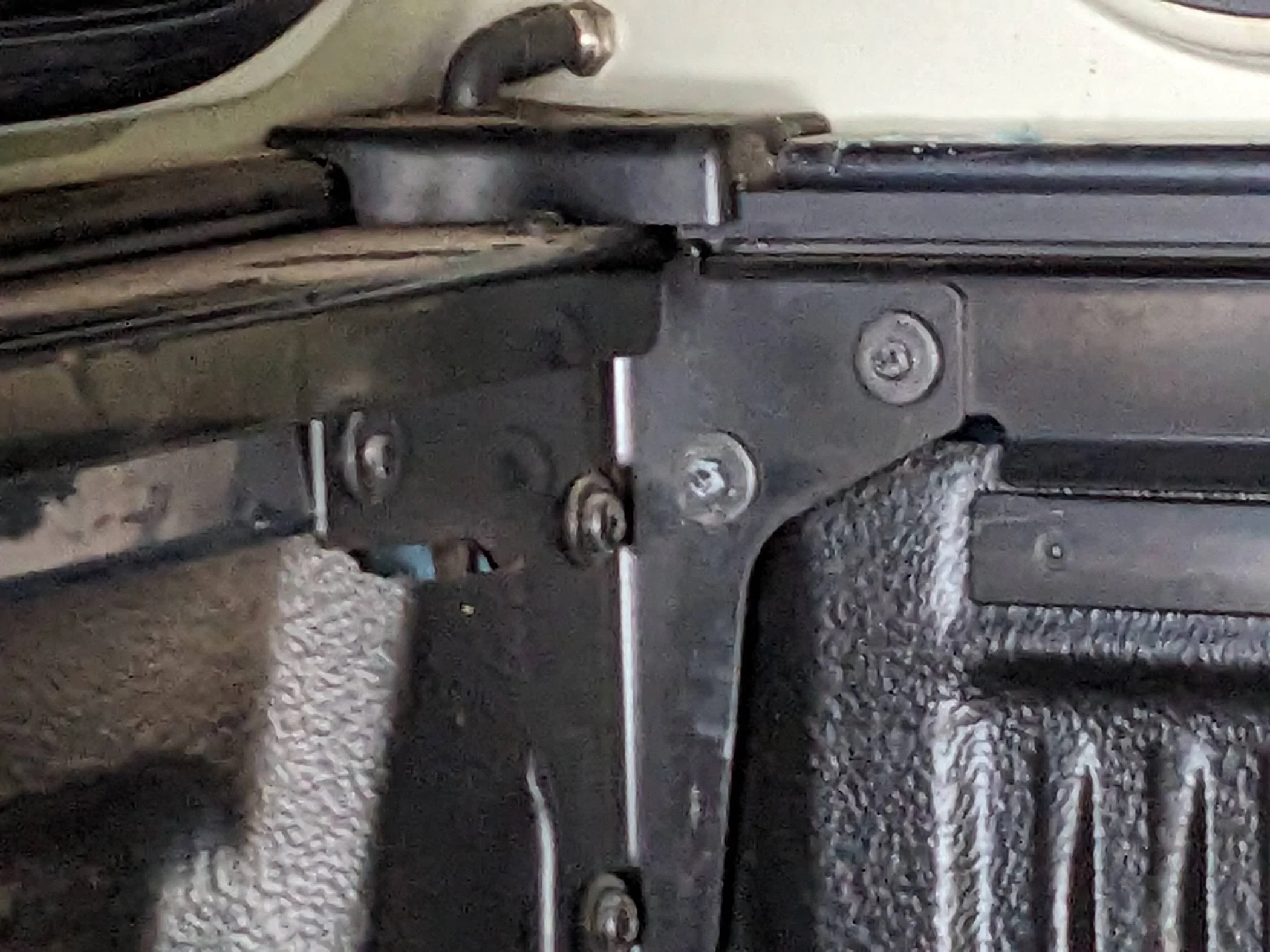

Here they are you can see the corner reinforcement brackets on the front of the tub, and the ones at the back.
Yes it's a bit dusty in there from my last camping trip, I planned to clean it out at Christmas, and then hurt my leg and only just getting around again now.

Thanks Cmar !!! Looks like they bolt right in to factory holes which is nice. Wish I knew if these before my bed has cracked on both sides with broken weld inside the wall !!! Hoping to get a set soon. Long way to Mexico and I see most for sale are in Aus. Thanks again !

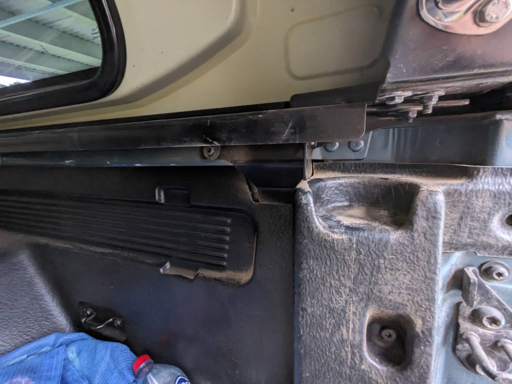

Just an update for any curious 2022 owners. I pulled off my camper and found the rattle was in the corner where there is no support. Not even a weld. I could pull the entire panel off the bed with my hands

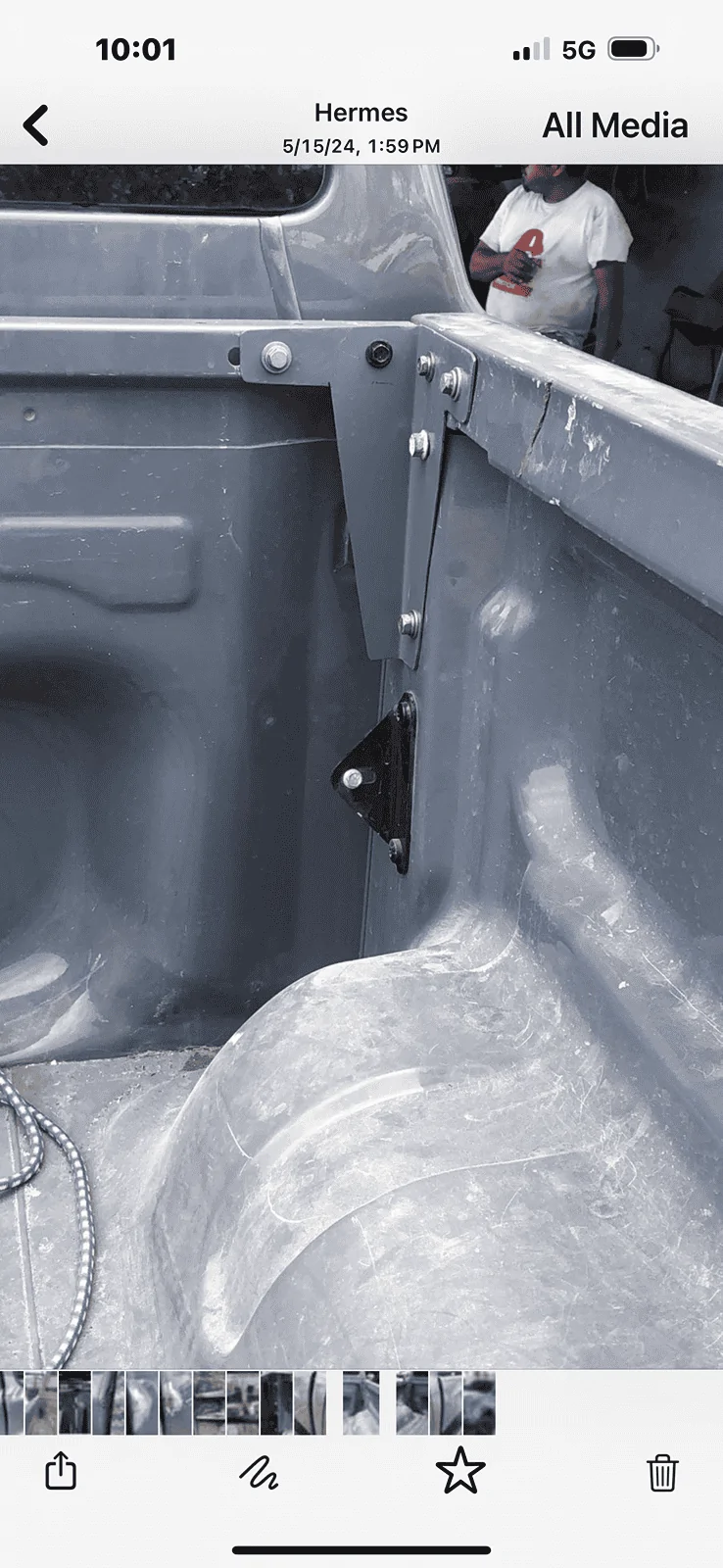

made homemade J braces and fixed the cracks. See how it holds up
