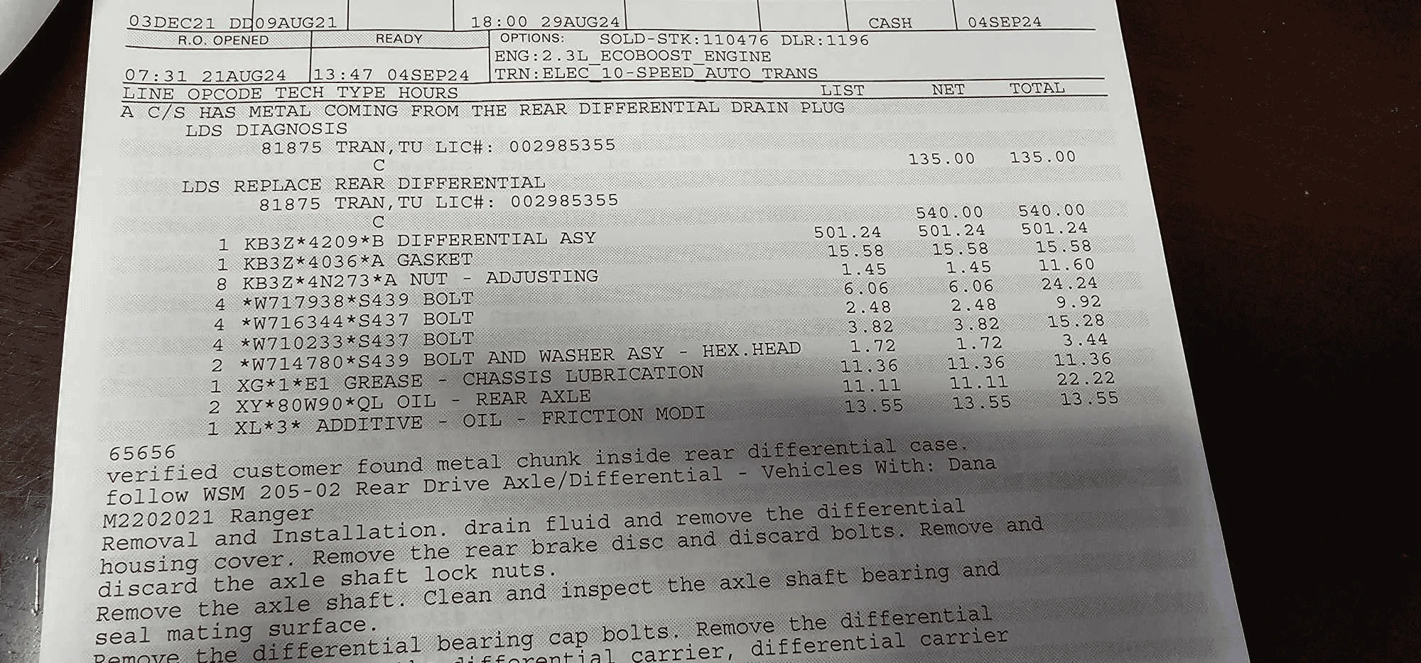

About three weeks ago at 65k miles I changed the differential fluid. There were large chunks of metal on the plug magnet. Pic below, I took it to the dealership and just got it back today.
https://www.ranger5g.com/forum/thre...he-metal-on-my-differential-drain-plug.30712/
Here's the parts replaced. When I bought the truck they included a 3rd party lifetime powertrain warranty. I was worried I'd have to fight them on it but it was covered no questions asked, $100 deductable. My total at the door with a transmission flush/fluid change, full synthetic oil change, and tire rotation was $564.48.

Curious, why did they put friction modifier in the differential oil? We don't have LS Differentials. That's been a discussion here lately .

that is pretty weird they put a friction modifier in the rear diff. We clearly do not have a LSD and ford only calls for Motorcraft® SAE 80W-90 Premium Rear Axle Lubricant - XY-80W90-QL

I just looked up the diff by the part number on the work order, it's definately not a limited slip. I looked up the fluid on Ford's online service info that is updated when there is a change, there is no additive mentioned for this differential. They made a mistake adding XL-3 to the fluid. I've never heard of this causing a problem in an open differential, the other way around, sure. However, I still wouldn't leave it in.
What does the friction modifier do? Makes the oil more viscous or something? I'm completely ignorant on this. You got me wondering if I should drain and refill it now. Do you have a link to what you're looking at so I can reference it when I call them? TIA
It's used to make the clutch pack happy in an LSD. It's really all PFM*. Like I said, I don't THINK anything will happen, you PROBABLY won't even know it's there. But since you KNOW it's not correct, I'd have them fix it on their own dime. Of course they will just try to suck out as much as possible to save on labor cost, you'll never get it all out. I can't link to the online manual because it's a Ford subscription, no sharing allowed.
*Pure F%#@#%G Magic.
I'll call them and see what they say. For the $20 the oil cost I'd just as soon do it myself. I live in a rural area so it's a PITA to get over there. Thanks
