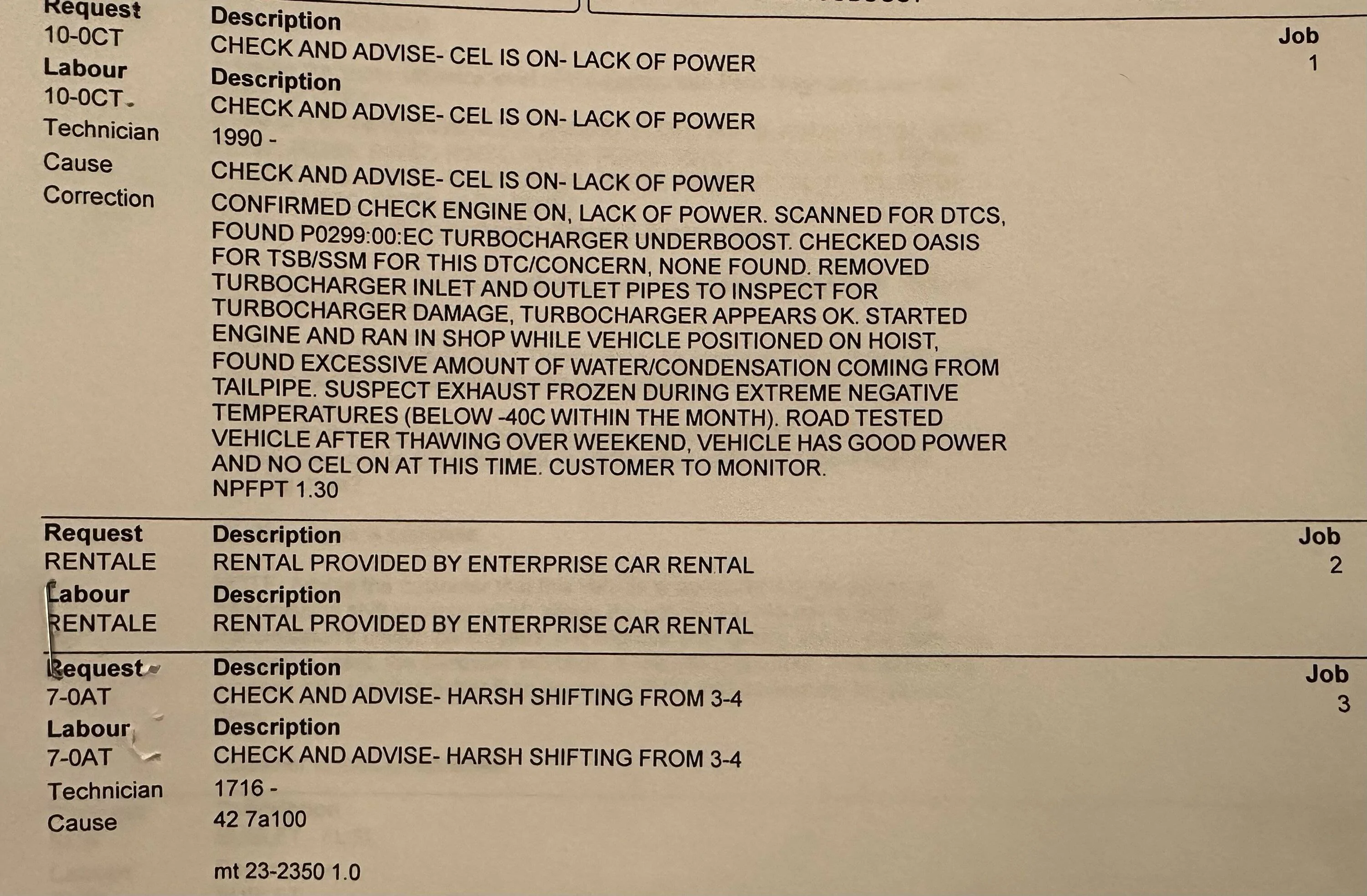

The engine seems to be fine, no issues. It has not been anywhere as cold as it was. With seasonal norms, that part is fine.

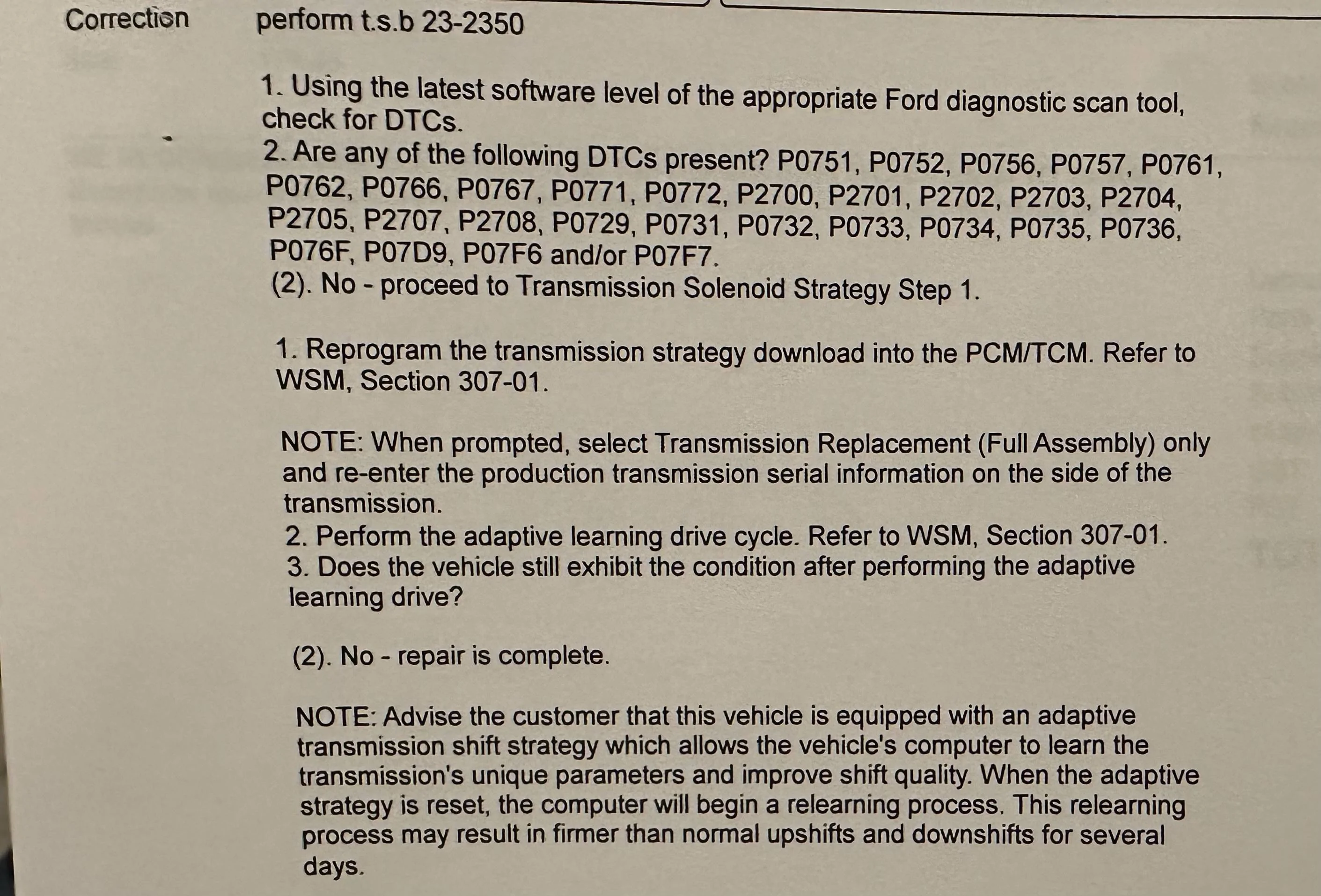

The transmission does have me concerned. Very sluggish when cold. I have a couple tight turns as I leave my parkade and get to the main road, and I notice the truck really slows down around these turns. it is okay after a minute of driving. RPMs increase as I add throttle, but no speed increase. The lag in shifting from drive to reverse and reverse to drive is back. No leaks, no clunk or other odd noise coming from the trans.
Probably best to book it in at the dealership.
