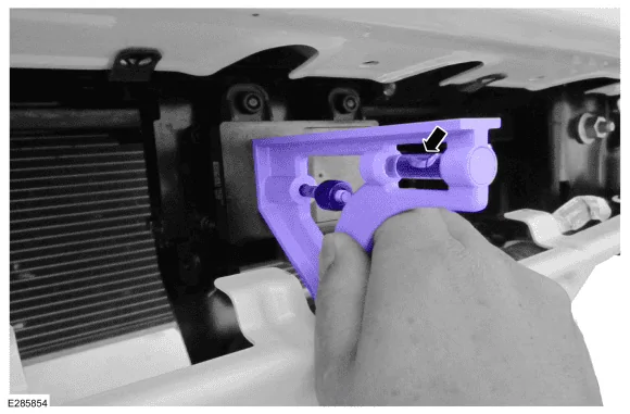

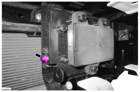

Being that the CCM was knocked off from its mounting.
Is the mounting point damaged, bent misshaped etc from the OE Design?
Is the CCM cracked ar damaged in any way?
Any damage to the bumper or surrounding areas in front of the CCM can cause operational issues are those intact and not deformed, bent, broken etc.
The CCM requires a secure mount and is calibrated (Vertical & Horizontal)
The Vertical Alignment is done (old school) with a combo square and adjusting this bolt.
Adjust to (LEVEL) the bubble
NOTE: In order for the adjustment to be accurate (it is recommended to be on an Alignment Rack)
To get the truck (True Level), but if you have a known level driveway or surface to park on this should work as well.
The Horizontal Alignment is done via the Scan Tool, with the Engine Running
The Horizontal Alignment is the CCM Calibration Procedure, it calibrates the CCM from its (installed Vertical) adjustment and requires no physical adjustment, it's all done via the software.
I am unsure if Forscan has this feature and may require a scan tool capable of doing it.
So, if any damage in front of or around the CCM is present or the CCM module is not mounted in the factory (leveled) position or allowed to bounce around while driving.
It is not going to operate correctly.
It has to be able to sense movement and objects in front of it, so 1 of these above variables is causing the issues you are having.
Other Variables:
Damaged CCM (internally) from the accident, cracked housing or damaged connector or pins from dropping down, pulling the harness.
Damaged harness from the accident, pinched chaffed wire etc.

Thanks for this. This will help me make sure everything is aligned physically. I saw where someone had used FORScan to calibrate the sensor and there is definitely a calibration item listed in the menu. Like I said, that will be my next day off next week.

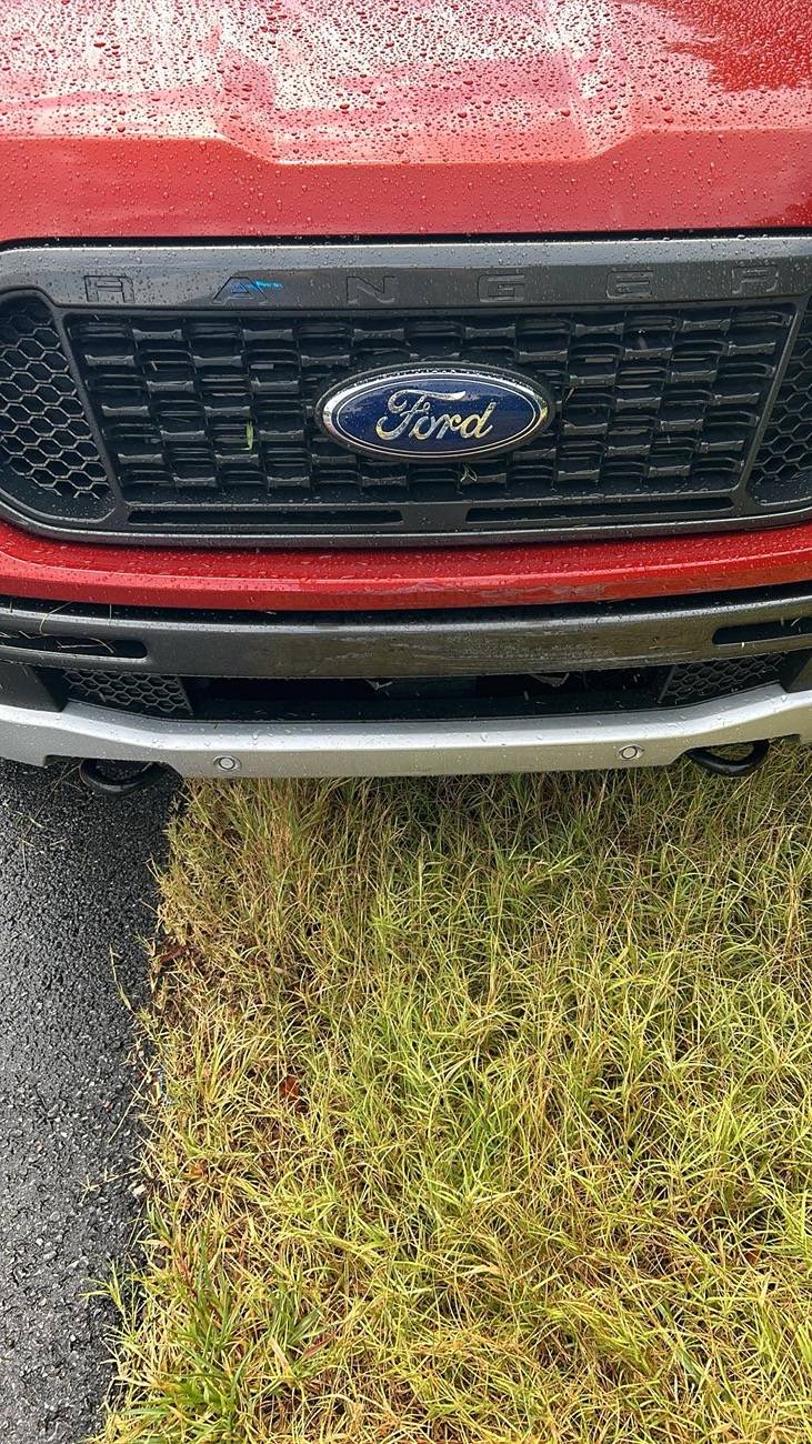

As for damage, when I say very minor, I mean very minor. This picture was at the scene (you can see the blue lights reflected in the grill). My license plate bracket got broken off and that was it
