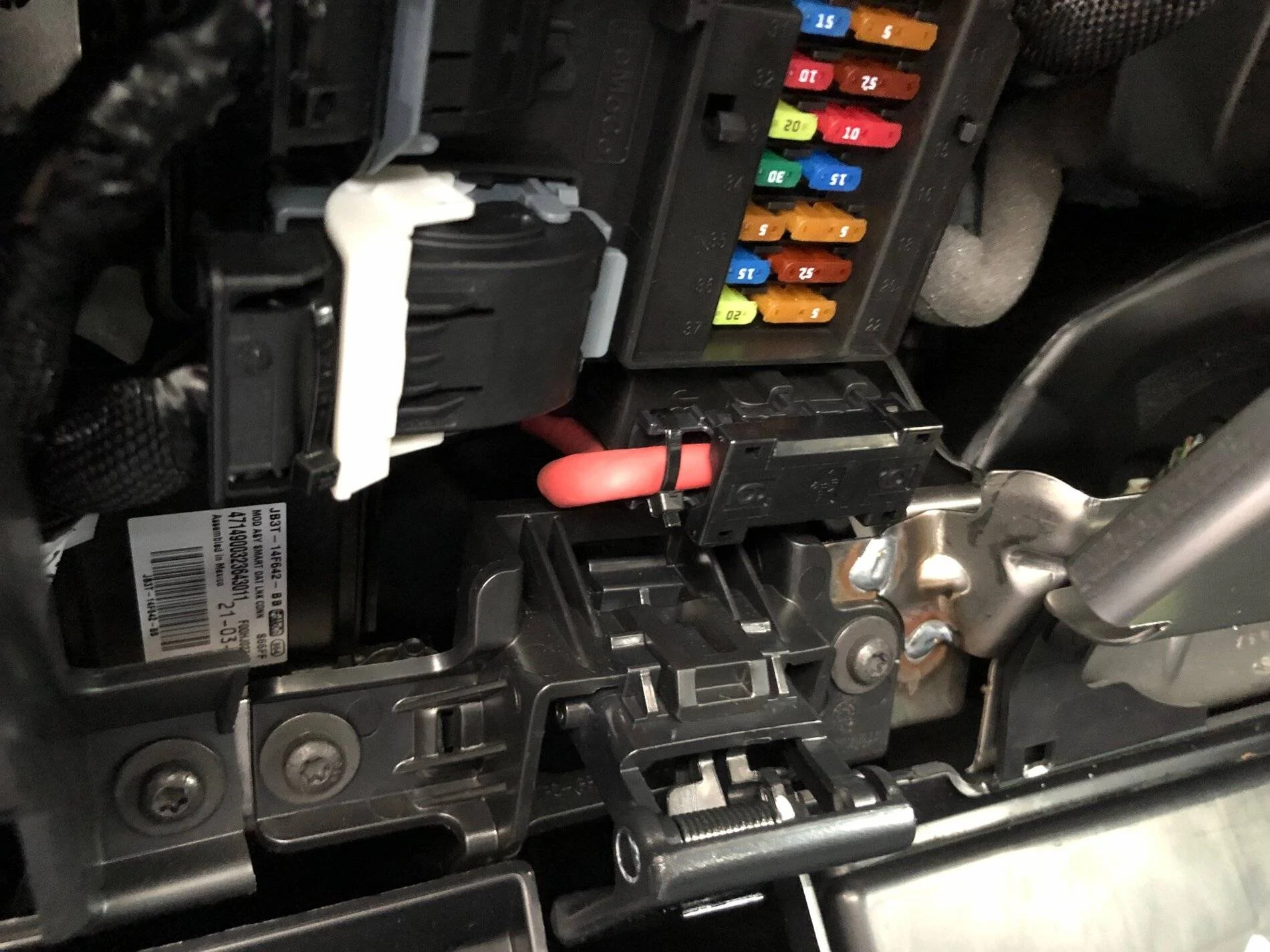

AdamHarris you are the winner (actually anyone who said check connectors is the winner)...opened the fuse panel in the cab and this connector wasn't pushed in all the way:
After I pushed it in most of the problems went away, there was a P068A code, cleared that and everything started working.
The problem I see is that it doesn't click in, so maybe it worked it's way out the past few months. Besides today, I've never been in the panel.
Thanks for everyone's input!!!
