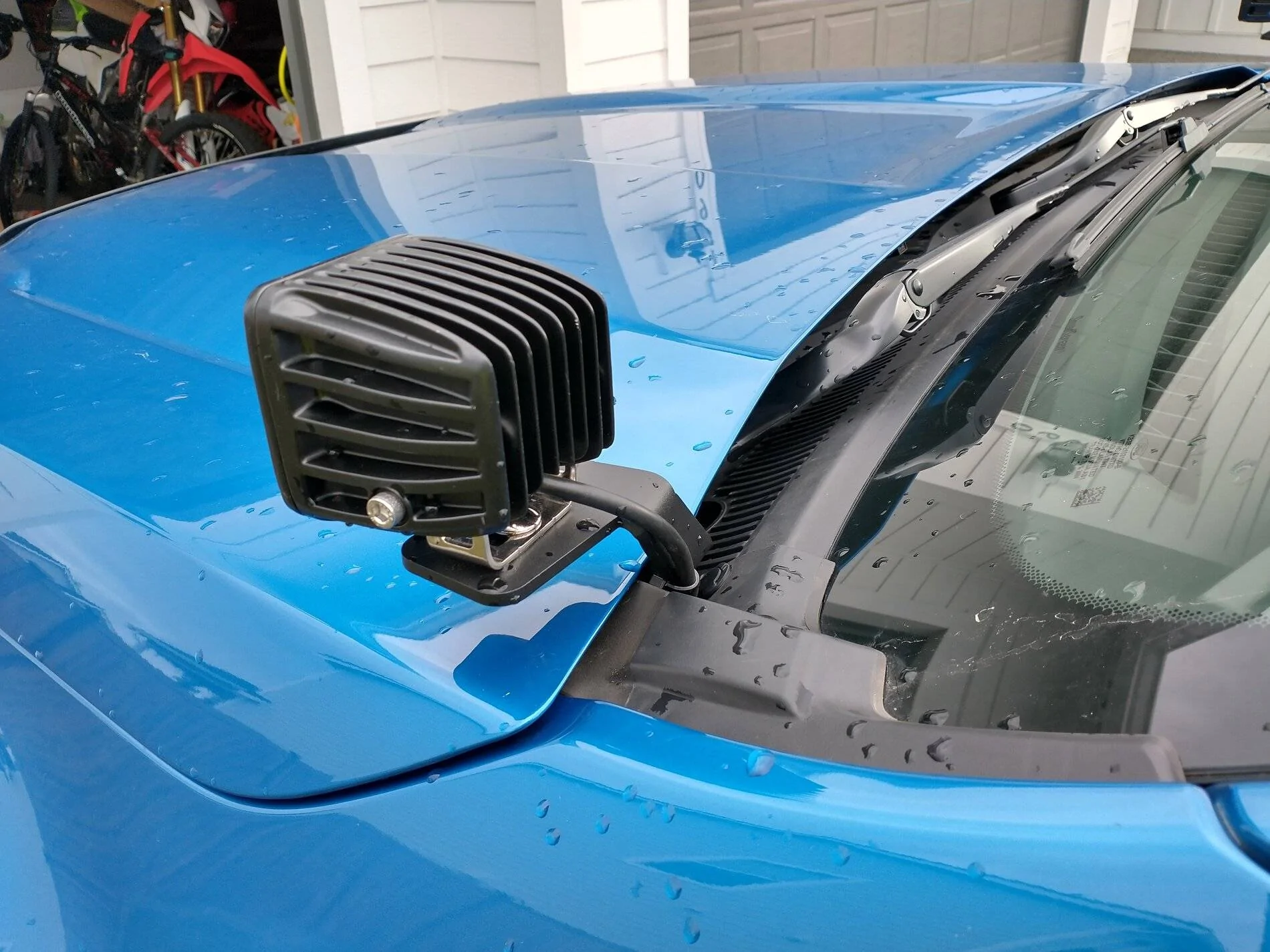

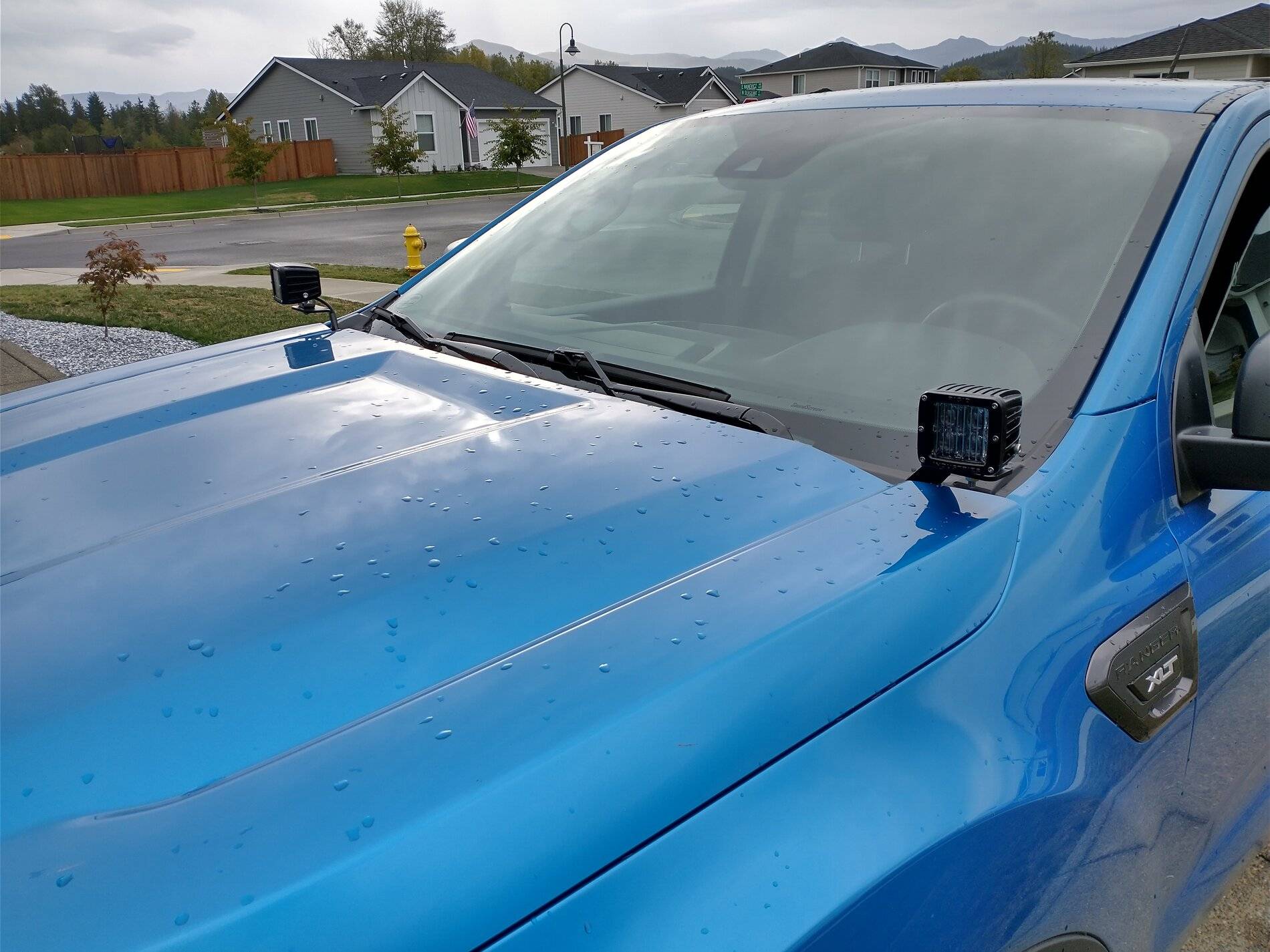

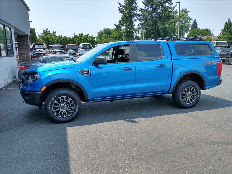

Installed some new pod lights today. I used the Diode Dynamics brackets and Rigid Lights. Still need to finish up the wiring, but I think they look great.

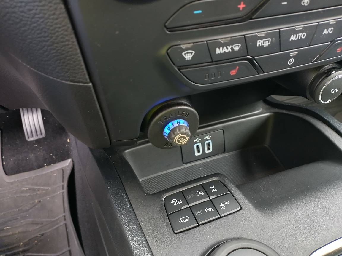

Finally mounted my brake controller knob using the Redarc adapter in one of the outlet holes. Looks clean and easy to reach.

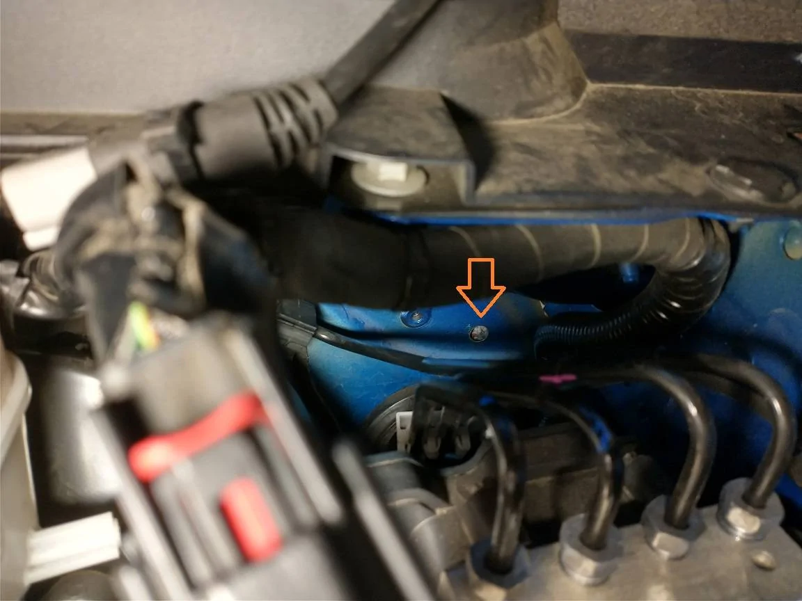

Also, wiring in the A Pillar lights was a challenge. I was originally using the Ford Install Guide as my reference. It appeared to show the wiring passing through the main firewall grommet. Don't do this. It's a complete pain, hard to reach, and has no previsions for it like my F-150 did. Instead, there is a grommet/plug just above that's much easier to reach.
Just cut the end of the plug off and pass the wires through.

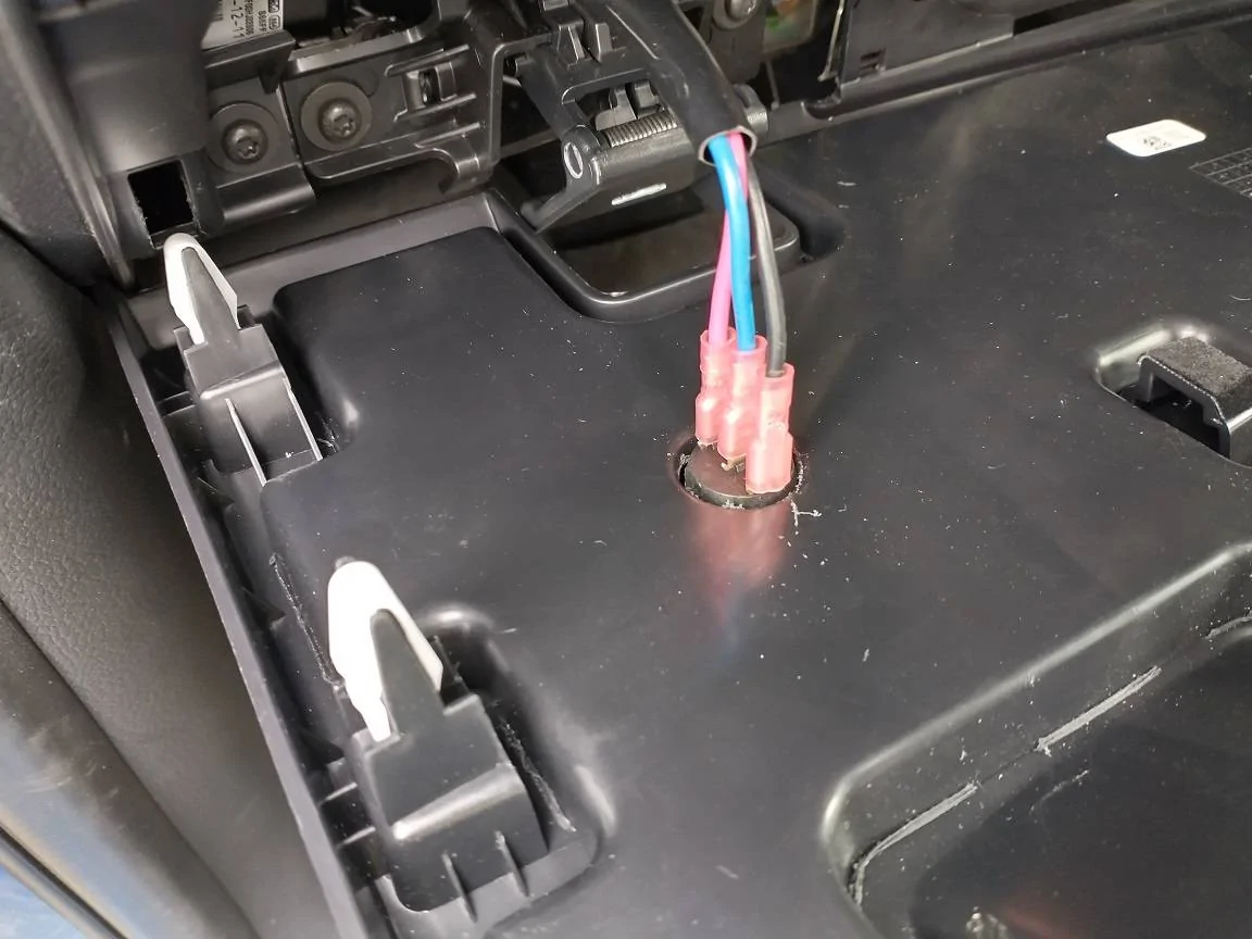

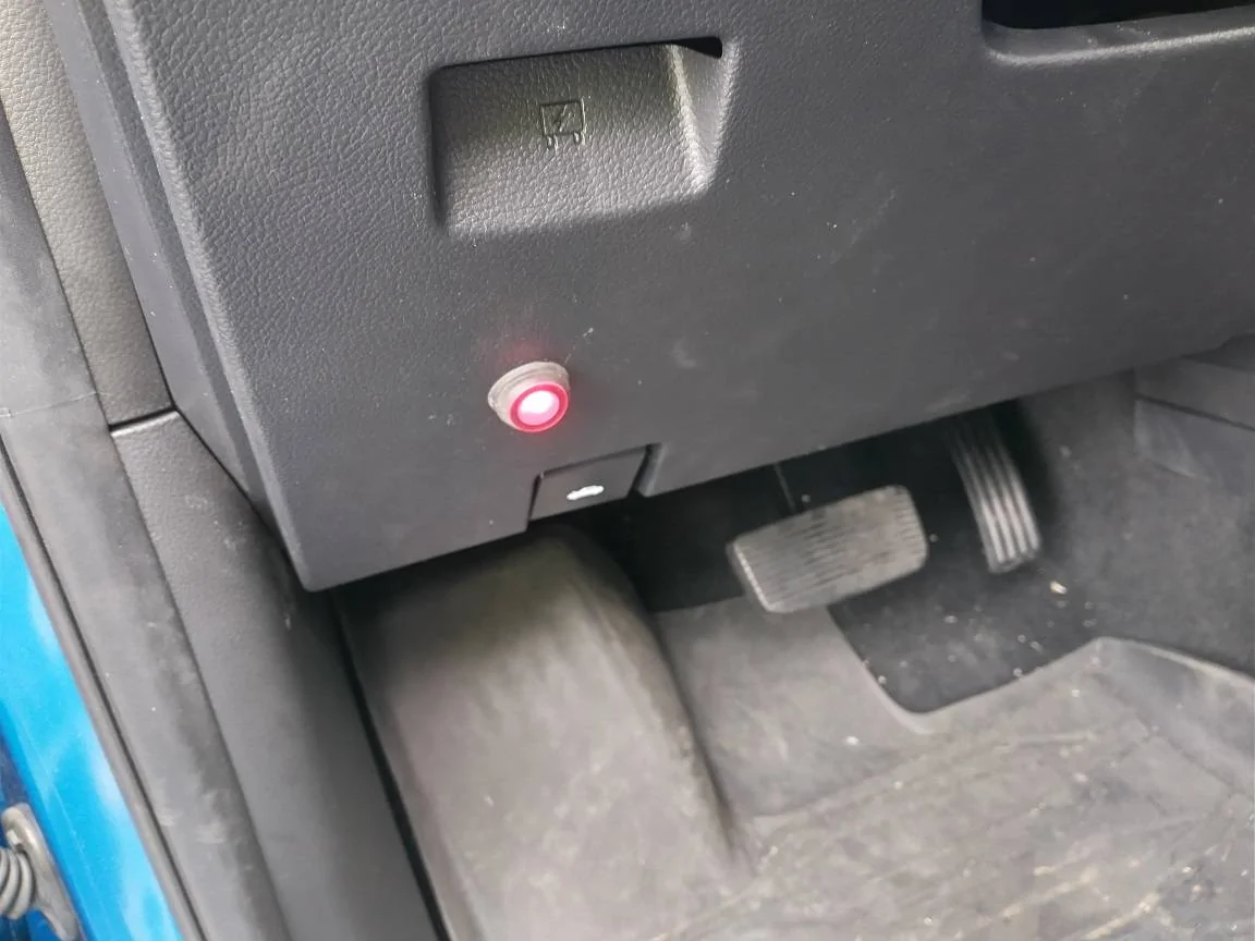

Then for the switch, I found a molded in hole in the lower panel under the steering wheel that was just the right size, just had to open it up and install the switch.
It's a little low, but still reachable. I don't use the lights that often anyways. Figured that panel is easily replaceable if I ever decide to undue everything.

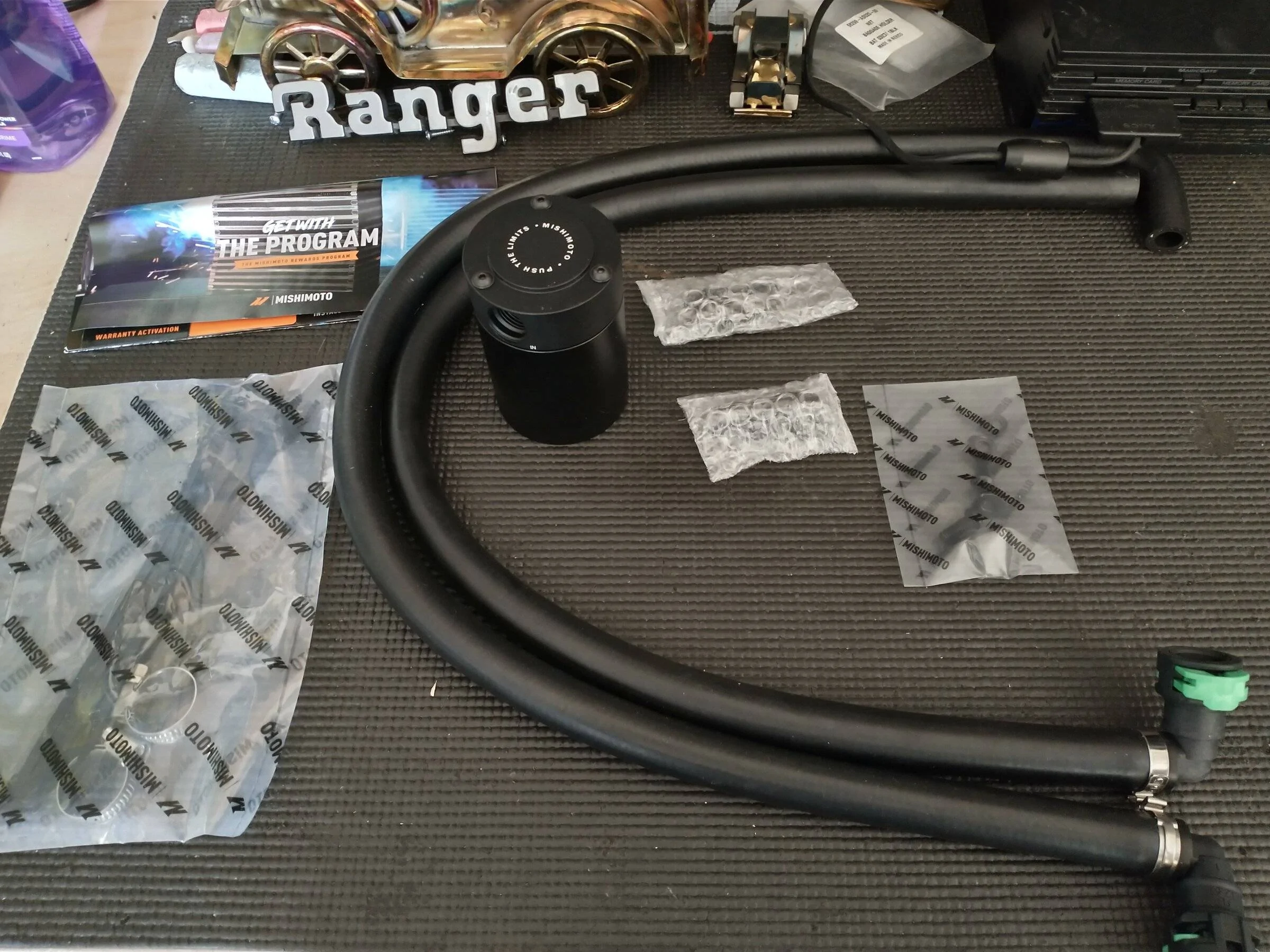

Not much to add to add other than i picked up a Mishimoto catch can that I need to install this weekend.
