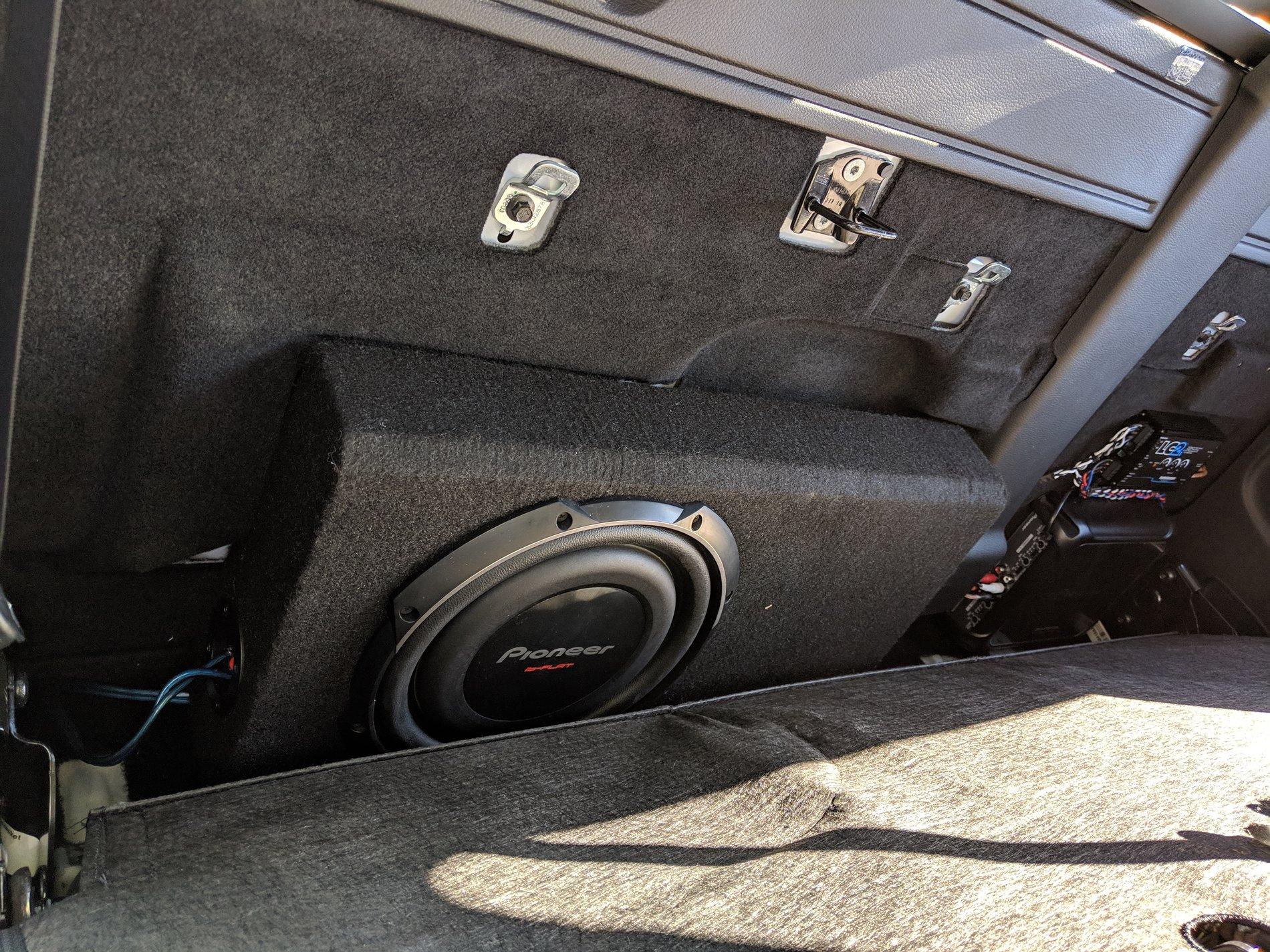

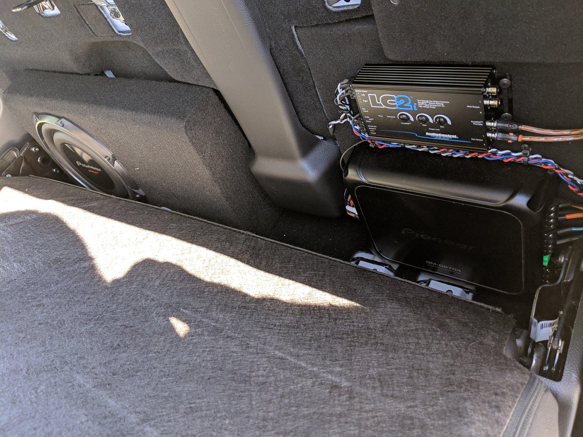

Yes. 10 inch shallow mount pioneer sub is all i was able to fit using a shallow wedge box also built by pioneer. Some carpeting had to be cut behind the box. See below.

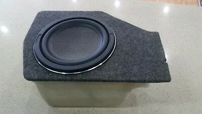

I contacted the eBay seller "baysideautostyling" for the dual sub box [crew-cab] regarding shipping costs to the USA in general.
They responded back they can ship to the USA & had past quotes of $300 for shipping. Ouch...
Waiting to see if there's one "local" in NA that might be fabricating one up for sale in the near future....

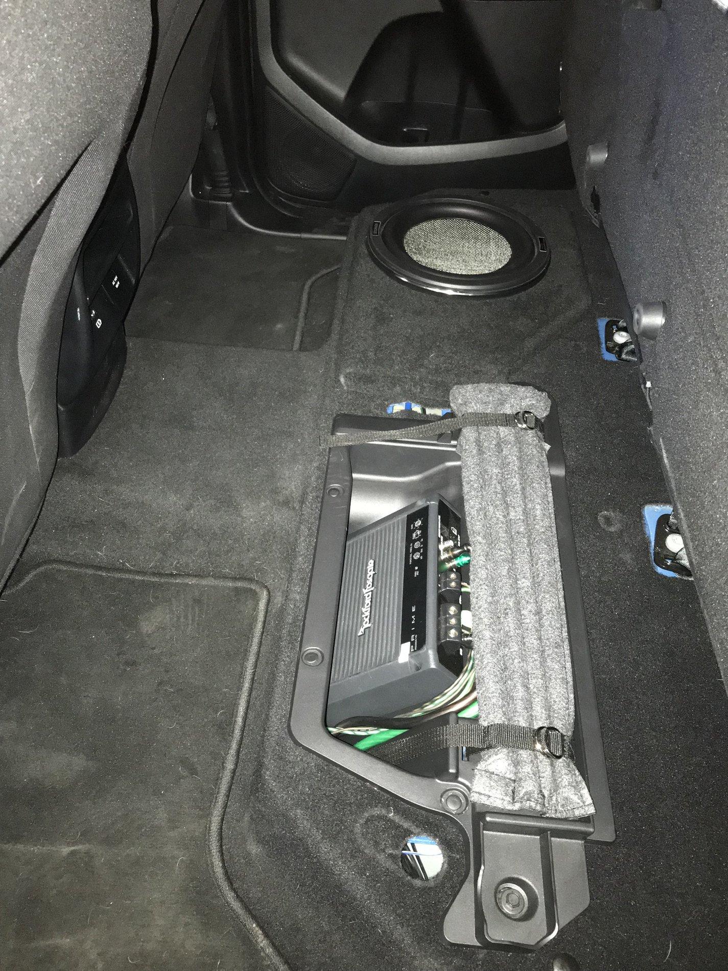

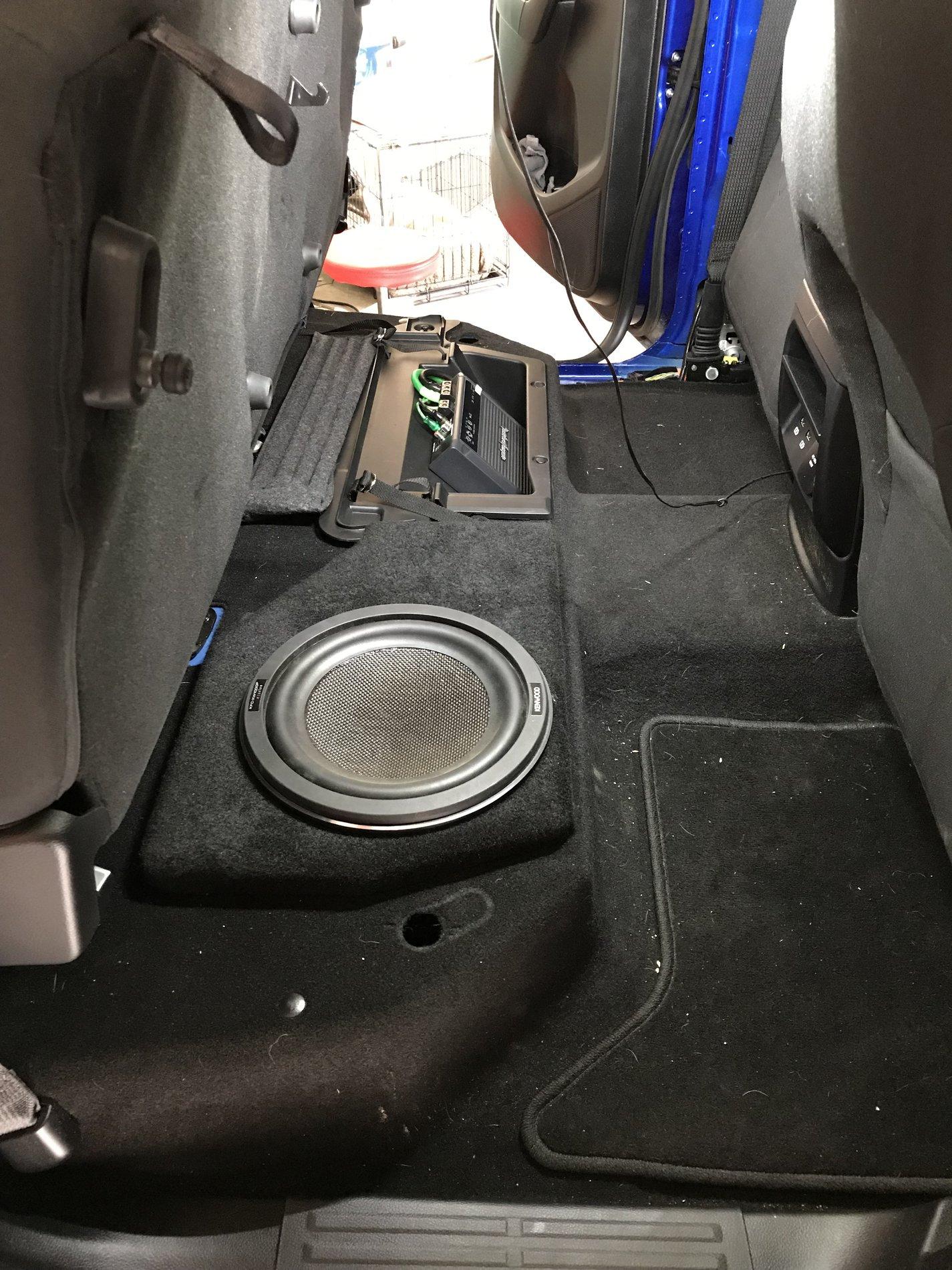

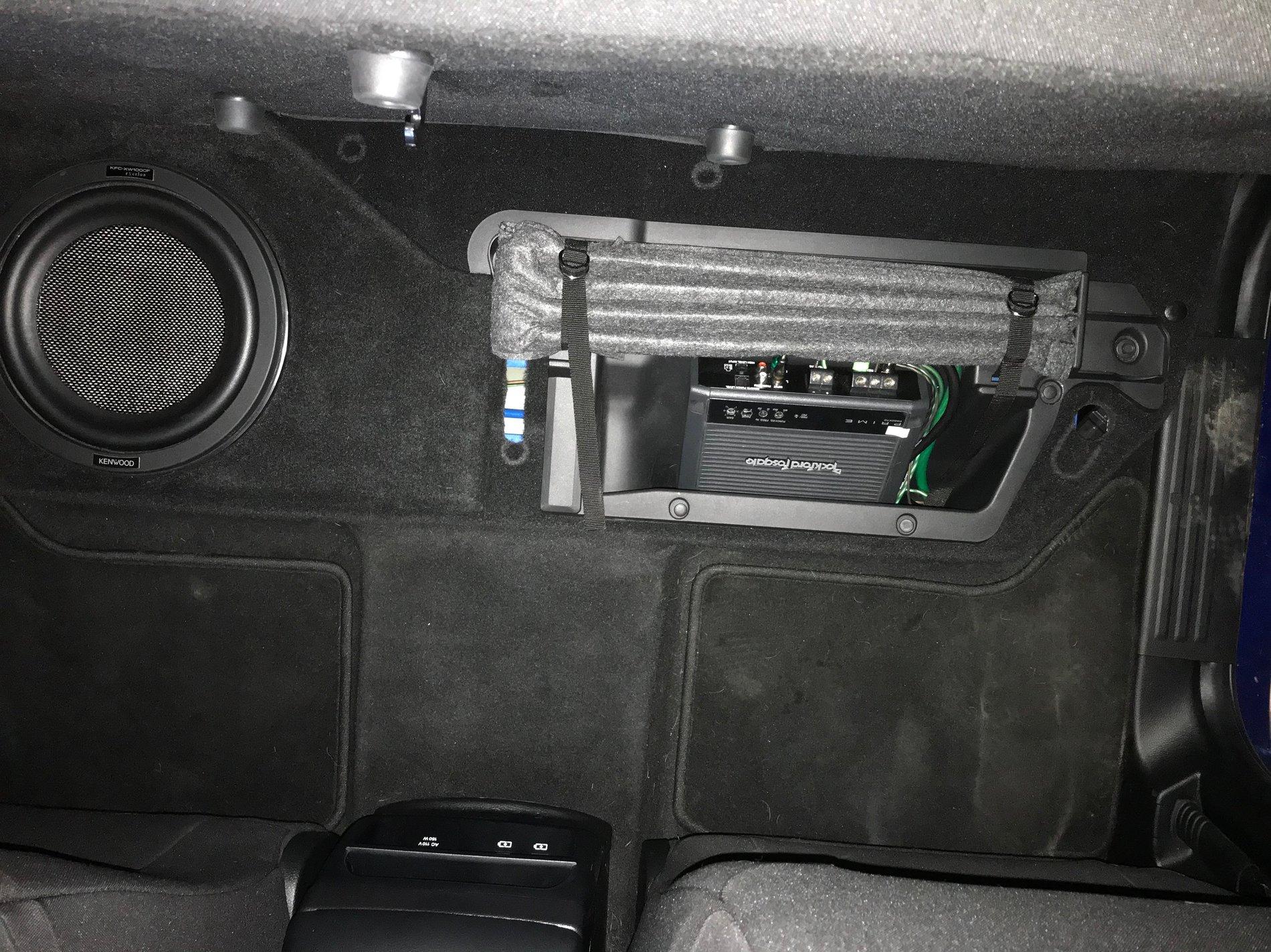

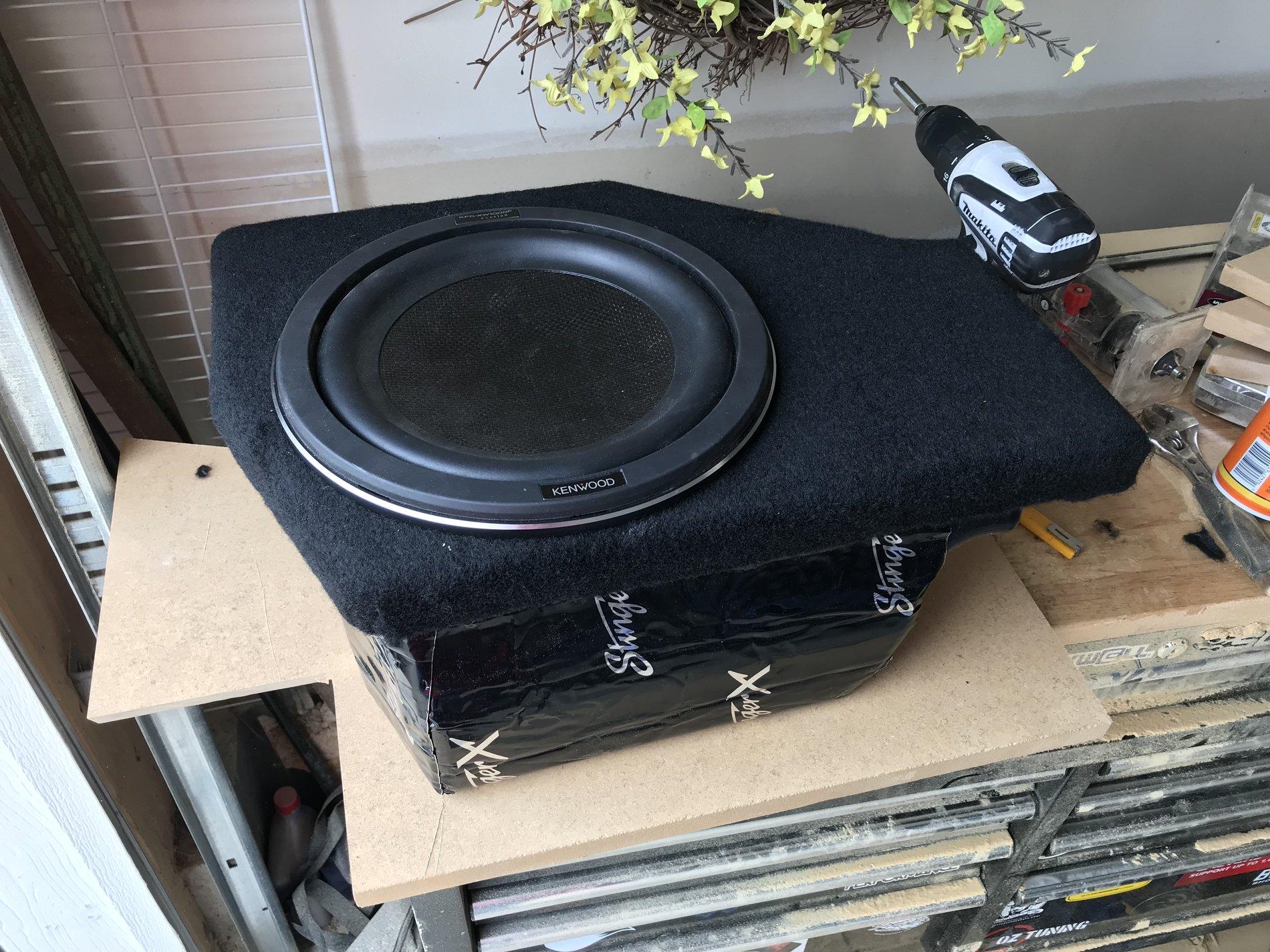

I ended up building my own setup. Using 3/4” MDF as a top plate and using the factory storage bin. I used a retro seal for sealing MDF to plastic with screws holding it together. Sound deadening inside and out speaker output connector sealed as well. Kenwood Excelon 10” with a Rockford Fosgate 500x1. I have had this setup for a while in Kenwoods own downfire box, which wouldn’t work in this truck so made this setup. Sounds clean and crisp. No distortion and the Excelon is perfect candidate as it only requires .6cu ft. Sealed or ported (which this equates to it almost perfect by my math) this is just a representation of an option and more than likely not always the best option! And yes it does clear the seat frame.

So for this I had the amp and subwoofer from previous vehicle. But on their own separately the sub is about $170.00 the amp was about $220.00, PAC in line converter for line level outputs $20.00, wiring kit $30.00, sound deadening $70.00, 3.4” MDF sheet (small hobby sheet) $10.00, carpet $10.00, butyl sealant $10.00, misc odds and ends screws wire crimps etc. $15.00. $555.00 total. But since I have the sub, amp, and input converter it was cheaper. I think it’s worth it.
I Will be installing this exact Subwoofer system (Minus the front speakers) I don't get too crazy loud. I will Update with my individual results.
