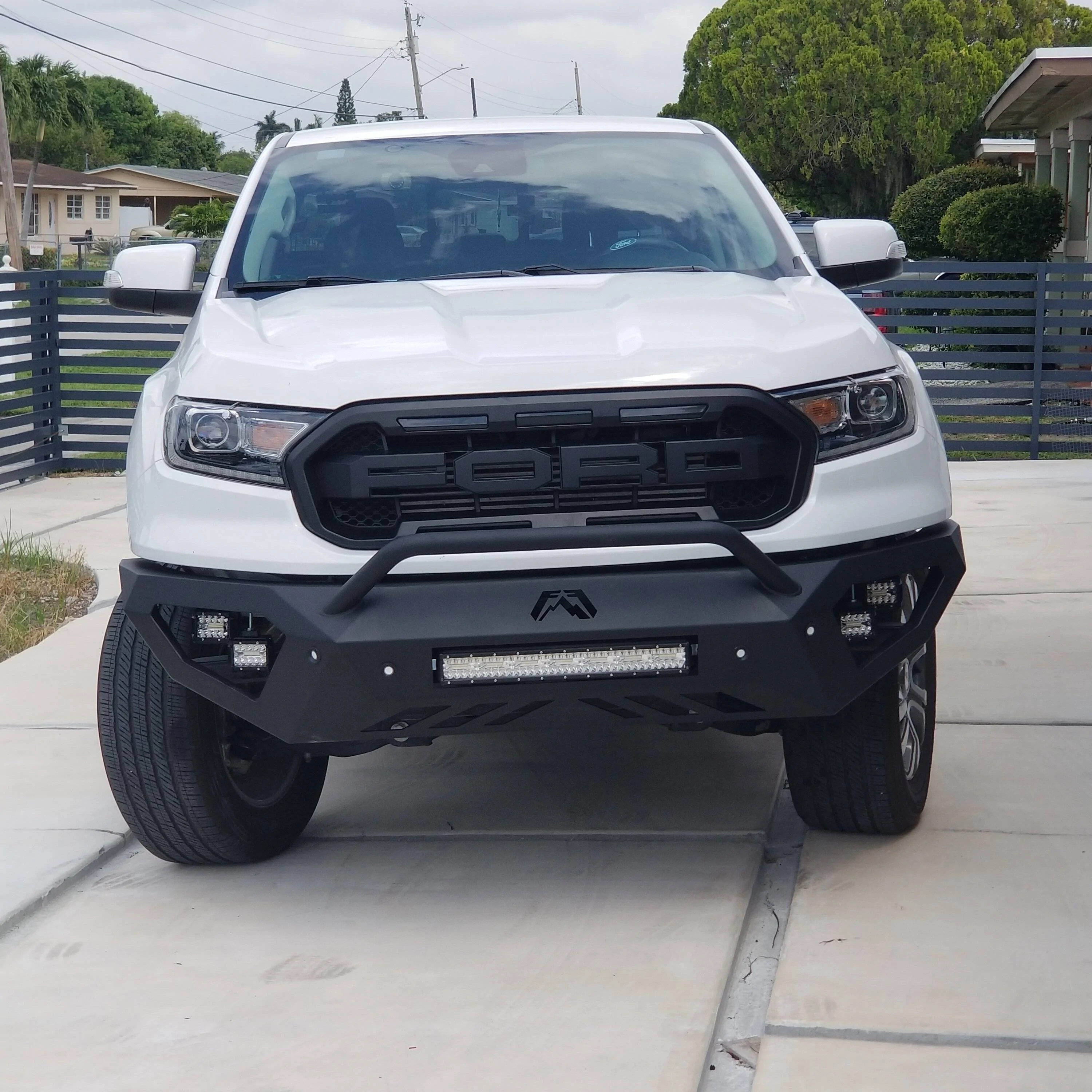

I placed this one from Fab Fours and it adjusted in the same way as the original, just change the sensors and place the desired lights. I bought the new one on sale at Amazon, but I have noticed that all the accessories for Ranger are more expensive than for other brands
xmartinez67
manuel
Apr 29, 2021
27
miami
Ford Ranger Lariat
ahh I forgot to reposition the frontal collision sensor
