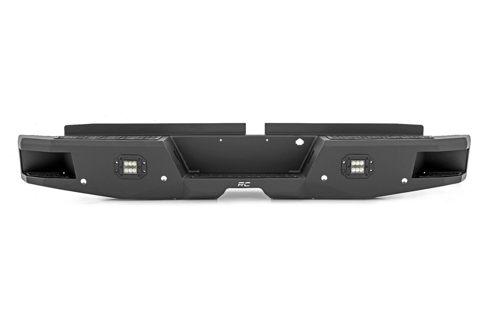

Almost back in business with this stupid phone crap. But here's the final install photos. Honestly for $400, this is ok for me. I had a twisted OEM bumper from a minor backup ding. I'm keeping the D-Rings off as they are pretty loose fitting and potentially too noisy for this mall crawler. Overall was it worth all the cutting and grinding for a cheap alternative? Let's just say it sucked but in a good kind of way.
EDIT....just for the record...the parts requiring alterations to make it work included:
1. Spare tire key lock had to be removed and replaced with a sensor dust cap from new bumper. Could have been bent and twisted but we settled for that.
2. Inserts for the sensors needed to be altered so they would stay put and accept the OEM sensors. Tricky stuff for a few minutes.
3. The OEM outer sensor iserts are painted and the inners are black to match OEM plastic.. So if you have awhite truck, the outers will be white. Maybe not a big deal for most but something more to think about.
Overall, the new pod lights really do a nice job as backup lights. The new license plate lights work better than the LED bulb upgrade I did since they do not wash out the backup camera at night like the originals.
