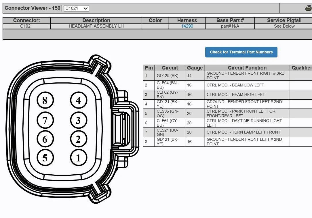

In need of wiring info for left side drl on headlight wrap around. Wire was cut going thru firewall during power install. Which under dash module does this wire go to ? Installer disappeared. I have run my own wire from front to under dash but can’t find any info to under dash to jump bad wire. Any info will be greatly appreciated.

I don't know what module it goes to but here's the diagram for the driver's side plug. Maybe you can trace the colors through the firewall

Goes to BCM, Pin 40 on connector C2280c, keep in mind that the BCM provides internal circuit protection (FET) for the individual exterior lights. You might need to do a BCM reset
C2280c - is the top middle connector on the BCM above the IPC Fuse box by your left knee
With Meter:
Note: To check DRL, place truck in (Neutral) and SET parking brake, DRL will not power in park
Pin 6 to Body Ground (voltage) this will check if you have power to connector
Pin 6 to Pin 4 (voltage) (This will ck ground circuit) wiring (Pin 4 is the ground pin for DRL)

To check Left DRL circuit, disconnect connector at LH headlight C1021, set up system for DRL to operate.
So, engine running and the following.
Full Daylight, shining on dash, (will not work if low light condition and headlights are commanded on)
Headlight Switch in (Auto)
SET PARKING BRAKE!!!!!
Place Truck in Neutral (DRL's operate in any gear position except park)
At the Headlight Connector (C1021)
With a Multi-Meter check for voltage at Pin 6 and any good Body Ground or Negative Post on Battery - should have 12 Volts. This checks Pin 6 wiring.
Note: Most Meter Test Probes are too big to fit into the connector, I have my own homemade test leads, but you can use (If you are very careful and gentle) installing them into the connector use either a paper clip or a sewing T-Pin, and alligator clip to hold the probe onto the paper clip or T-Pin.
Next check for Voltage between Pin 6 and Pin 4. (Pin 6 = Voltage) & (Pin 4 = Ground) at Connector C1021
Should Have 12 Volts

Check for (Ohm Reading) between C1021 Pin 6 and C2280C Pin 40 (Harness Sides)
Should be about 3 Ohms.
This will confirm bad/broken wire in that run, if (0) some meters display (dash lines) then wire is broken or open.
If greater then 3 Ohms, then you have damaged wire with broken strands.
Now for you wire run - C1021 (Headlight Connector) Pin 6 = Grey Wire w Blue Stripe)
The wire color does not change at BCM Connector) C2280C Pin 40 same color Grey Wire w Blue Stripe) Note: This is a 20 Gauge Wire, ensure you run matching wire gauge, the lighting circuit is very picky, and the wrong gauge wire might create issues.
