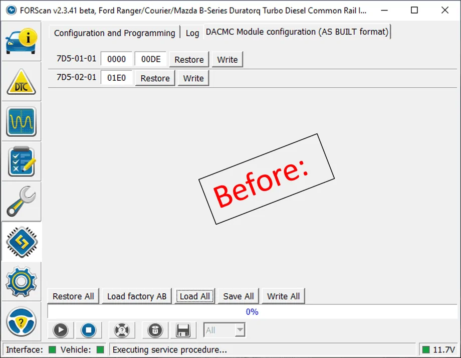

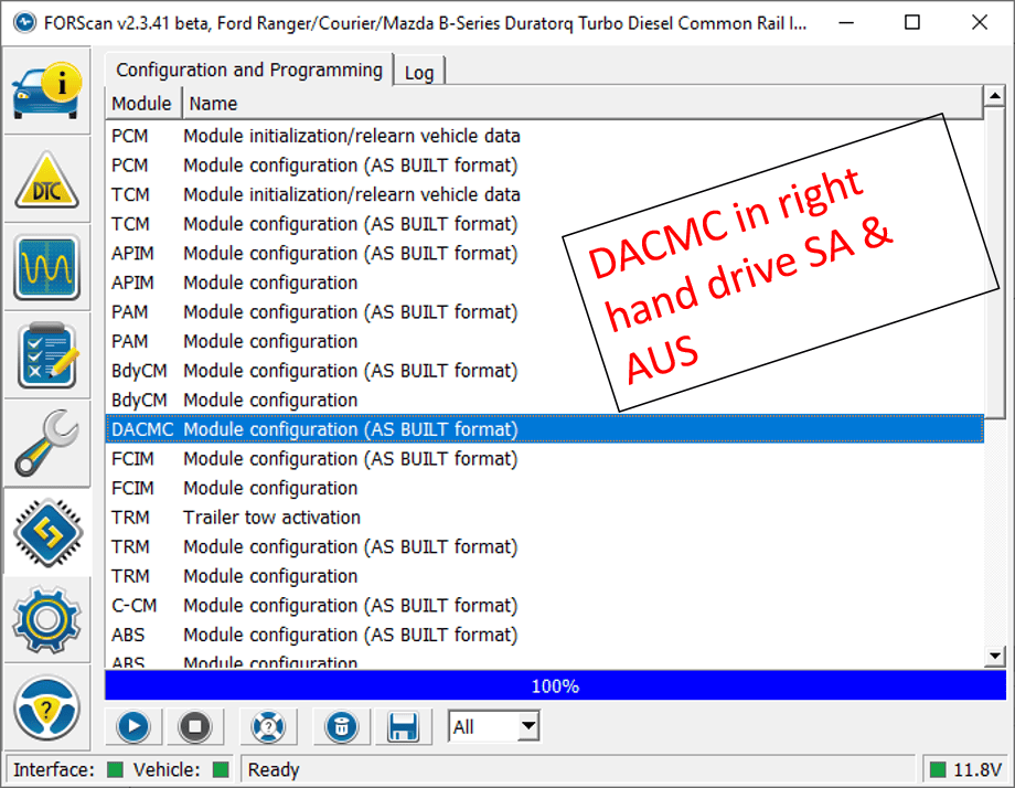

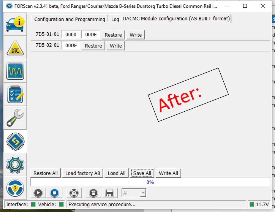

Hi,
I managed to switch off the fake engine noise in the '20 Ford Ranger Wildtrak 4x4 2.0 BiT D/C RH drive using Forscan and OBDLinkEX (recommended by Forscan). RH drive units seem not to have the switch avaialable, HEX code to be adjusted. See images attached.
Hope it helps!
