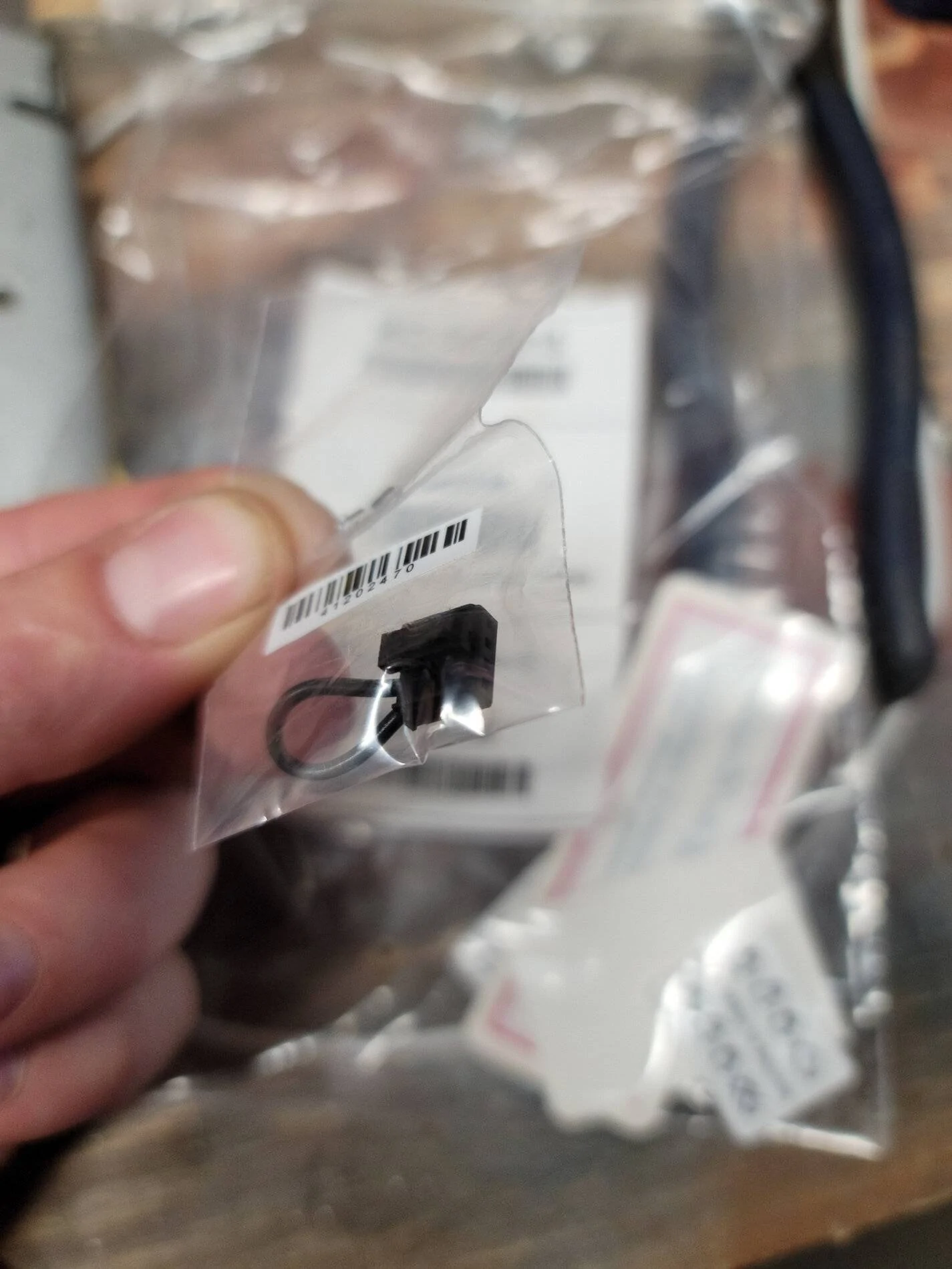

2020 XL STX. I purchased the perimeter plus module with Fordpass points. Alarm was plug-n-play but...
LOCK-UNLOCK-LOCK=START does not work.
It's mentioned in the perimeter+ module description, this feature is enabled "when activated by a dealer". I assume the dealer would use IDS to do this. They quoted me $199 to "reprogram a module". ?
Can I do it myself with Forscan?

saw this on another forum. Not sure if they are the same but it talks about some needed jumper
https://www.fordforums.com/threads/...imeter-plus-installation.309894/post-50593365

Bingo!
I plugged this sucka into the port on the module and she fires right up with the remote!
Thanks Mr janitorjim Sir. You're a legend!

Here's what I used, instructions for the install on a Ford Edge. The gateway module on the Ranger is at the bottom left of the kick panel, instead of the location shown in these instructions. Disconnect the wiring harness from the back of the gateway module. It's a bit tight back there, bring a light. The tee connects to the wiring harness, the gateway module, and the security system module. I zip tied the security module to the dash frame but found the impact sensitivity was too low. I snipped the ties and just placed the module in there, sensitivity about halfway and it works great.

Thanks you and you all for the info. It took me 20 min max to install the perimeter plus. I disconnect the cable on the back of the OBDII connector and connected harness one side and the other on the module and also connected the jumper. Thats all I did and both remote start and shock sensor is working now. I just adjust the sensor to the right level and all good to go.
