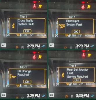

I have over 60k on it now, havent changed the oil in 40K two years now I have 2 or 3 heads up notices I click ok on too, when it was new the drivers side mirror was damaged on the lot and it was replaced by the dealer with a cheap one that didnt have the yellow led light side warning and the tail light was replaced and never programed, the body shop told me they told me they tried to reprogram it but couldnt I havent tried its not a big deal since everything still works and I dont want to take it to Ford again and pay to have the brain reprogrammed, my tire pressure warning just started too but tire pressure is fine

Hate to say it. Just turn it off and back on. Unfortunately as computer dependent as they are, they have glitches sometimes. All of my rangeres have glitched :( but all ended okay afterwards. Just a problem if it stays not working.
