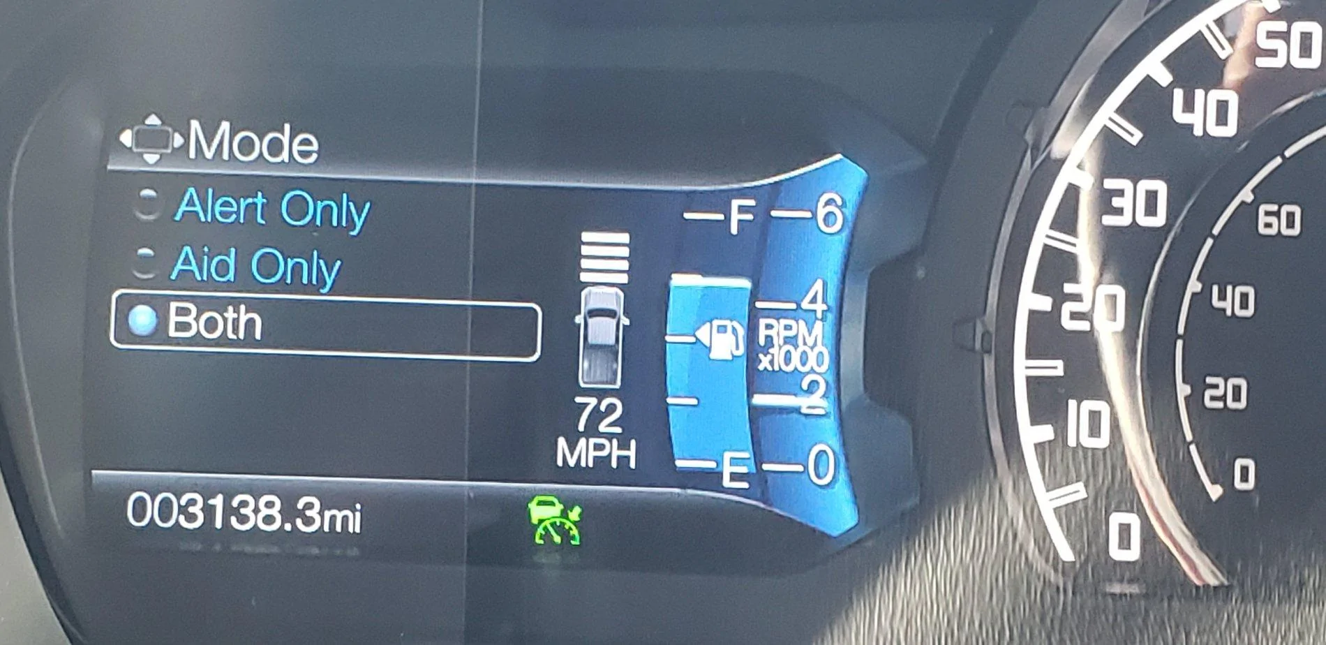

I have my system on with Alert+Aid and intensity set to high. However I have never felt the steering wheel vibrate. Is it just really subtle (drowned out by road feedback) or should it be a very noticeable?
Hi Mo
When you change settings using the wheel, you should get immediate feedback through the steering wheel.
Also, is your forward camera free and clear? Any heavy tinting?
Good luck!
