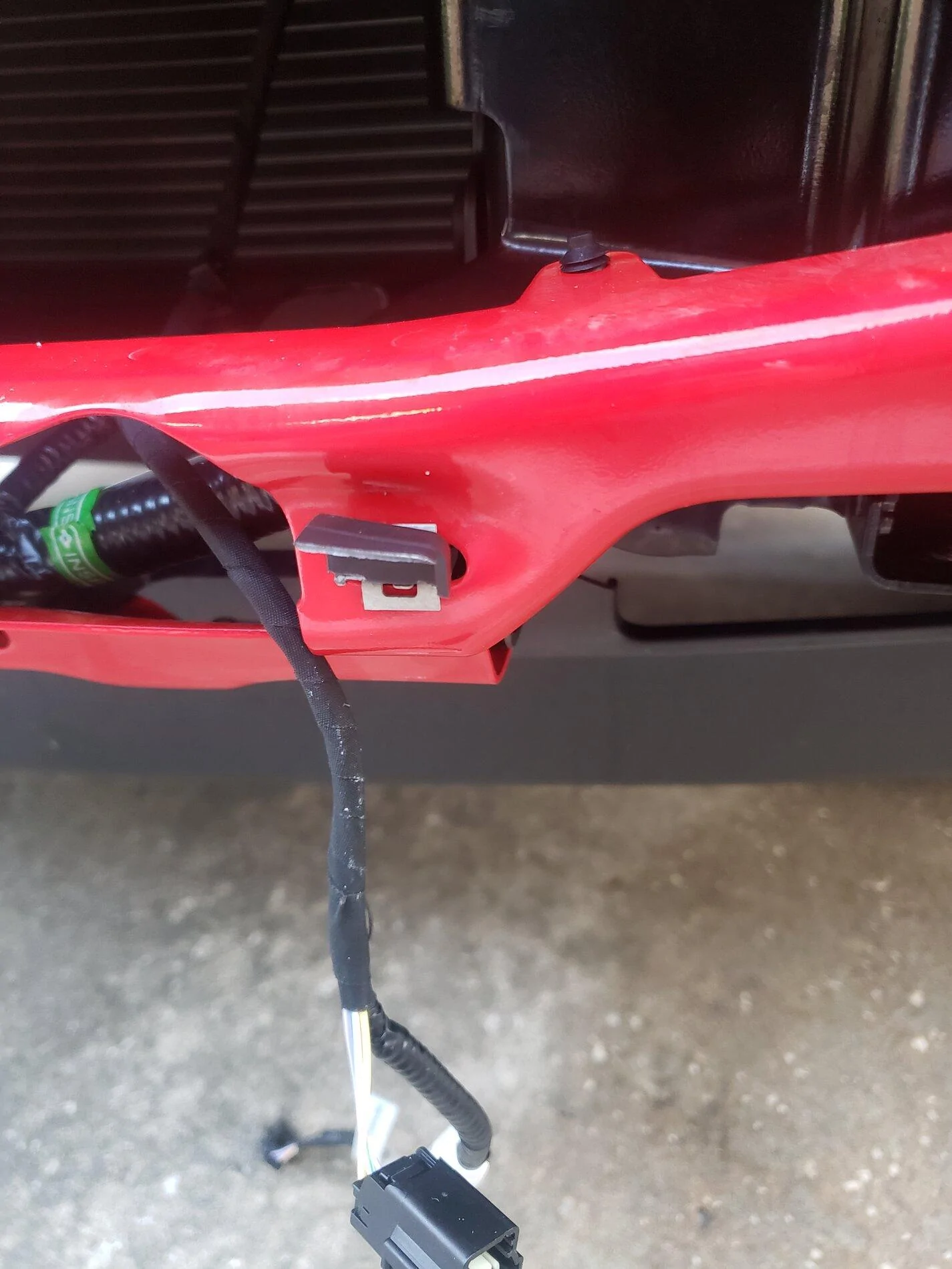

Hard to tell from the angle, but it almost looks like there is enough room to slide the hook loop through the slot from the back and bolt it to the frame, but I'm sure you have tried 10 ways to Sunday by now. Is the slot not large enough or does the frame rail not align with the slot or both?

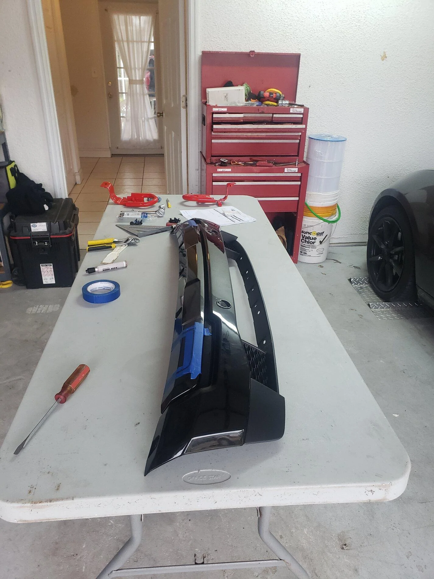

The slot is 3/4" below the rail. It looks like I will be attempting surgery on the lower valance. I am terrible when it come to cutting things in a straight line. If I mess it up, a 2020MY valance will work, I would just have to paint it to match. I will wait until I am in a better mood before I attempt to do this. I will probably mark the valance while on the truck, then remove it and cut it on my work bench. If I am successful I will post pictures, If I am unsuccessful I will post tears and $ signs.

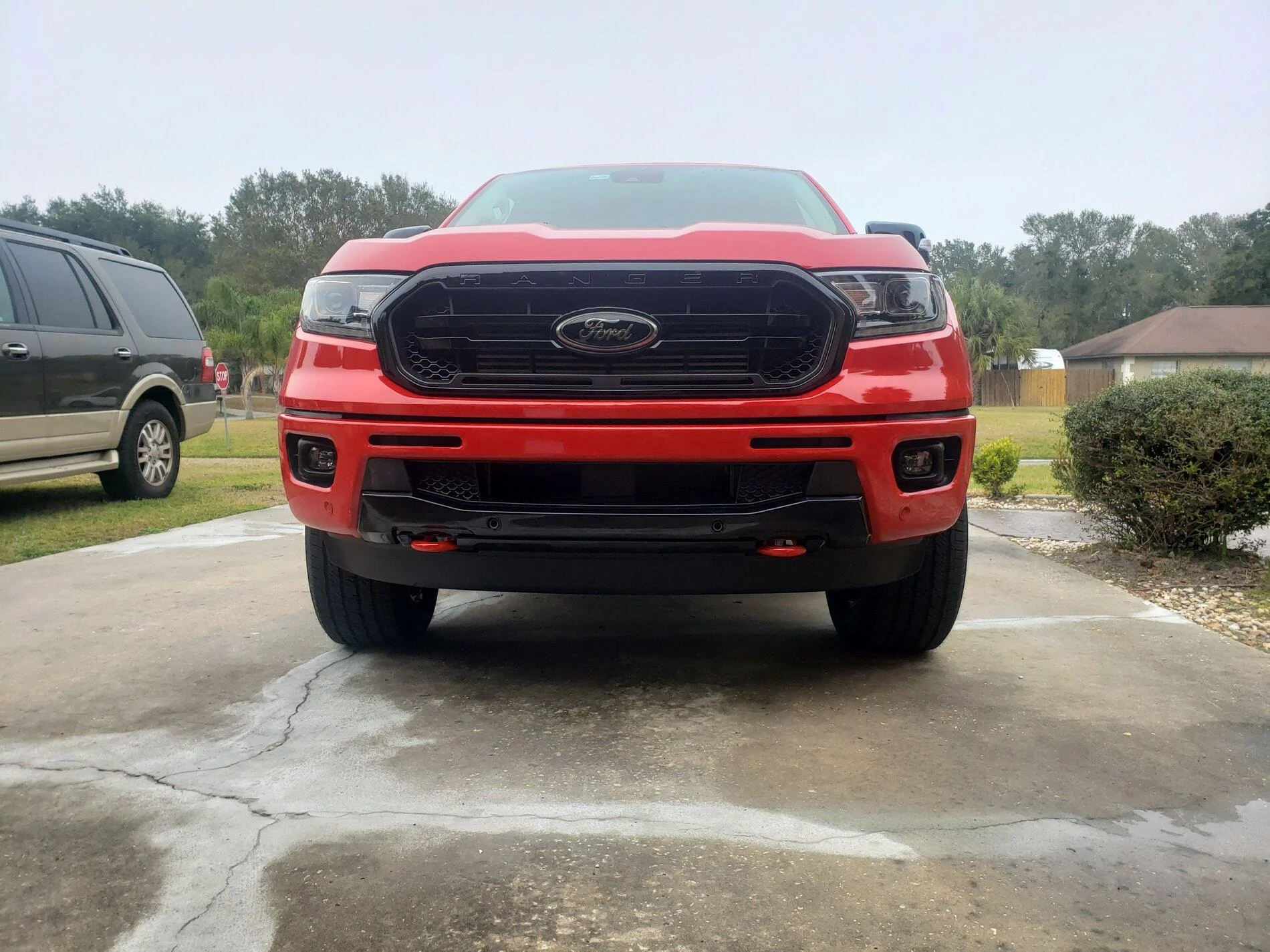

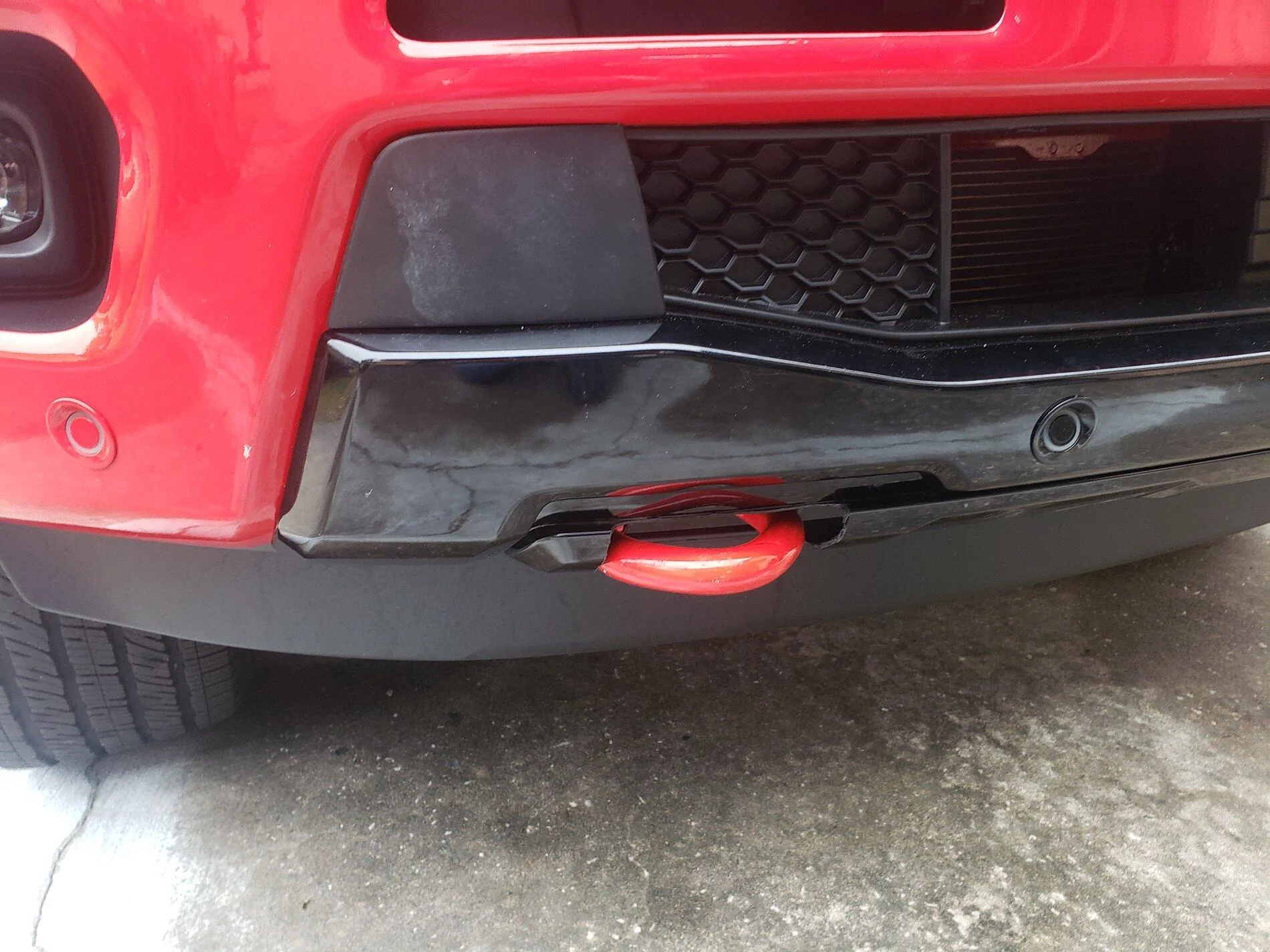

Success, only 2 small tears, Nicked the paint and broke a tab removing the valance.

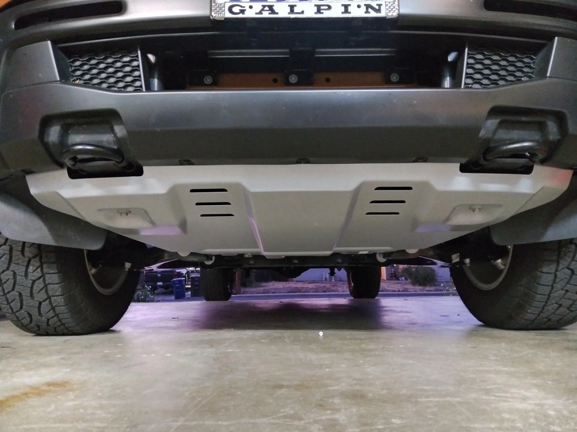

I have a 2020 FX2. It did come with Tow hooks, but they lack the bracket needed to install the front skid plate. the one's you got are 4x4 hooks, and will alow you to install a factory skid/bash plate if you want. I Removed the fake plastic bash plate, installed 2 4x4 (like yours) tow hooks, then installed the factory steel bash, and trans plates. the Frame is tapped for the bash plate bolts so you should be able to add on as i did. C.
Might have to sprng for a 4x4 front valance as well. or get a junk yard one.
