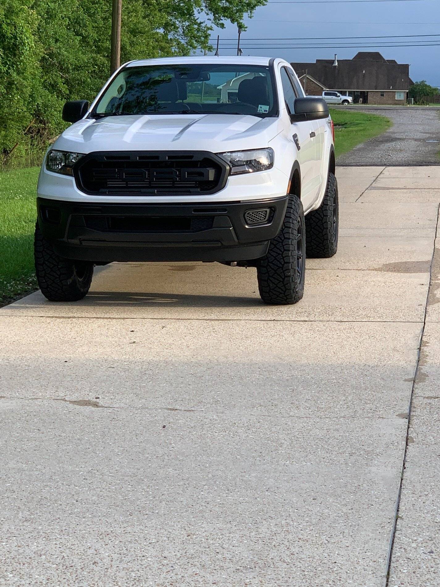

Interested in the same thing. I have the base model XL(vinyl interior), without factory tow hooks. Never really needed them yet, but I am thinking about ordering a set. I planned on taping up and using a Dremel to notch out a slit to pass the bracket through.

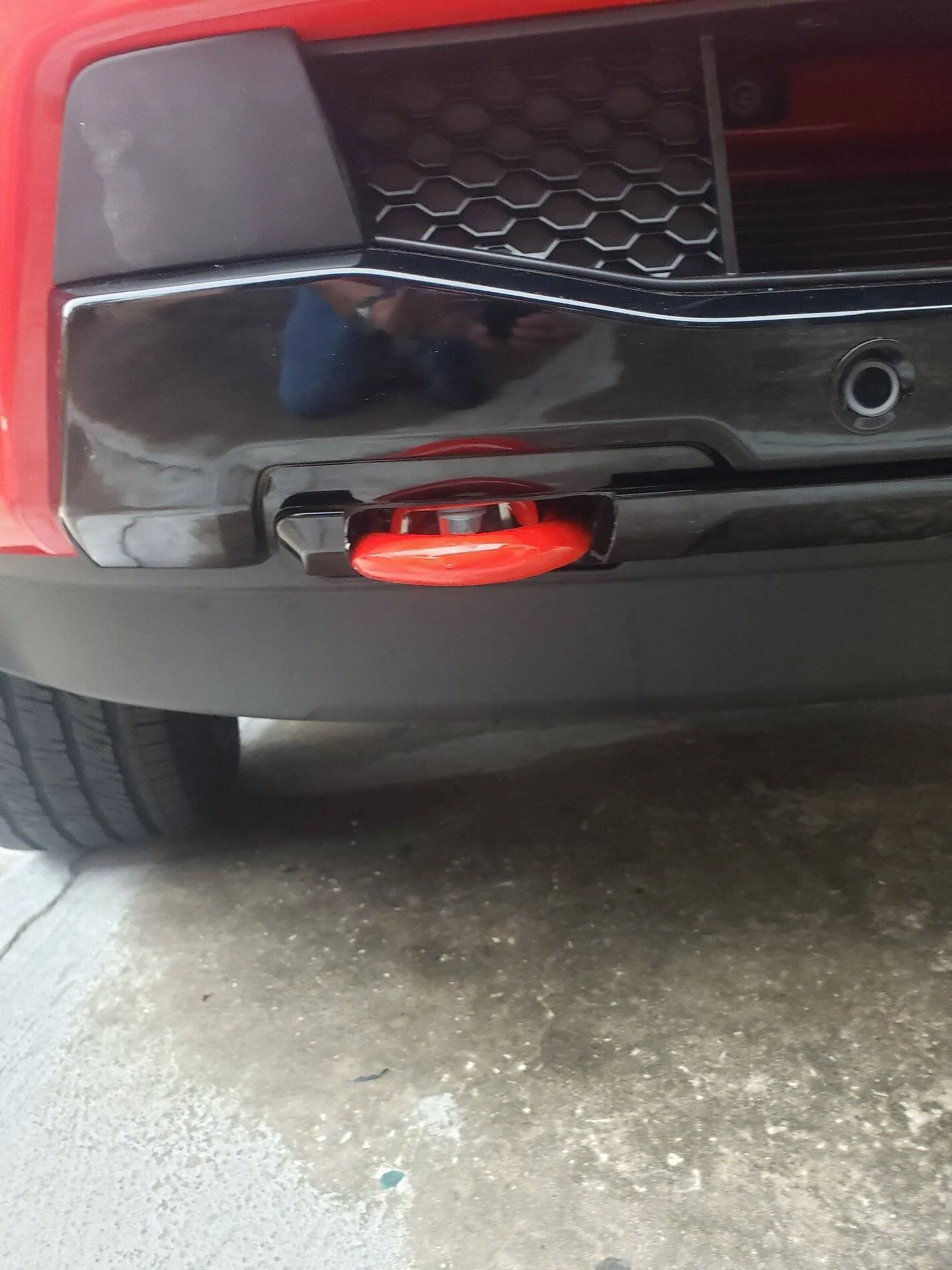

I can answer this question. I have an XL too and have installed 1 of 2 from tow hooks using the factory XL valence. You can do it with a Dremel and a hacksaw blade, but it is a pain in the butt. Took 2.5 hrs but I took my time to keep the final product from looking like Fido’s butt. Turned out well and the second tow hook I should be able to do in 1.5 vs 2.5 hrs now that I know what I’m doing lol. I’ll be back to my truck on Wed and see about snagging some pics for this thread. I did not need / use the rubber surround on the factory tow hooks. It won’t work with the XL valance.

The hard part is removing the lower valence, there are instructions elsewhere in this site. please use plastic or nylon tools to remove the valence. metal tools will damage the paint. I also used painters tape to layout and mark where I intended to cut. I used a Dremel to make the cuts and clean it up. This was a case where sometimes a little more is better then not enough.
The clips holding the valence on are very fragile, expect to break a couple.

Yes, I did not have the rubber so I kept the hole small. you can use the rubber as a template to mark where to cut. I would also look at one that has the hooks to see how big that space actually is.
Once the work is complete. Post a updated photo please. I might have to get the rubber boots and update mine.

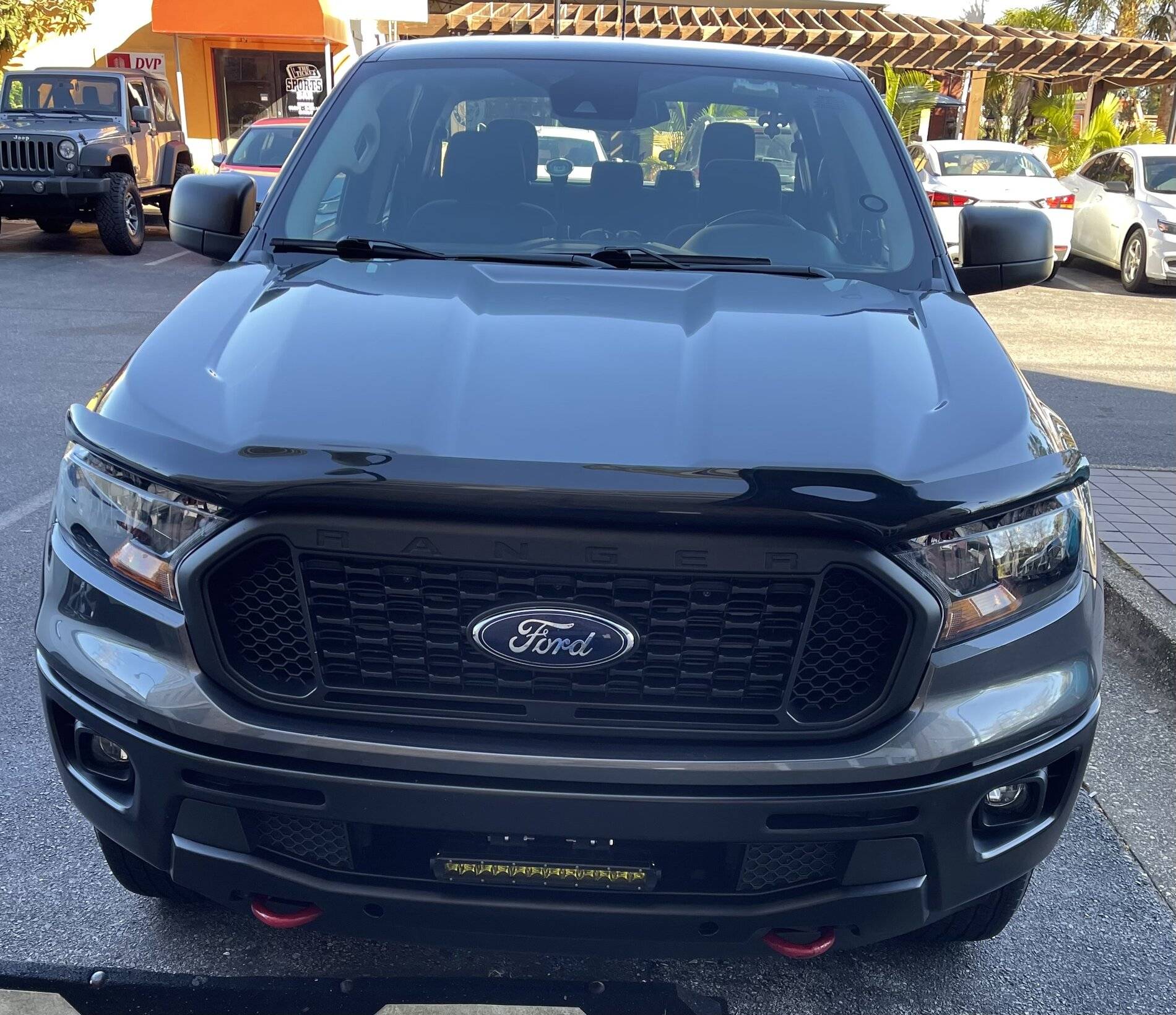

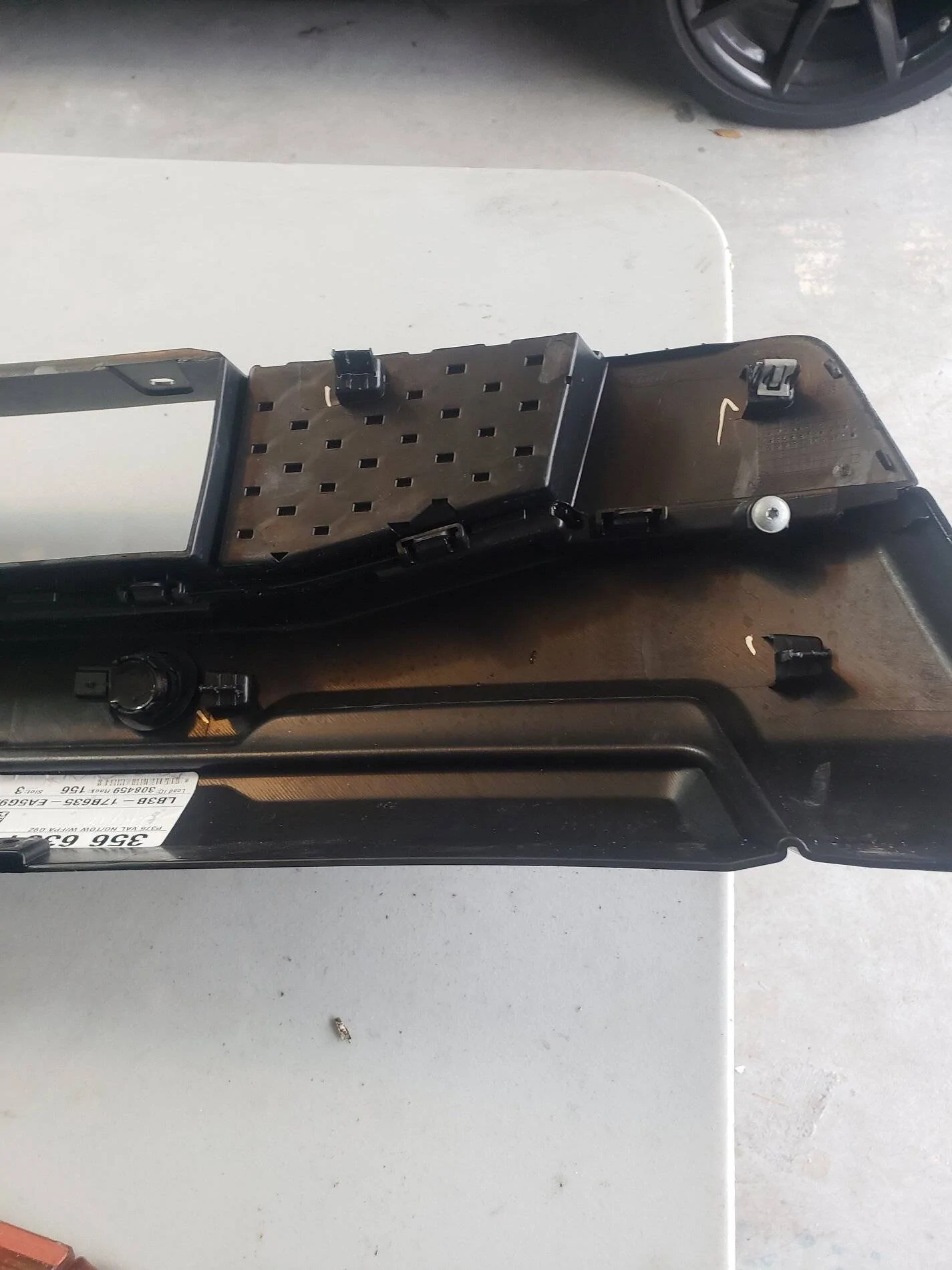

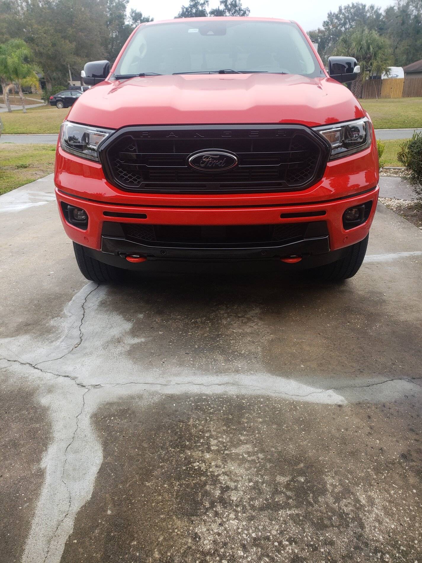

Well I went a different route i bought a lower valance off the Forum from Nurse Neil a Big Thanks to him. I did have to trim some of the lower air damn though. Since I don't have the parking sensors I do have some hole plugs coming to cover the holes.
