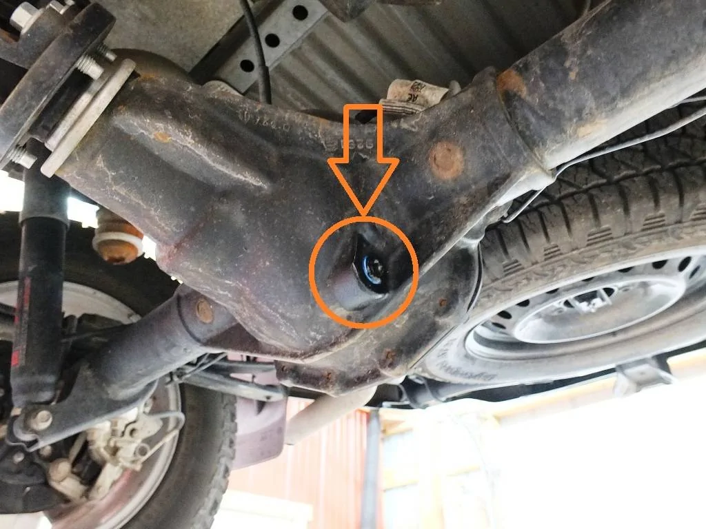

Are you sure?
If you look at it from the rear it only appears there is a fill plug
However, if you look underneath on the driver side you will find a drain plug
Just did mine

Wasn't this a deleted item on newer models?
Don't know for sure...my 2021 has a drain plug. All it takes is a few seconds to bend down and look.
Yeah my 21 has a drain plug. OP has a 22 and guessing the drain plug is gone.

Late 21 here; it vanished. Mine is almost a 22. I put pictures to prove it is missing in another thread. You can see where it should/could be... but nope no drain. The service manual changed super late 21; guessing that date is when some of the changes started.

My '22 XLT doesn't have the drain plug. Replaced the gasket when I changed the fluid. Gasket was cheap enouogh!
