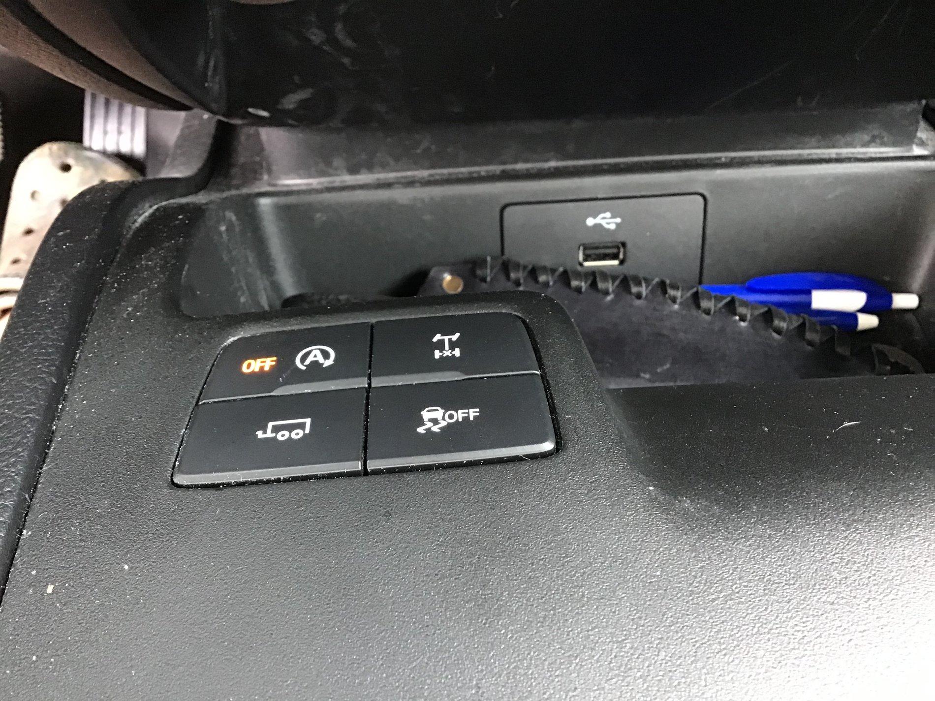

Where would the icon show up on my dash? I'm like 99% sure that I've got an open one wheel wonder back there
By the shifter...front right icon, looks like an H..next to the dirt LOL.

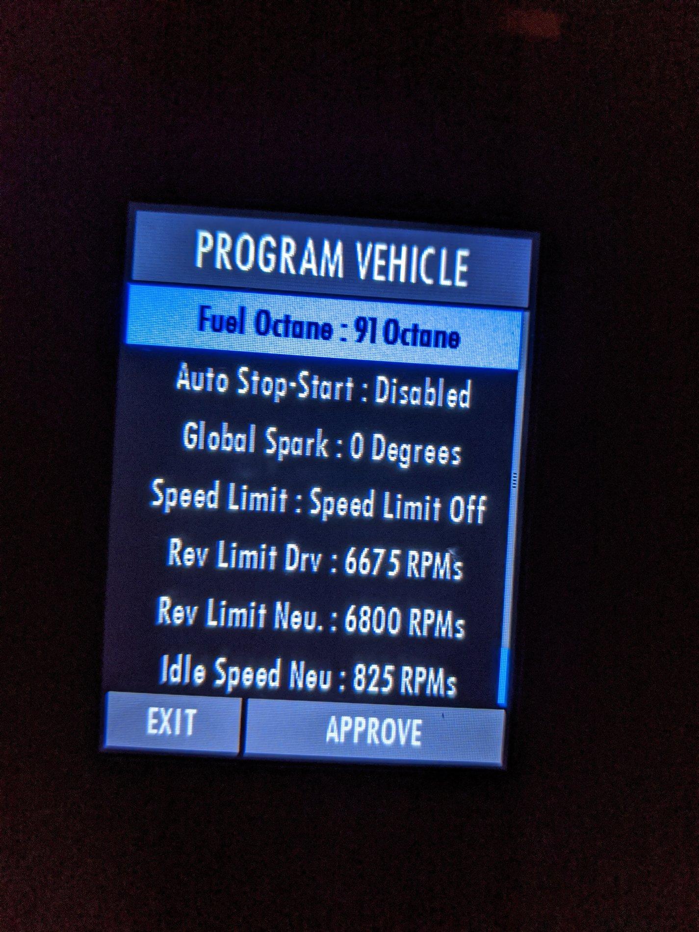

Ok, some interesting results on the built in tune. Curious to see if you've had similar results Doc. The only things I changed in parameters was the octane to 93, auto start/stop off, removed speed limit, and upped the Rev limit in N and D to 7075 and 7100 which should only be about 400rpm above the stock limit so that shouldn't be pushing any limits.
My results after taking her out for a spirited joyride. Drive seems to hesitate between 2nd and 3rd gear, after that, it runs great and everything feels good. In Drive, WOT feels great, good pull nothing too strange to report. Now, I put it into Sport, that's where things get eerie to me. Launches are great, both rear tires break loose in 1st and 2nd, great pull from 1st to 6th gear. Doesn't seem like it wants to shift past 6th gear. Now here's what's making me feel a little uncomfortable, if I mash the throttle and take off, I'll pull great from lets say, 1st to the top of 3rd and then let off the throttle completely, I get an awesome BOV sound, but a horrifying transmission jolt. Like someone just smacked into the back of me bad. First time it did this, it scared the shit out of me! I tried another throttle dump in Sport and same thing. I ended up flashing back to stock to start the process over again. Any insight? @Doc

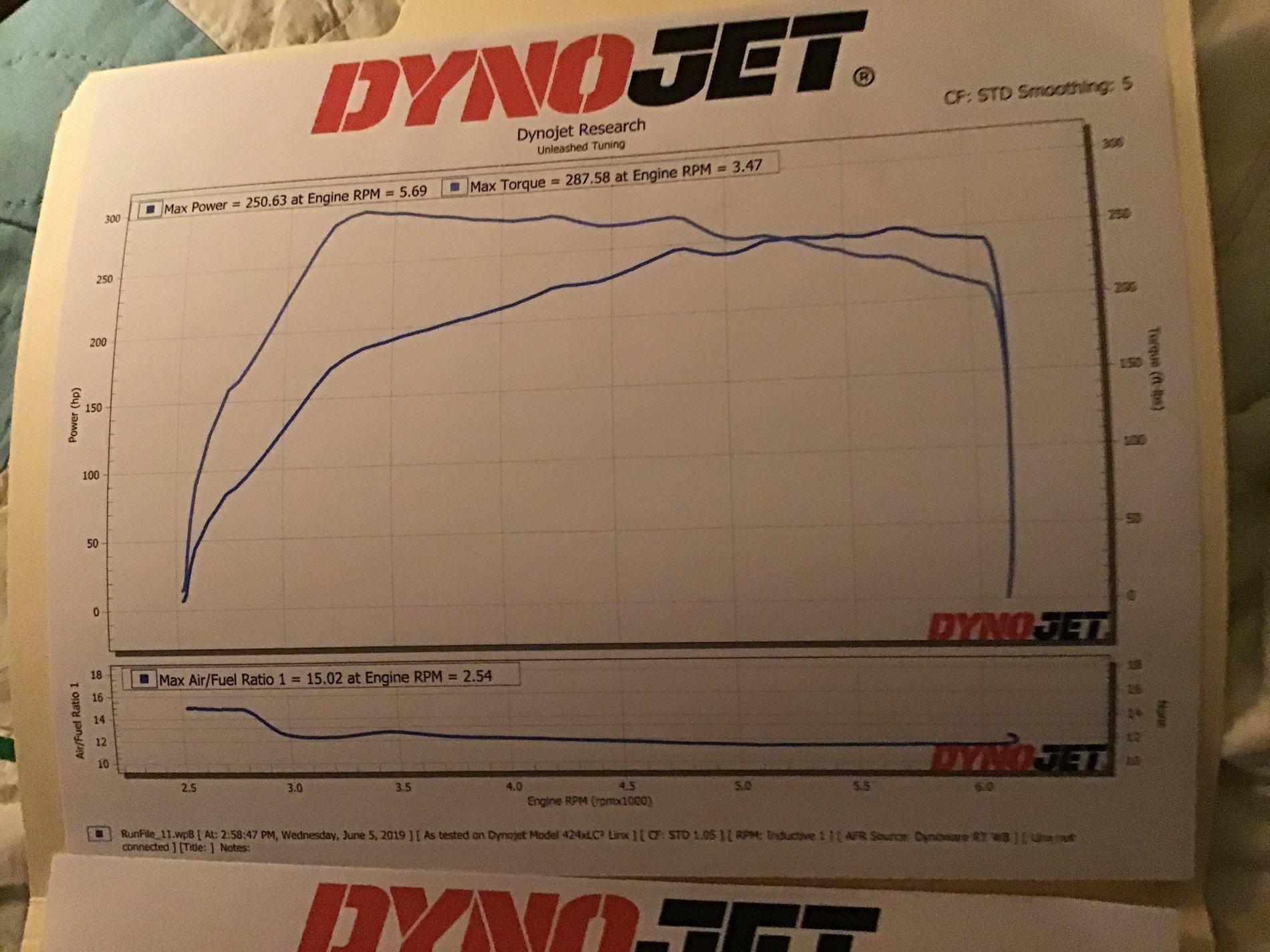

Datalog it and send it to Torrie..He will adjust it. I have not had similar results as my truck was their R&D truck and it was tuned and dyno’d by Torrie. Those high rpm changes are not necessary as it makes its torque at 3000 rpm.
Regards.
EDIT: LOOKING AT THIS...I noticed I sent the stock Dyno report, will post the tuned report below.. Regards

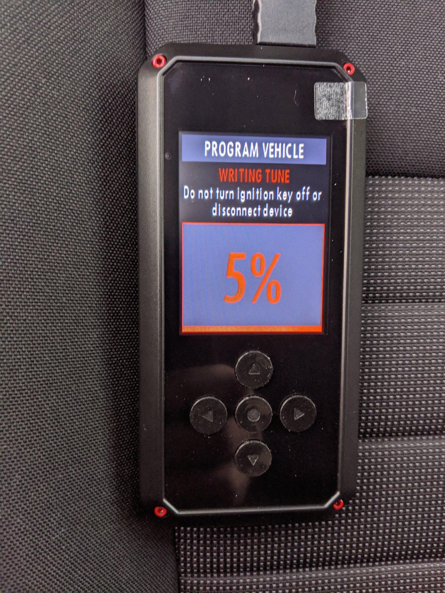

In the meantime, I'm flashing to the same time but changed a few settings. I had to fill up with 92 today as that's all they had available so idk if my AOR is off a little now. Another strange thing, I forgot to sync my stock file to the cloud before flashing over the new time, I was able to flash back to stock but when I go to the device settings and try to sync my stock file, it says I have to flash to stock first even after I already did. I hope I didn't mess anything up >_< I'll post a picture of the tune I'm flashing now.

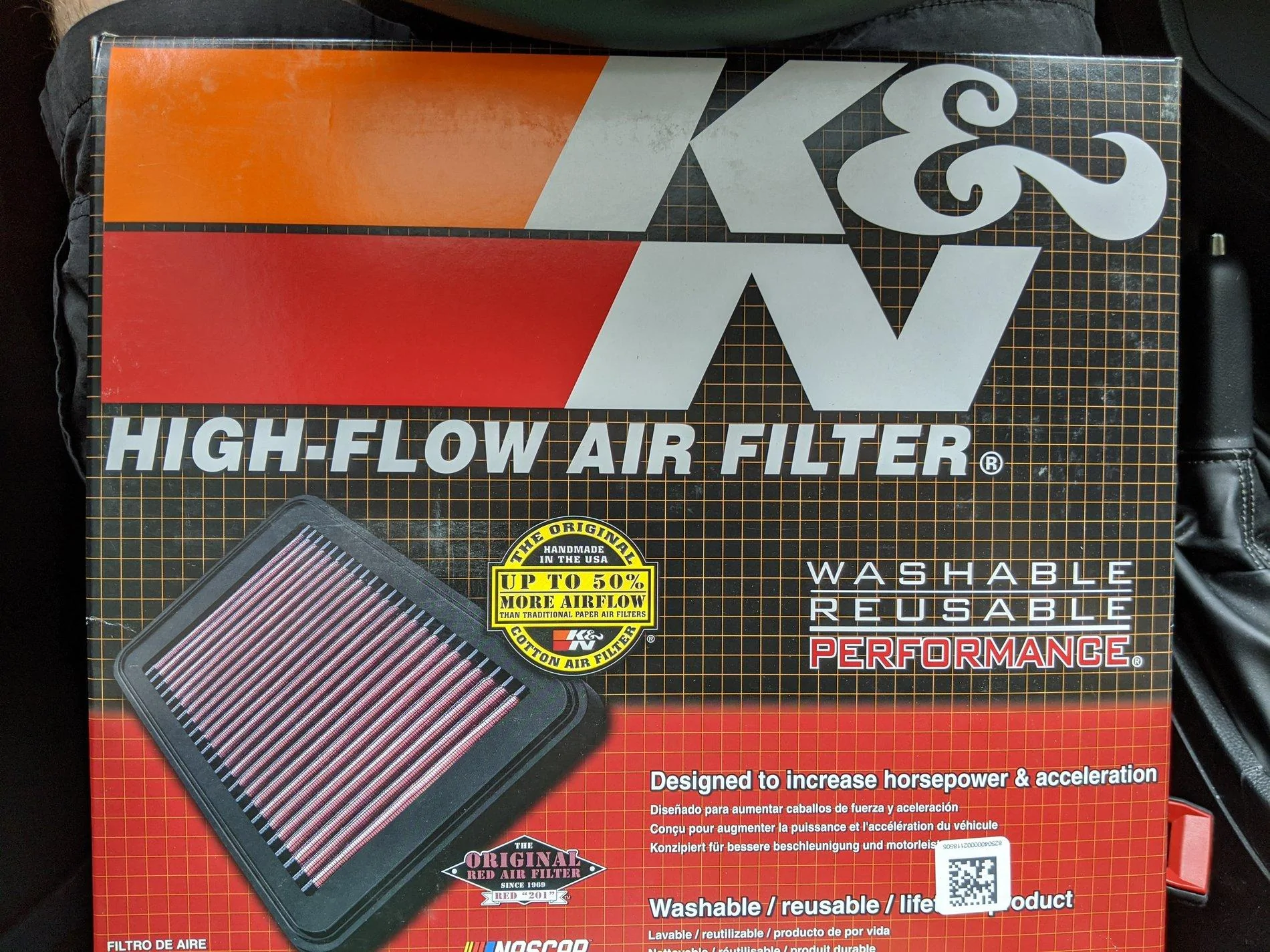

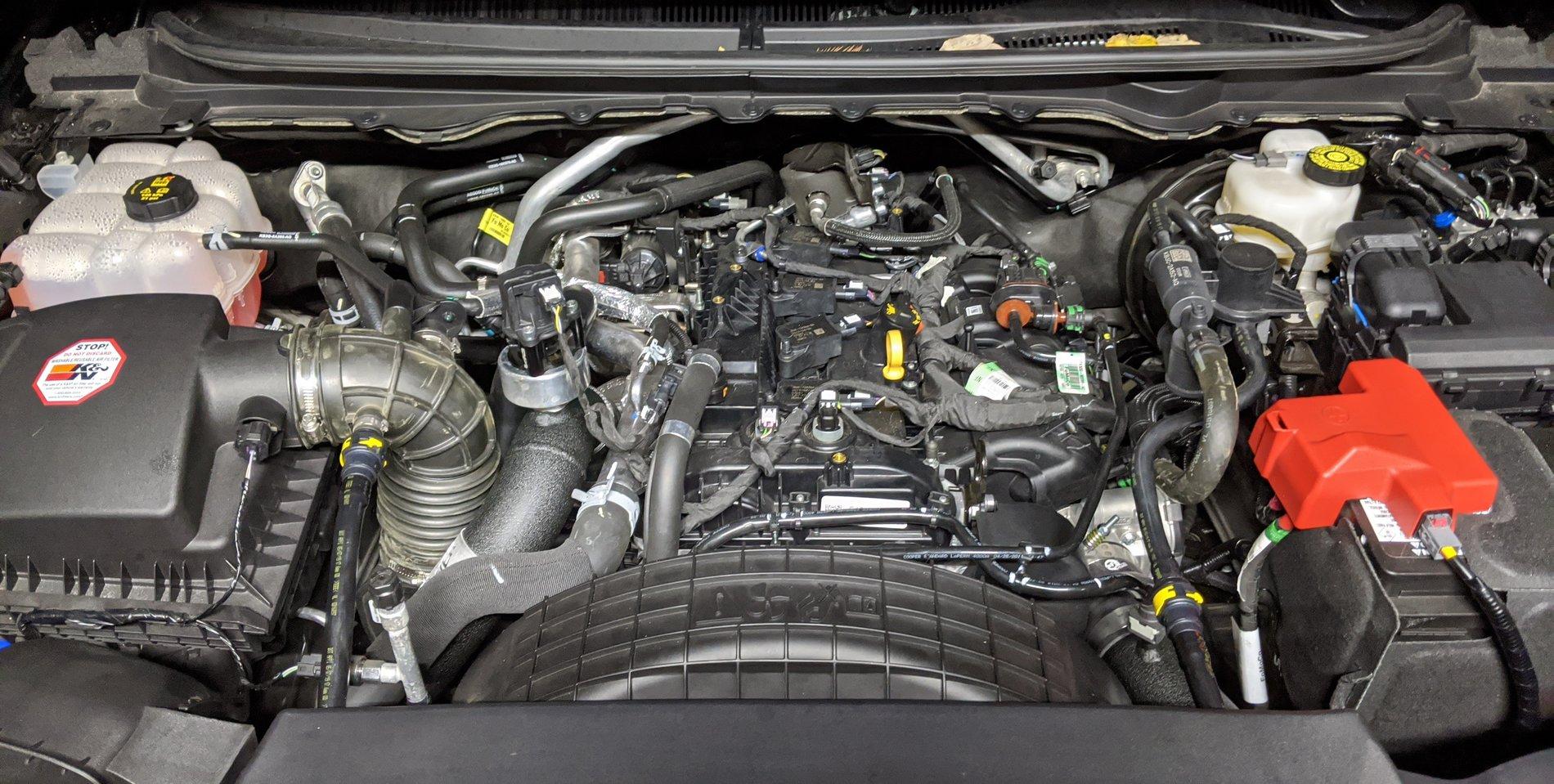

Goodbye stock paper filter.
Hello K&N!
Parts are starting to arrive! :rockon:

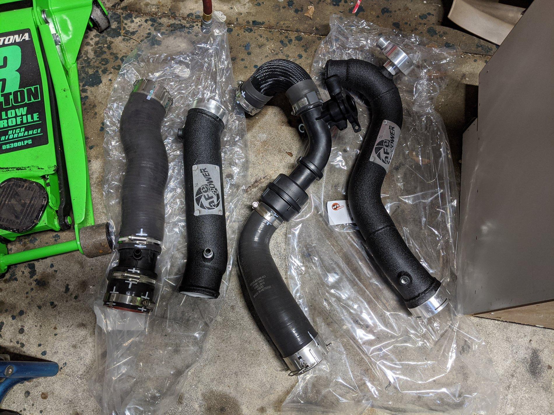

Muahahaha!!!!
I know what I'm doing this weekend! :rockon::like:
It's about to go down! I'll keep everyone posted and take a lot of pictures to hopefully make a write-up for both the charge pipes and downpipe!
Wish me luck and as few bloody knuckles and streams of profanity as possible :crackup:

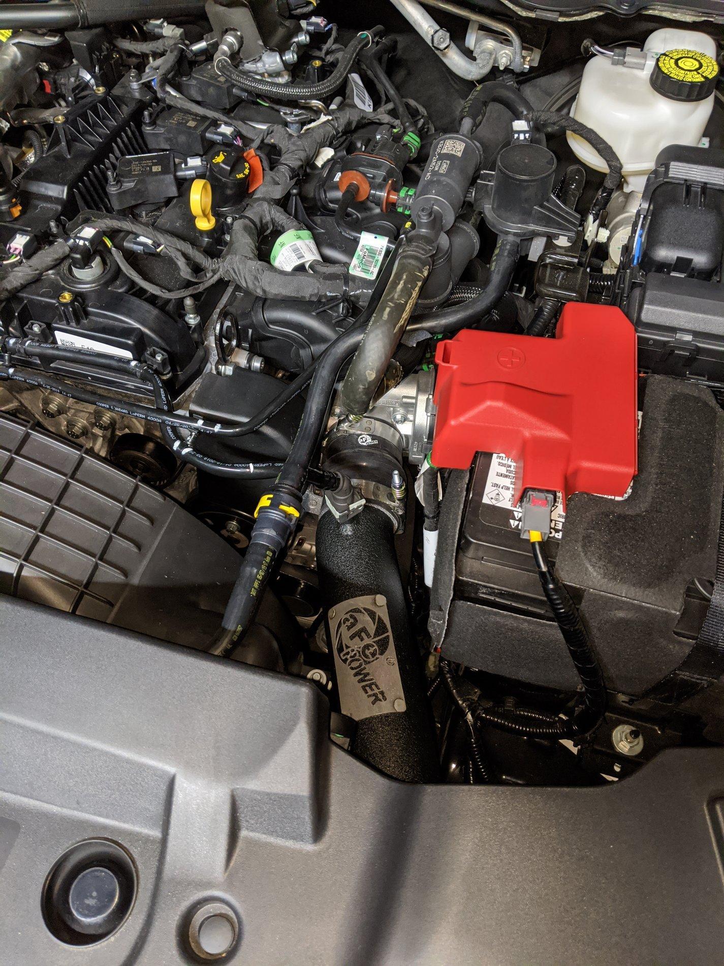

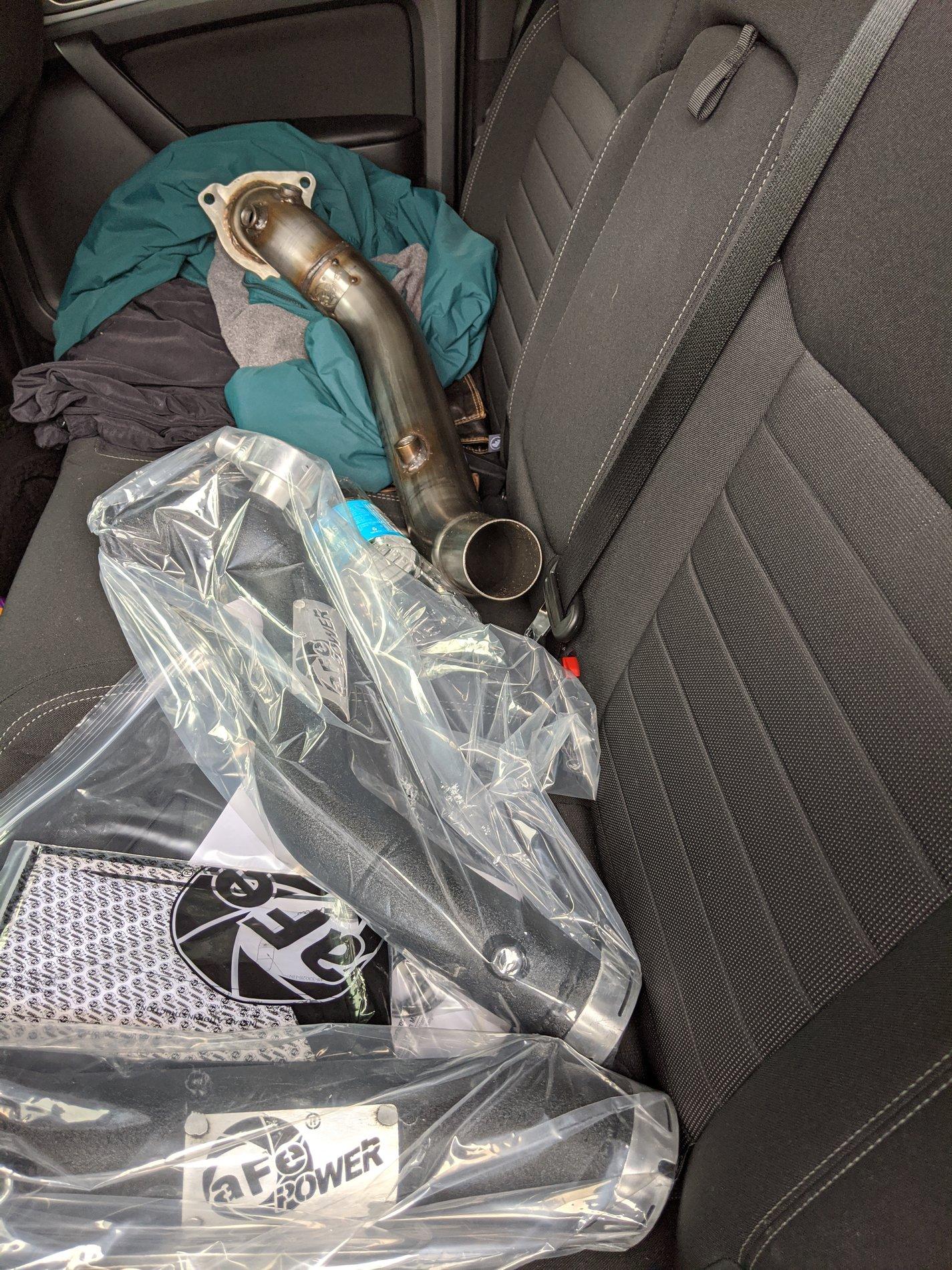

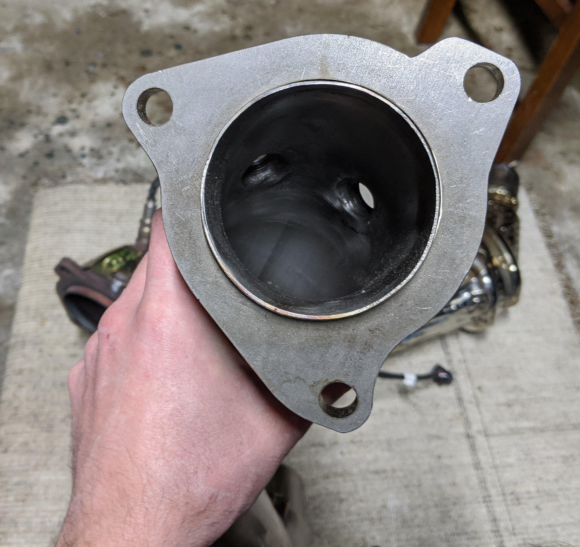

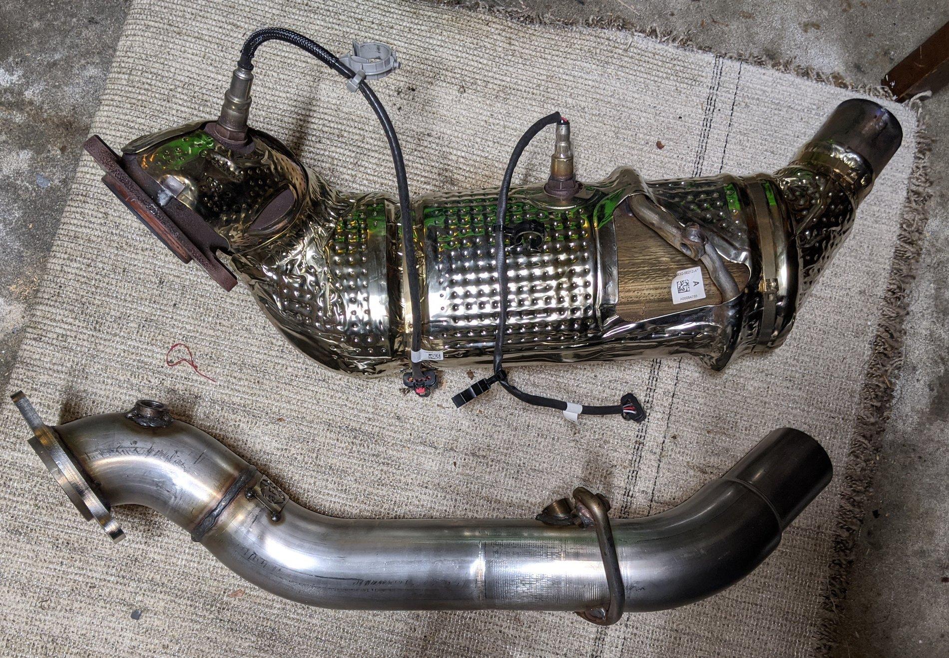

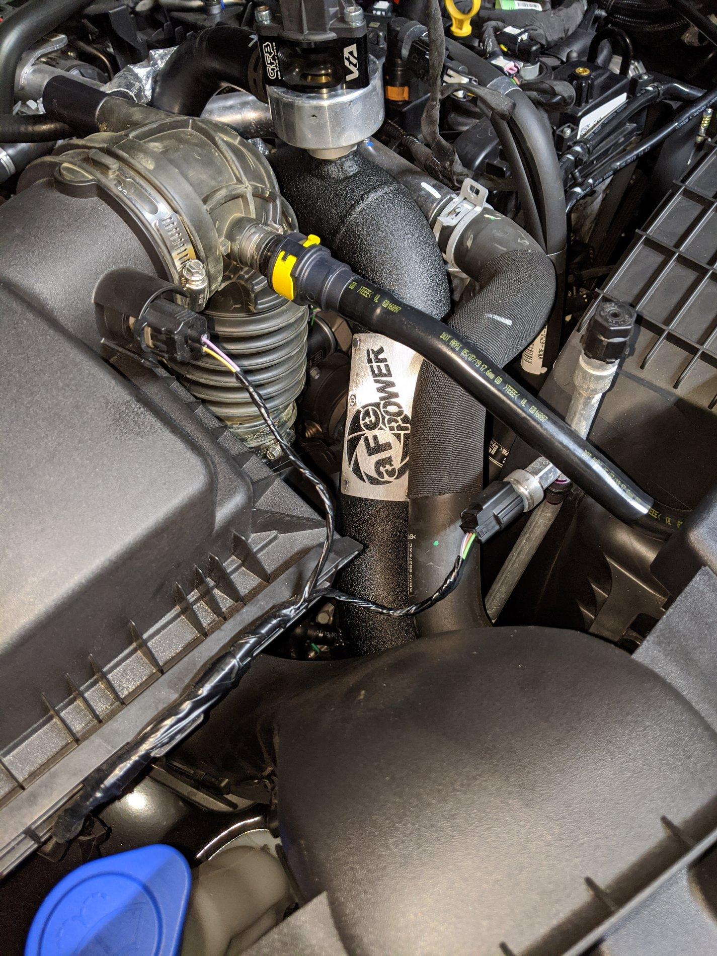

Parts are installed!!!! Installed the aFe BladeRunner intercooler pipes first and then installed the aFe catless downpipe. All i can say about the installs, the charge pipes weren't too bad it install. The cold side pipe was an absolute bitch to get in, it feels like it's about half an inch too long when they make them, which makes getting the silicone joiner to pop in place a royal pain in the ass!
As for the down pipe... The factory downpipe is an absolute nightmare to remove! For starters, it's absolutely massive in physical footprint, you'll see what I mean when you look at the pictures, it's also about 4 to 5 times heavier than the aFe downpipe and it's awkward as hell to fish out once you've got all the nuts and bolts holding it in place taken care of. I'm sure this install with vary greatly from truck to truck because of rust and nature siezr to What's more, the top left but is tucked in there pretty well, I used a combination of a 15mm ratcheting box end wrench and 4" extension and a 15mm deepwell in half inch drive to get all of the nuts off. I was only able to get my breaker bar on 2 of them so keep in mind how tight it is in and around the turbo flange. The only way I could see of getting to all of them was from under the truck. You have to snake your arms up, over, and around everything that's in the way and you'll hit muscle failure getting just those 3 damn nuts off haha.
Anyways, everything is installed looks/sounds amazing! First time starting it up, it shot exhaust out like a leaf blower haha. The amount of air in and exhaust out is insane now! I did some WOT runs and datalogging. Can't wait to see what Torrie over at Unleashed tuning can do with it now that it's breathing so much better!
As of right now I'm hitting peak boost of 23.44psi on my current tune so it'll be interesting to see how much I can get once I get the revised tune that will actually utilize the new parts! Stay tuned!
