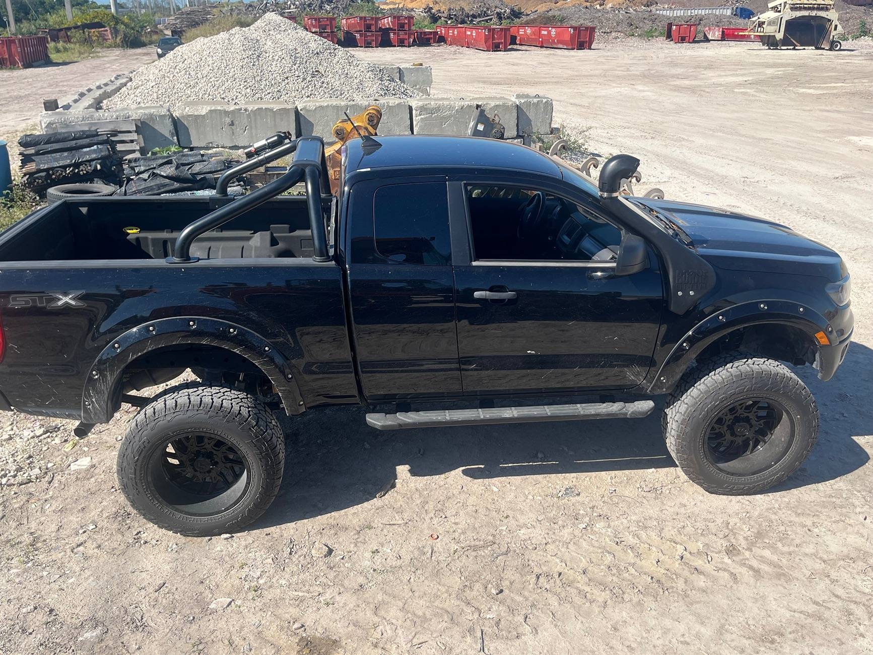

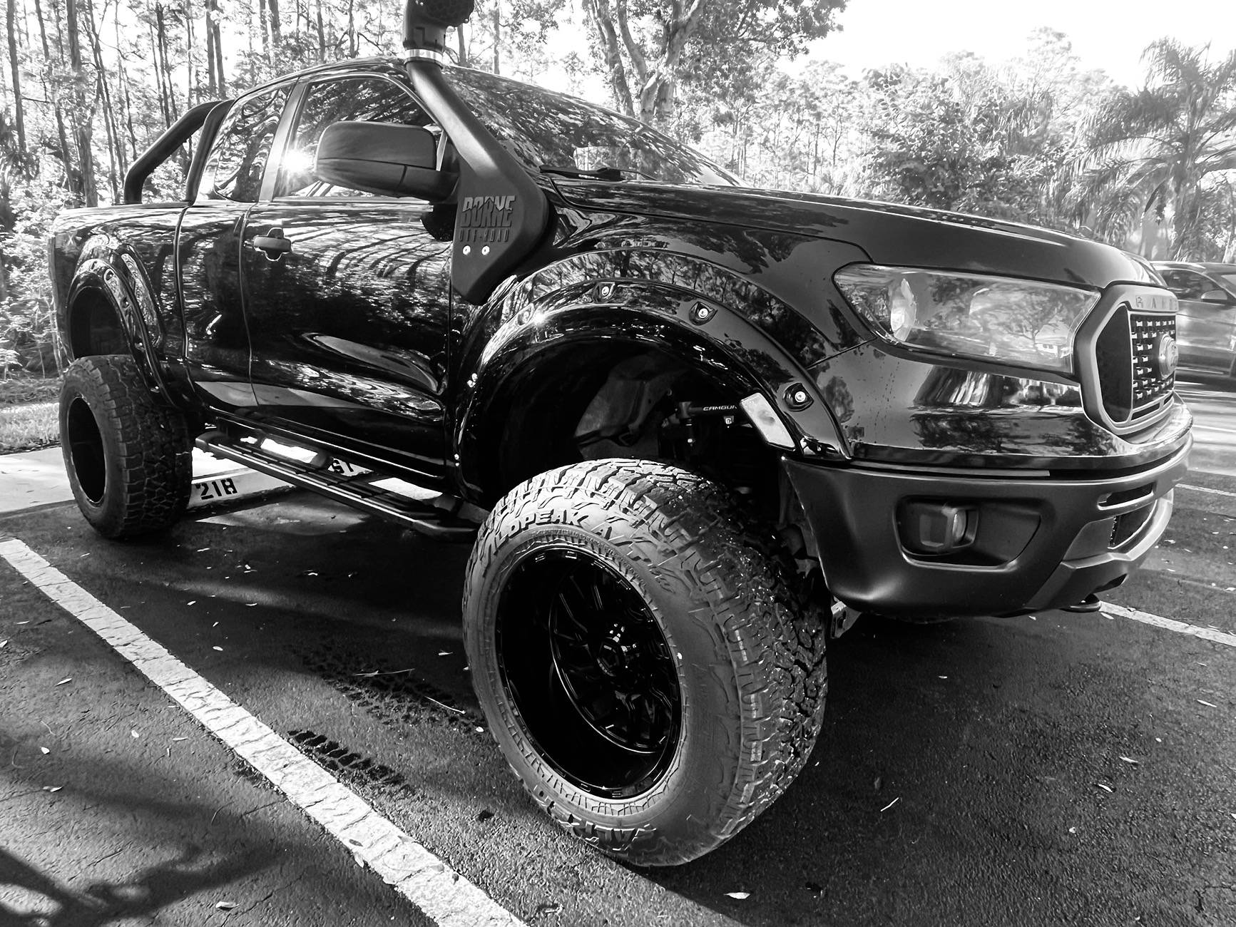

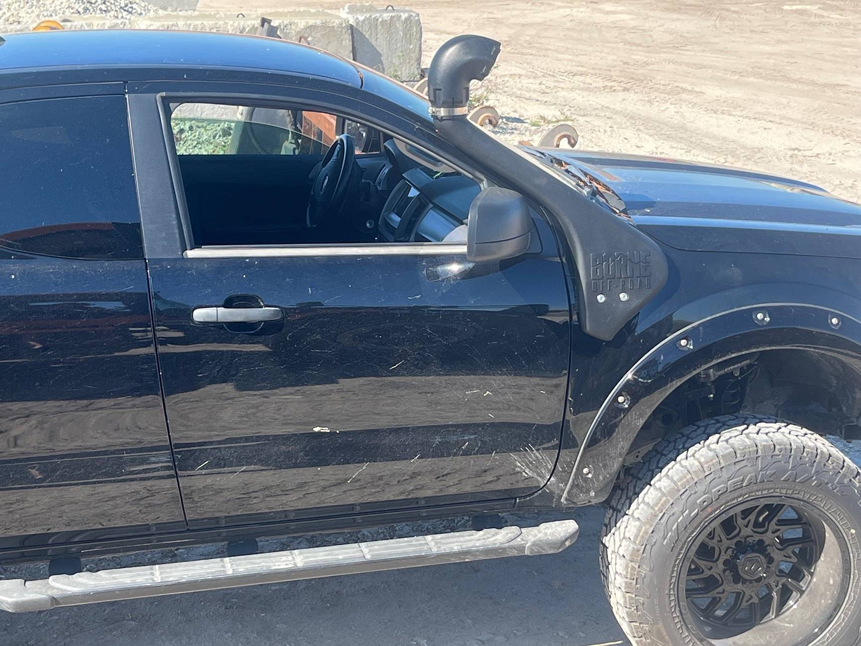

Hey guys and gals/ here are some updates on Black Beauty installed the Borne Snorkal with Mishimoto cold air intake it was a pain where the pills don’t reach! make sure you have a buddy help ya with it.

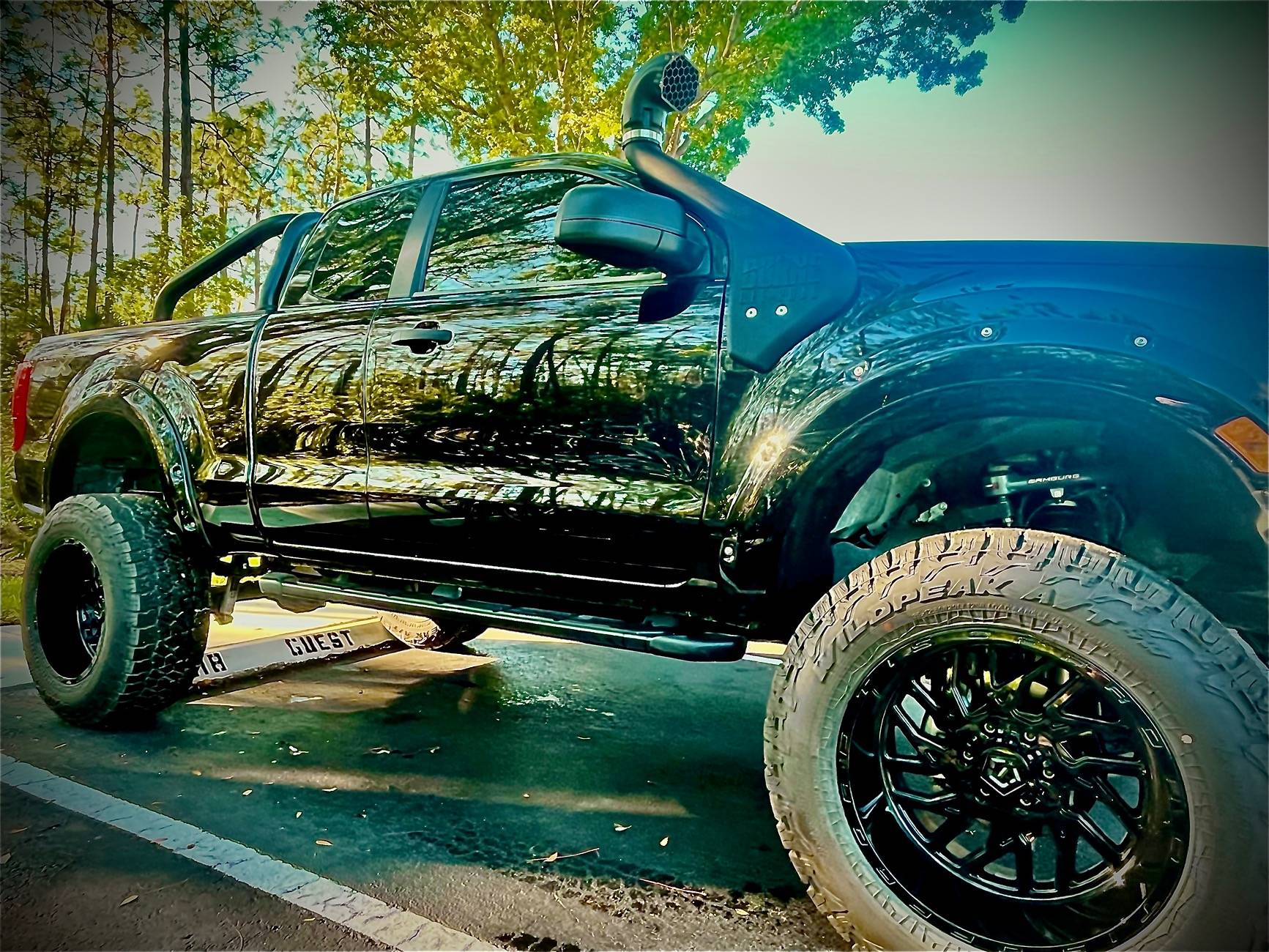

That is a sweet truck. I have two questions here. What brand are your fender flares and how did you get your wheels out? Spacers? Thanks

by the time the water line is the bottom of the snorkel your spark plug wells are already full, and your seats are soaked LOL bigger tires keep your pumpkins dry a lift is for tire clearance and anything over the rocker panels your sunk in a 2by
Thanks I appreciate that compliment so the wheels are
i Agree mine is just a pavement princess

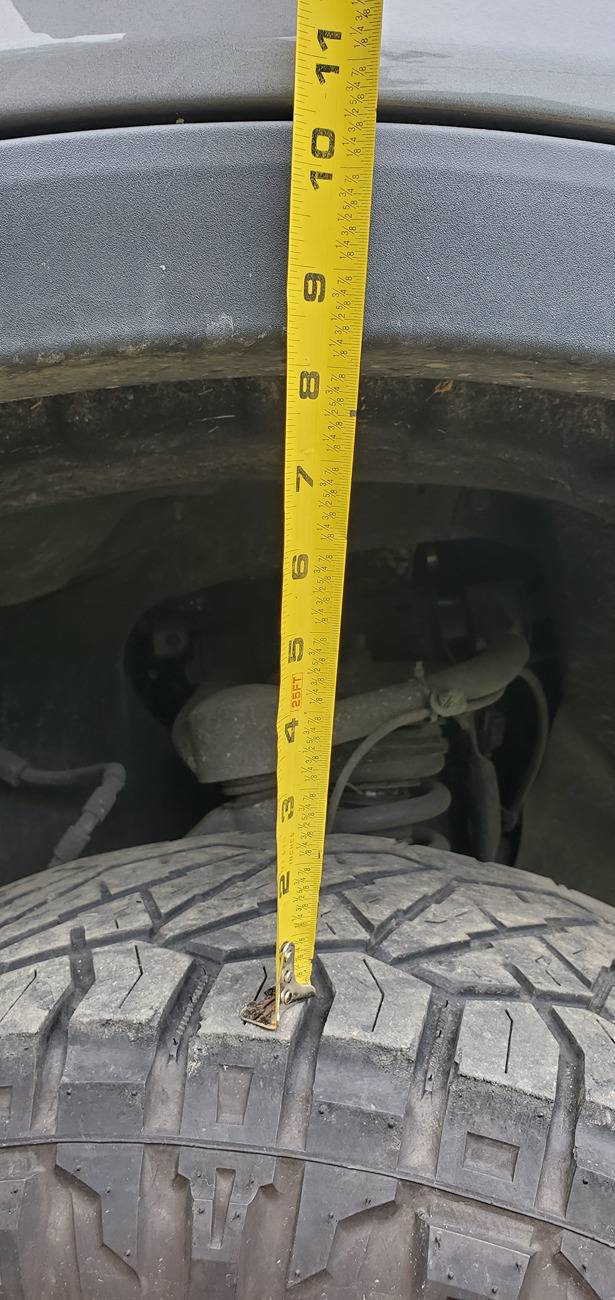

So the wheels are a deep dish rim -44 offset no wheel spacers 20 inch rim with 35 inch tires I’ll link what I did to the truck it’s on another forum in the ranger 5g.
thank you for the compliments I appreciate them

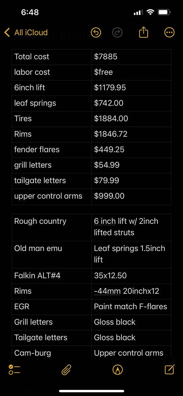

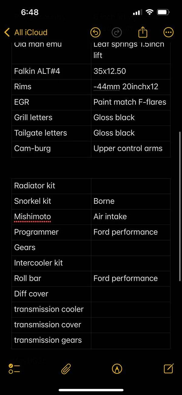

Obviously cost went up with more parts being added
