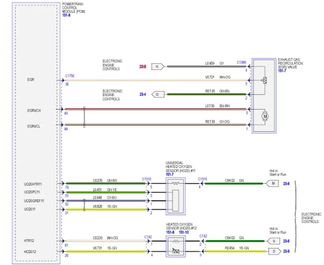

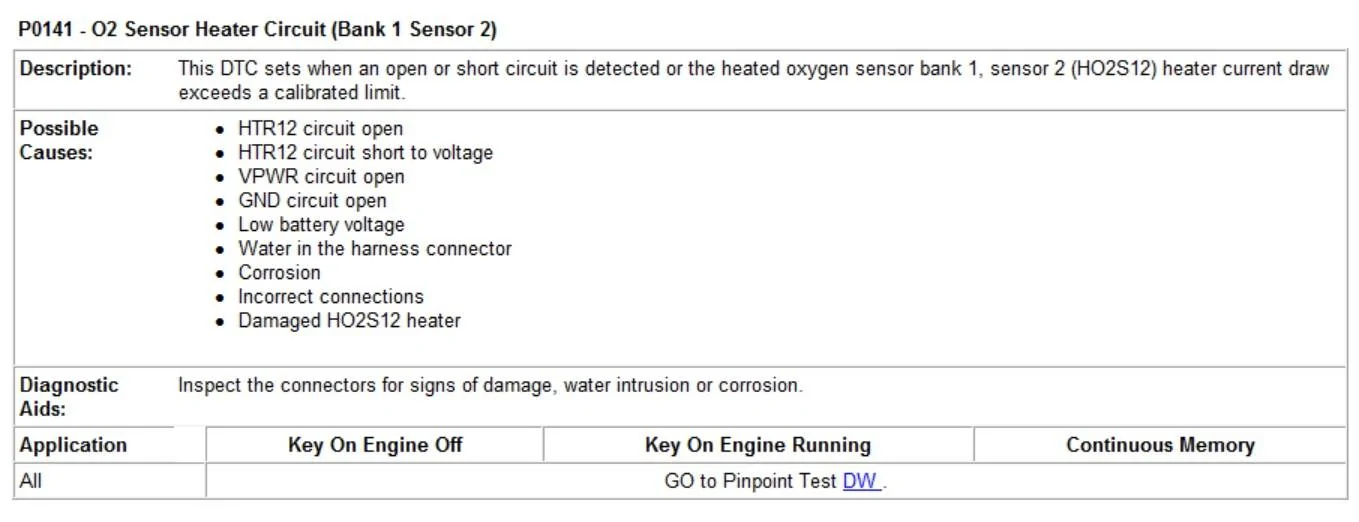

Here is some info from the shop manual. It would be the lower O2 sensor heater circuit on the diagram. I think the other DTC is related to the O2 sensor heater problem, so concentrate on the heater wiring and sensor heater might be open. I would check the heater with an ohmmeter to see if it is open.

The heater resistance should be less than 5 ohms at the O2 sensor. Voltage to the heater should be greater than 10.5 volts with the key on.

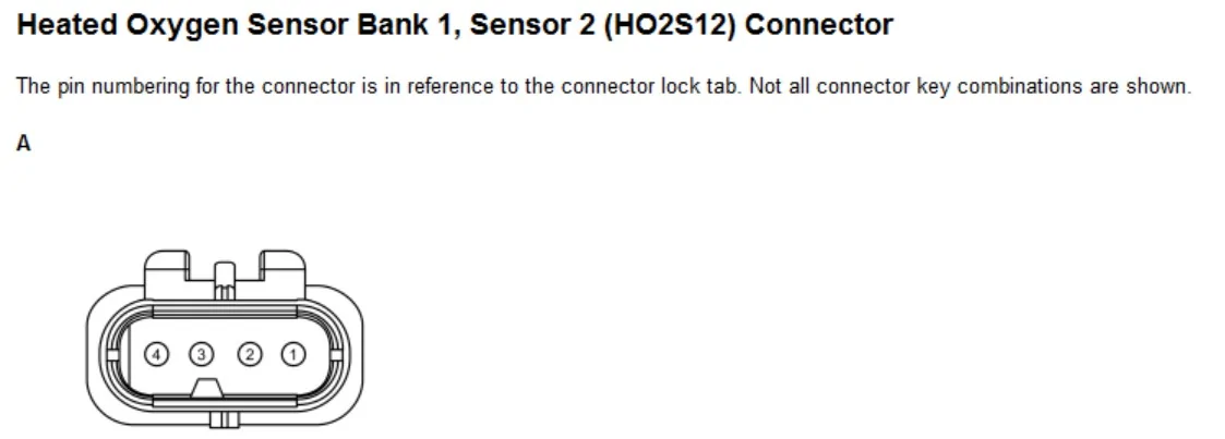

Quick and Simple checks, without having to pull the PCM Connector C175E.
Connector Disconnected: Downstream O2 - HO2S12
Key On - Pin #2 to Grd = Batt Voltage
Key Off:
Pin #1 to Grd
Pin #1 to Pin #2
Pin #1 to Pin #3
Pin #1 to Pin #4
All Measurments above should be >10,000 Ohms or 10 Kilo Ohms
O2 Sensor (Component side)
Pin #1 to Pin #2 - should read (2-30) Ohms
EDIT: I suspect the above is out of range, tripping the code
Pin #1 to Grd
Pin #1 to Pin #3
Both should read > than 10,000 ohms or 10 Kilo Ohms
