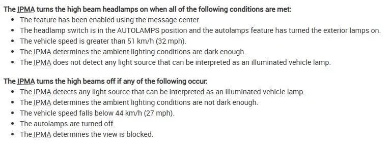

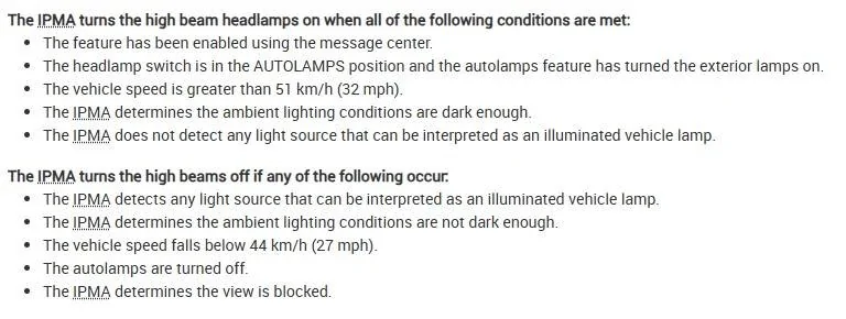

The Auto-High Beam Trigger (Off) comes from what the IPMA sees as an oncoming vehicle, sometimes reflections of road signs etc will false trigger them off.
Depending on where the LED lightbar is mounted. the IPMA may be seeing this as oncoming traffic.

I would wager you're throwing too much light, and its reflecting back enough that the truck thinks there is oncoming traffic. I've had this issue with just my standard Lariat projectors and Diode Dynamics fog lights.

For further reference: As to how your extra lighting, may be the trigger

There is (1) As-Built file that relates to sensitivity.
No idea exactly what does or (impacts) function
Factory (OE) is set to 00xx - so Level 1
I am not sure what (LA Sensitivity (LAS) is, I am thinking Lane Assist (Keeping)
so, if you scroll down to say adjust to Level 2 or Level 3 for the AHB it also changes the LAS to match the same level
So, it APPEARS the sensitivity covers both and no clear description on what this actually does.
Which is common in the breakdown of the As-Built files, now a Ford Engineer would have a full understanding as the (nomenclature) is lacking details
Since we know that the IPMA, is primary for Lane Keeping & Collision Avoidance we at least know its related to those systems, but some of them are most likely for other Ford models with other features.
One thing that confuses me sometimes is Ref: AHB Customer Enabled (ACE) = Off, I THINK this pertains to the (DEFAULT) setting as we have a configurable setting in the IPC to enable it.
As I said, some of the As-Built files are hard to break down, this is an example of it.
So, if one were to play with this and try:
Example: 24xx Level 2 or 44xx Level 3 (AHB), I THINK that when you hit the (Lane Keeping) button on the end of the stalk - The 1st default setting will be Level 2 or Level 3 and then you can adjust the sensitivity level in the menu (IDK, I do not use Lane Keeping) so would have to play with it.
or even if the sensitivity level of the AHB adjustment will actually do anything (noticeable) for Trigger (On) or Trigger (Off)
NOTE: I should point out that any changes made to this setting - MAY REQUIRE a IPMA Recalibration to be performed and will likely trigger a Front Camera Fault until it is completed.
I am not sure - just a hunch as this affects calibration (settings)
706-04-01**xxxxxxxxAHB Customer Enabled (ACE), AHB Sensitivity (AS), LA Customer Enabled (LACE), LA Sensitivity (LAS), LDW Haptic Intensity (LHI)

Hmm,
Brief operation of control.
Sorry, but define Driving Light (Meaning Fogs)? or Regular Headlights? Low Beam
If I understand this correctly and reading the post again.
You want your Fog Lights (Driving Lights) to be on with your High Beam Headlights?
If this is the case - the BCM needs some Forscan Help as the As-Built data needs changed to allow this.
Since this is a ROW Ranger, it MAY to be different than the US Version
This change is known as Bambi Mode
BCM
726-27-01
0100-0001-0057
Change: xxxx-xxx1-xxxx to xxxx-xxx0-xxxx
1 = Disabled - 0 = Enabled

Ok, so you have:
Factory Headlamps
Plus: Additional
1. LED Lightbar
2. Driving / Spot - Lights mounted to a (Nudge) bar
Both the LED Lightbar & Spotlights are tapped on the (High-Beam) circuit
All lights work normal - in all positions - (Auto-Headlamp) and Headlamp
Where I am lost - is the Auto (High-Beam) part.
This is a (IPC) configurable selection that can be (Turned On/Off)
This (Function) is provided by the IPMA (Camera) behind the rear-view mirror.
The IPMA - uses what it is seeing in front view of the camera to provide lighting parameters it sees and triggers a signal via HS-CAN2 data bus to the BCM.
It uses the (Conditions) parameters to either send the signal to (Turn On/Off) the High-Beams
So, everything on that circuit - including the LED Lightbar & Spotlights SHOULD trigger off, when the High-Beams are commanded off by the IPMA.
I am not fully understanding here, but I think what you are trying to convey is that:
When the (Auto-High Beam) is selected
Using - separate switched (on/off) for each light source.
and
1. Only the LED Lightbar is switched on - It functions normally
and
2. When the Spotlights are switched on (along with - the LED Lightbar) - the High Beams trigger off, thus killing the High-Beams and LED Lightbar and Spotlights.
3. If you only (switch) on the Spotlights and have the LED Lightbar (off) the Auto-High Beams trigger off and kill the Spotlights with it.
or is it
3. ONLY the Spotlights dropping power, and the LED Lightbar remains lit, when Auto High Beam triggers off.
If I am correct in understanding
Issue #2 & #3 is what you are experiencing
If this is TRUE, then the IPMA is seeing that lighting as (either - not dark enough) for Auto High Beams or it is interpreting the light source as a vehicle lighting source (Headlights) or (Taillights) from a vehicle in the forward view of the camera.
You may try adjusting the Spotlights (downwards) to get the IPMA to respond differently from that lighting source.
