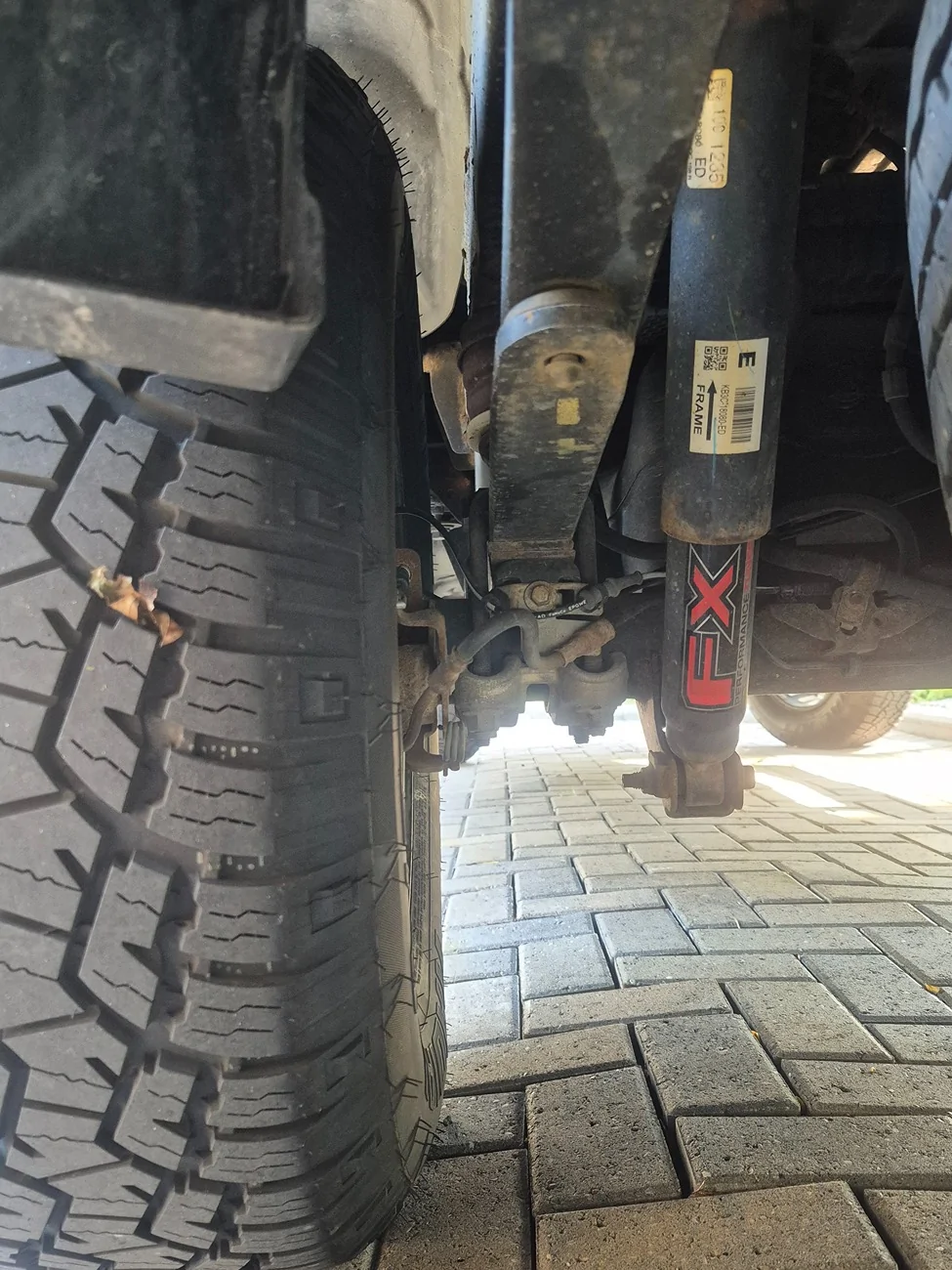

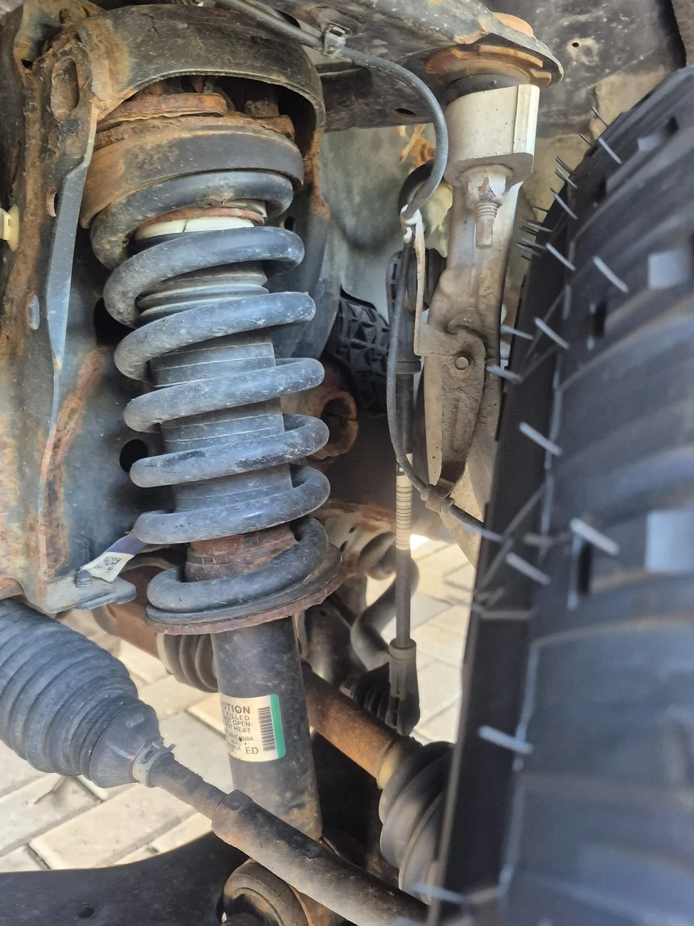

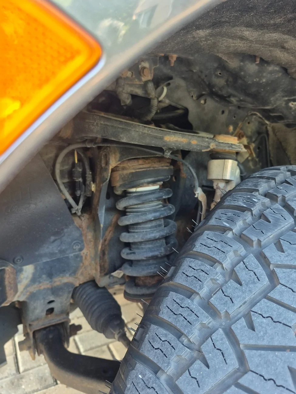

Hello, I have recently purchased this 2019 FX4 Off Road. I would like to know if this truck has stock ride height or has it been lifted? I apologize but this is my first Ford in many years and I am not familiar with the stock trucks. I believe it has the factory shocks on it, but I see other FX4 Ranger trucks on the road that do not have the same height in the front. Any help appreciated!

Looks like stock shocks with a lift plate on top the front strut?

Yeah stock coils under a lift plate that hasn't seen soap at any point after install.
Anything steel is coated in the cheapest paint money can buy. Just can't go the distance without corrosion. Nothing wrong with that setup and it being a 2019 factory FX suspension your pretty close to a set of something new... perfect opportunity to pull all that out.
You could get another lift spacer (I'd scuff the paint it come with and get some bed liner spray and put two coats on prior to install) and maybe some factory replacement Bilsteins would feel way better.

It hasn't been lifted, but someone did put stupid spacers in between the chassis and the front struts

are the spacers at the top of the strut not considered a lift?

By themselves no. It's what we all a level at best. If you want to lift a vehicle do you do it half asses or do you lift the rear as well?
