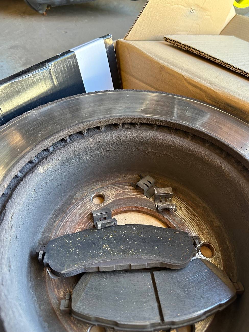

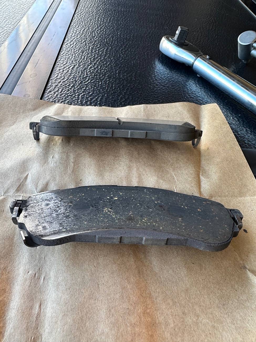

Well this was a surprise. The inner right pad was down to metal. They wore completely unevenly from the factory! There was also a TON of air in that caliper when I bled it. 70k miles original brakes. It ruined the rotor so I’m glad I had new ones coming anyway. The driver side was fine and wore evenly.
It was kind of an annoying brake job to do the rears. The ratchet cheap adapter I got to wind the calipers was not easy to use and was too soft of metal so it was basically consumed once both sides were done. Also the slide springs make the pads tricky to load in the caliper brackets.
Also PSA for Ranger spongey brakes — bleed them the old fashioned way!!! I used my old MightyVac and the pedal is absolutely firmer now. The FORScan routine doesn’t do anything by itself unless you actually bleed them. Used less than a small bottle of DOT4 and I’m good to go.
