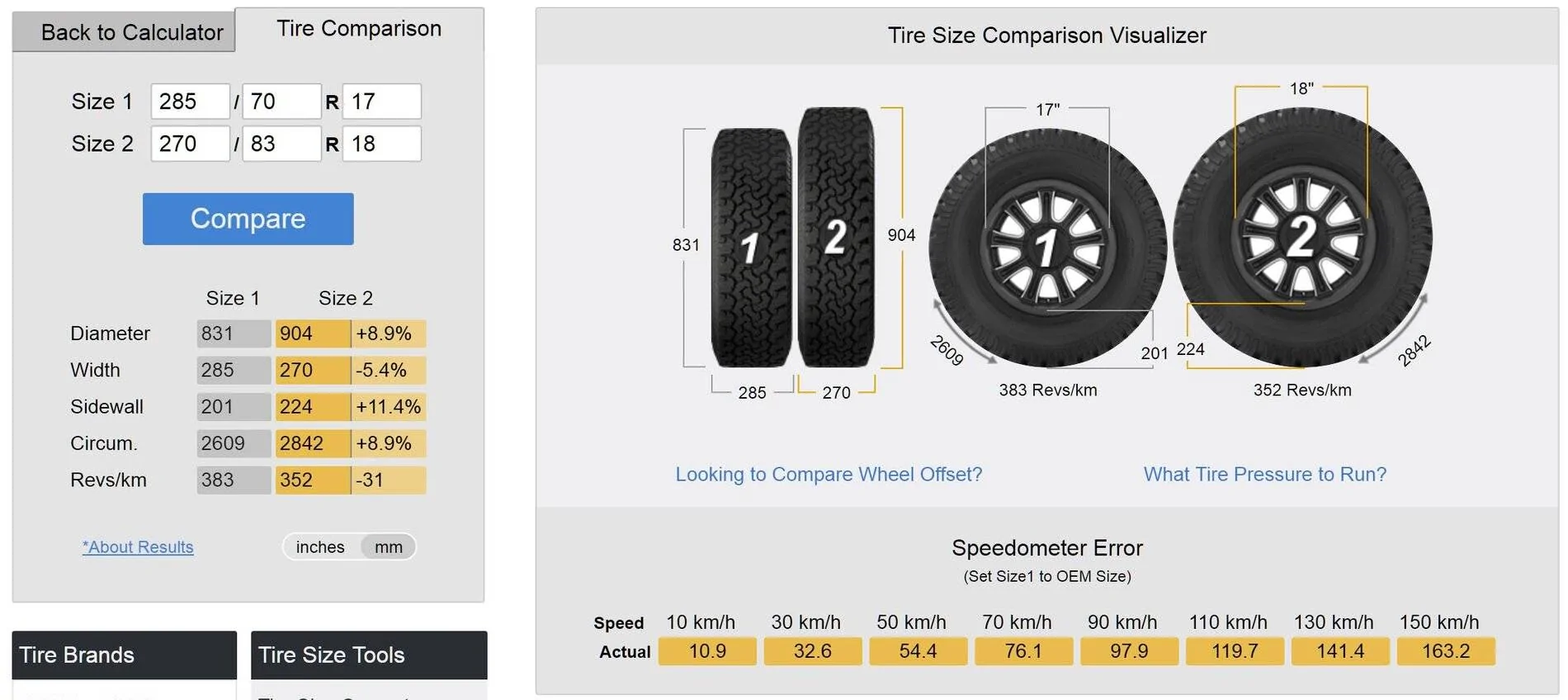

This thread and the last weekends pasture experiment got me thinking..

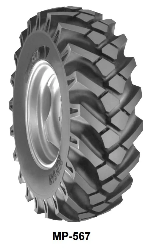

BKT makes somewhat agressive treads, and MP-567 is rated to 90km/h (55mph) which would be pretty ok in my truck as it's speed limited to 90km/h anyway.
It also comes in size of 10.5-18 (which equates near to 270/83R18) so it's bit thinner (15mm) and taller (70mm) than the stock 285/70R17 tires.
Has anyone tried this kind of swap? How's the road handling? mpg? Alternatives?

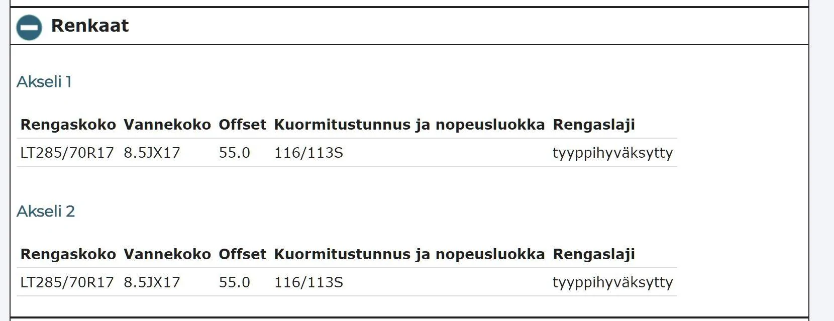

Ummm please help us out here and tell us wich model ranger has a 285/70-17 tires from the factory please!!!!

Mist be an overseas model(non US). Could have sworn that even the raptor was 265/70-17.
I think US doesn't have Ranger Raptor yet..
But anyway, here's the info on tires (in Finnish).

Good to know, and you are correct. Here in the states we do not have a Ranger Raptor at this time.
