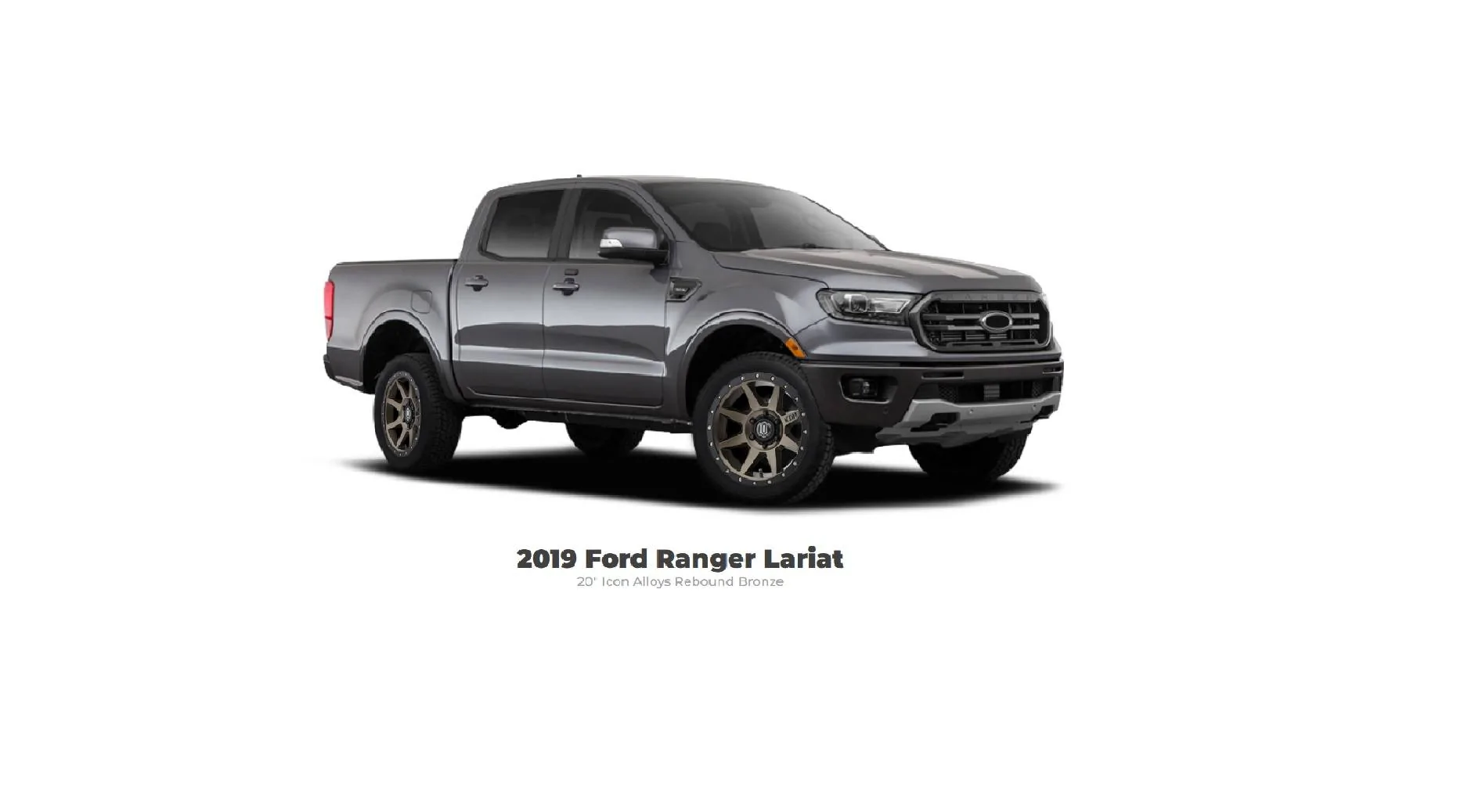

I really love this pic w/20's...
Trying to replicate this look on my truck.
